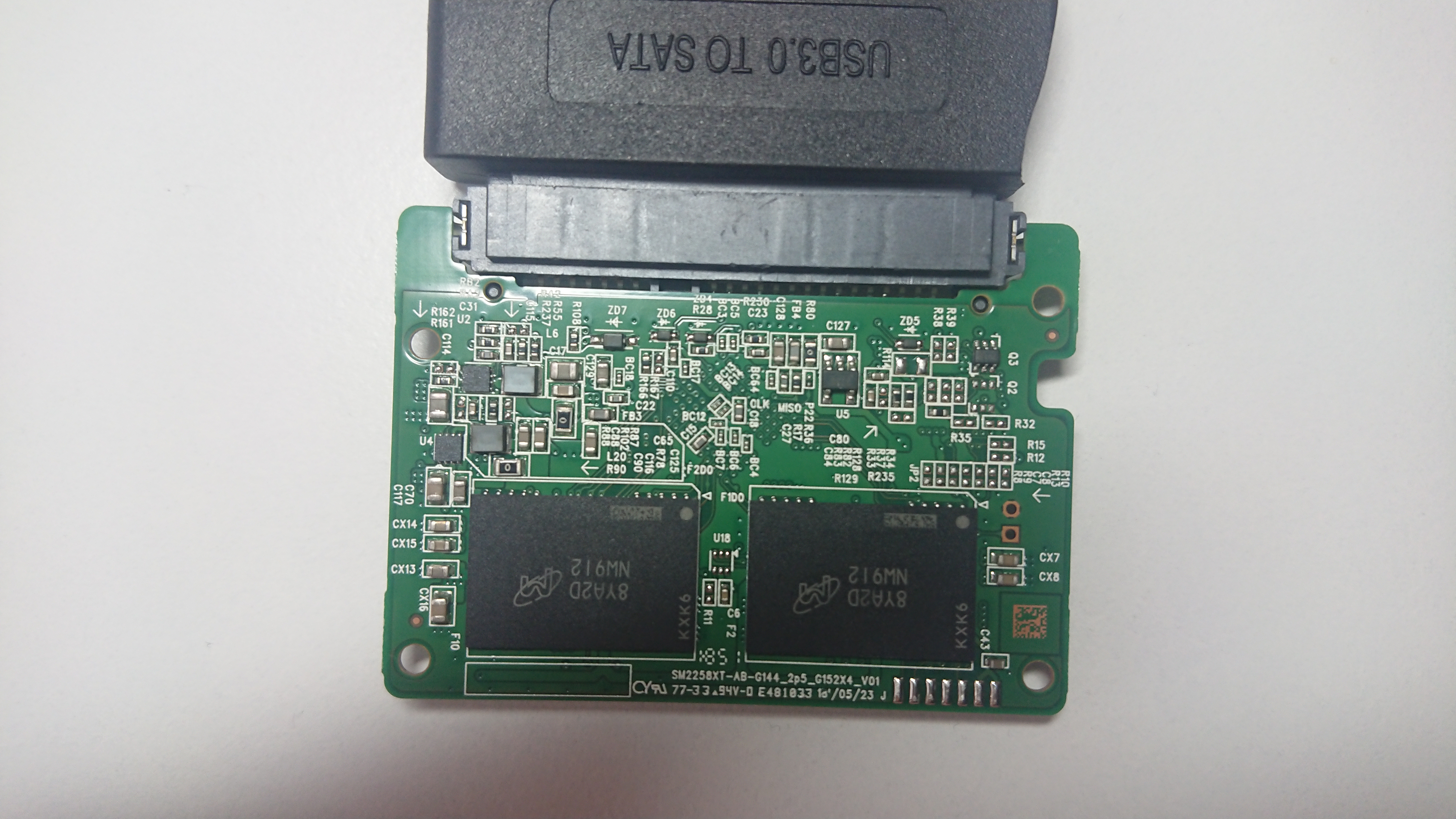

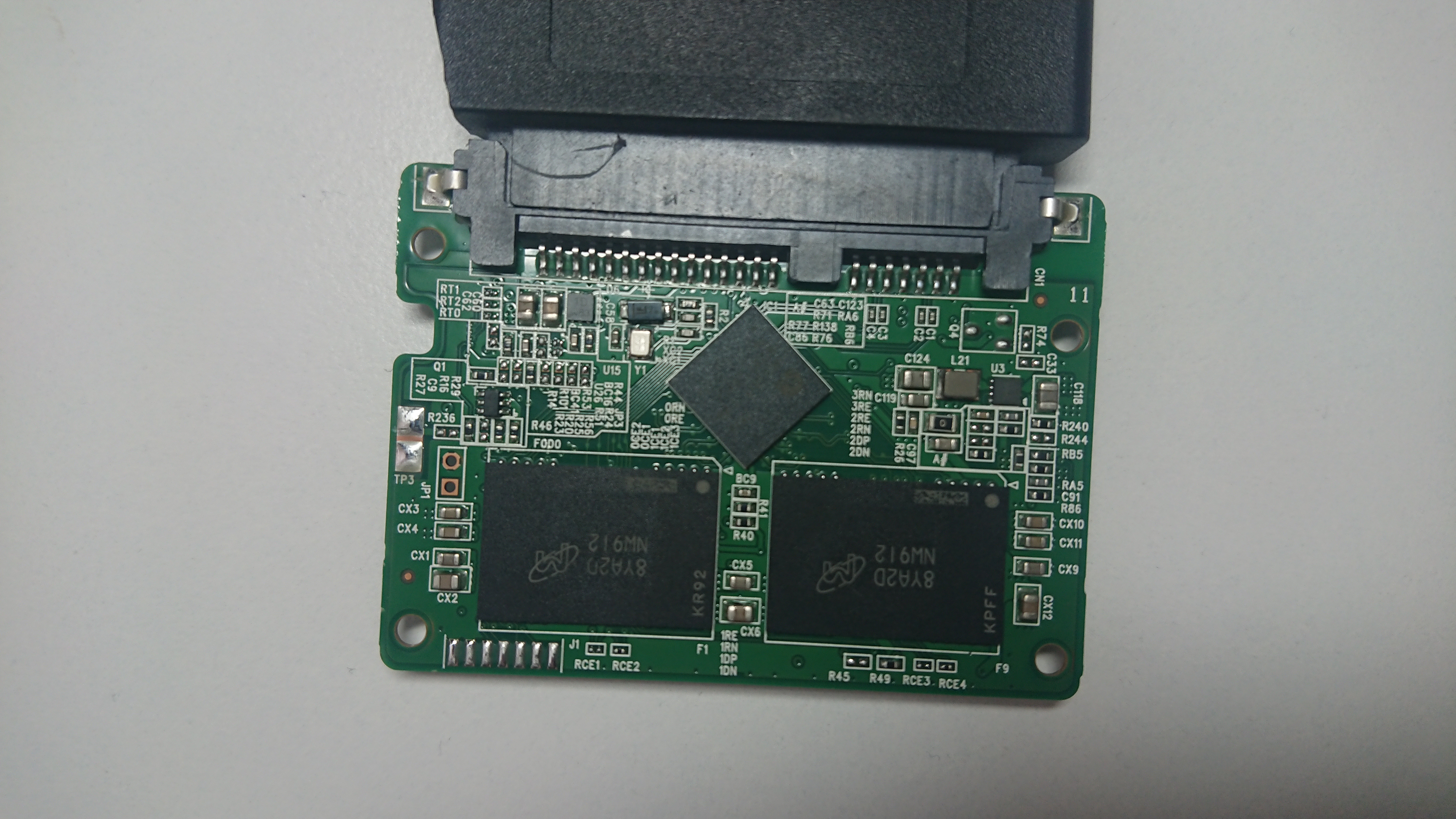

Hi everyone, I was hoping somebody might be able to advise me please?
I have a BX500 that was the Win 7 boot drive when a crash occurred. (This crash might have been related to my laptop's power management as I used to have crashes quite frequently when running on battery, always when charge fell to ~80%.) I had no choice but to hold the power button in to switch off the computer, it just wasn't responding at all, no mouse movement.
Now I can't get anything from the drive at all - BIOS sees nothing in two different bays but gives a drive error if you try to boot from a different drive while this is inserted. Same in a different laptop in AHCI and legacy modes, same in an external caddy and a SATA-USB adaptor. Nothing shows or changes at all in Win 7 diskmgmt or BIOS no matter how I connect it. I've tried power-cycling and still nothing. Is there anything I might be doing wrong in a power-cycle (e.g. the first time I tried, I didn't realise I had to keep data lines open, maybe the time has to be precise, maybe new drives need a longer cycle, etc)
Inside, I see no evidence of damage. My next guess is to bake it? I have a temperature probe that I can use in the oven, but I'm worried that when heated, if the drive is resting on the ICs (as I have to remove the plastic case), the ICs might slide when the solder melts and beak good connections? Is baking the best step to take next? I can check some component resistances etc if guided.
There's:
one bare-copper/drilled-hole jumper (JP1)
    A tiny pair of solder-bumps (JP2) that are in line with a bunch of resistors and capacitors
    A row of 7 solder-bumps (J1) on both faces of the board and appear as if some MIGHT be wired directly to one of the data chip's legs. These look designed to slide a 7-pin connector on and off
    Two large solder bumps (TP3) which appear on only one side, close to JP1
    I can't find TP1 or 2
...will any of these effect the way it communicates with a standard PC using a SATA-USB connector, or only some purpose-built interface?
I've tried to gather some of this information from questions asked already, but SSD diagnostics is not something I've done before and I have a deadline coming up, so I was hoping you experts might not mid me asking for help.
The board says SM2258XT-AB-G144_2P5_G152X4_V01
E481033
I've seen you guys might think the SM2258XT is a tricky job?
Thanks for any help!
File comment: One side
File comment: Other side

JP1 is probably the "ROM mode" jumper. If you short these two pads with tweezers while powering on the SDD, and then release them, your SSD should then be detected as a Silicon Motion device. This won't help you to recover your data, but it will at least confirm that the flash controller has basic sanity.

D6 appears to be a TVS diode. This is used for overvoltage protection. The SSD will be able to work without it, so there is no need to reconnect it. Can you measure its resistance? Was it shorted?
Try shorting JP1 in any case. That will tell us something useful.
You can also make some voltage measurements. Use the round pad at JP1 as your ground reference (black probe of multimeter) and then measure the voltages at the 3 zero-ohm resistors near U4 and U3.

Looking good!
Safe-mode worked, showing a 1GB uninitialised drive
R90 = 1.81V
R102? = 1.14
The one by U3 = 3.36V
D6 is odd though. I get 600ohm forwards 1.5k reverse
Thanks again

So there's power to it and the controller isn't dead just stupid.
That's right if you think about what a diode does and how it works.
