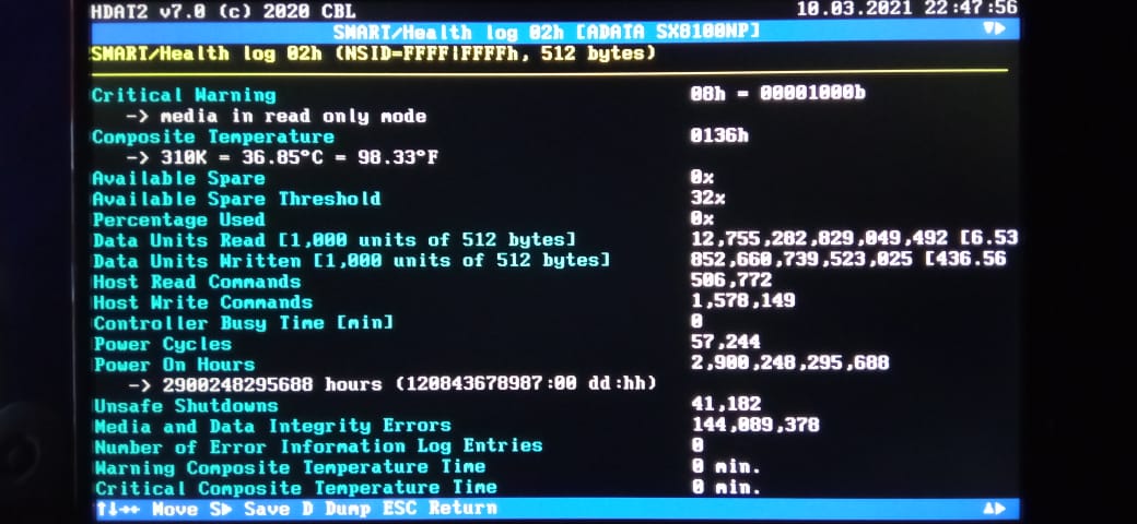

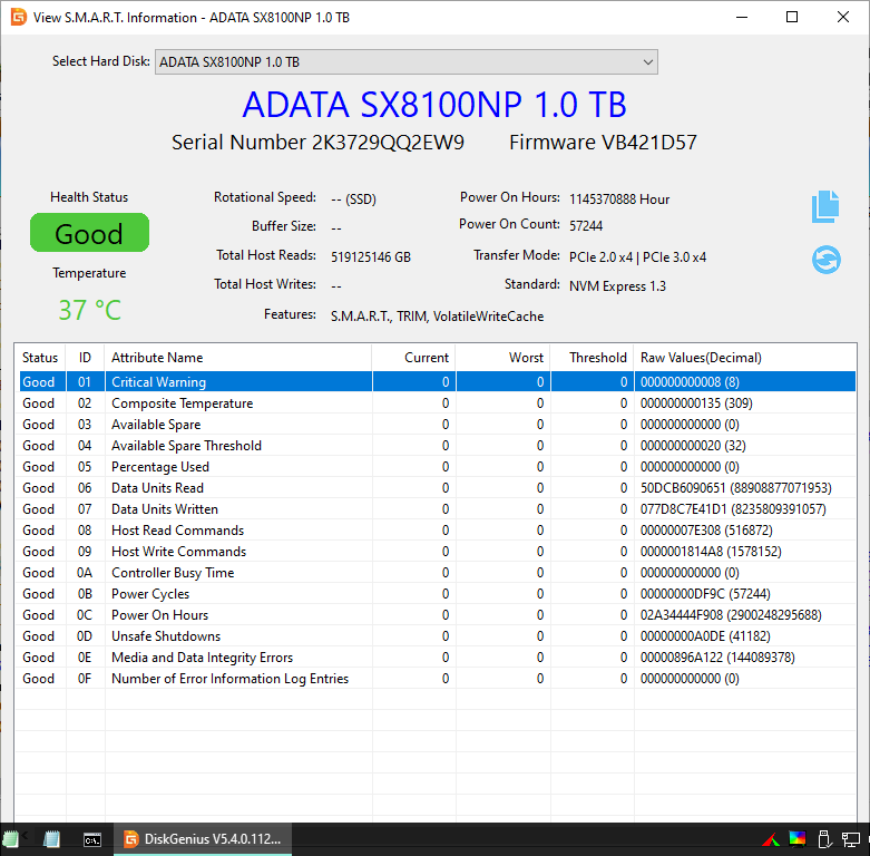

Here are the SMART results. I noticed now I can't get SMART info from Windows apps as usual. I had to use a WINPE environment to get it with DiskGenius and another one wiht HDAT2 using HirensBoot.
If there is any other information you want me to provide, let me know.

if you cloned it, and don't need any data, then RMA it. else bin it. would you ever trust this drive again, even if you somehow managed to force an OS on it?
