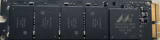

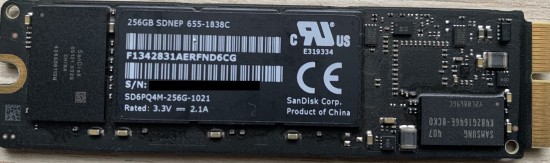

Hi to all! :mrgreen:
Is ssd 256gb.
not recognized and is not supported by acelabs. (pc express).
It seems to heat up a little more than normal when on.

Could try some of these.
https://forum.hddguru.com/viewtopic.php?f=1&t=40821
Probably needs PC3000 portable As Roman has said. What's getting hot?
Is processor Marvell
Thanks reply!
Нет ничего невозможного
 Post subject: Re: MARVELL 88ss9183-bnp2
PostPosted: March 18th, 2021, 14:17
Posts: 1323
Is it shorted or just getting generally hot ? I put a usb meter inline to get an idea of current drawn. You could try a heat sink / fan or freeze spray and something like hddsuperclone if DE is being a pain but I'm afraid I've had no luck with them at all. Hopefully some of our more seasoned veterans may share some secrets :?:
PostPosted: March 18th, 2021, 15:19
Posts: 17335
There are 3 switchmode regulators (ODH + ODH + SBN) and one LDO linear regulator (marking "3XT"). Measure the resistance between ground and the output of each regulator. Also measure the resistance between ground and the +3.3V input.
