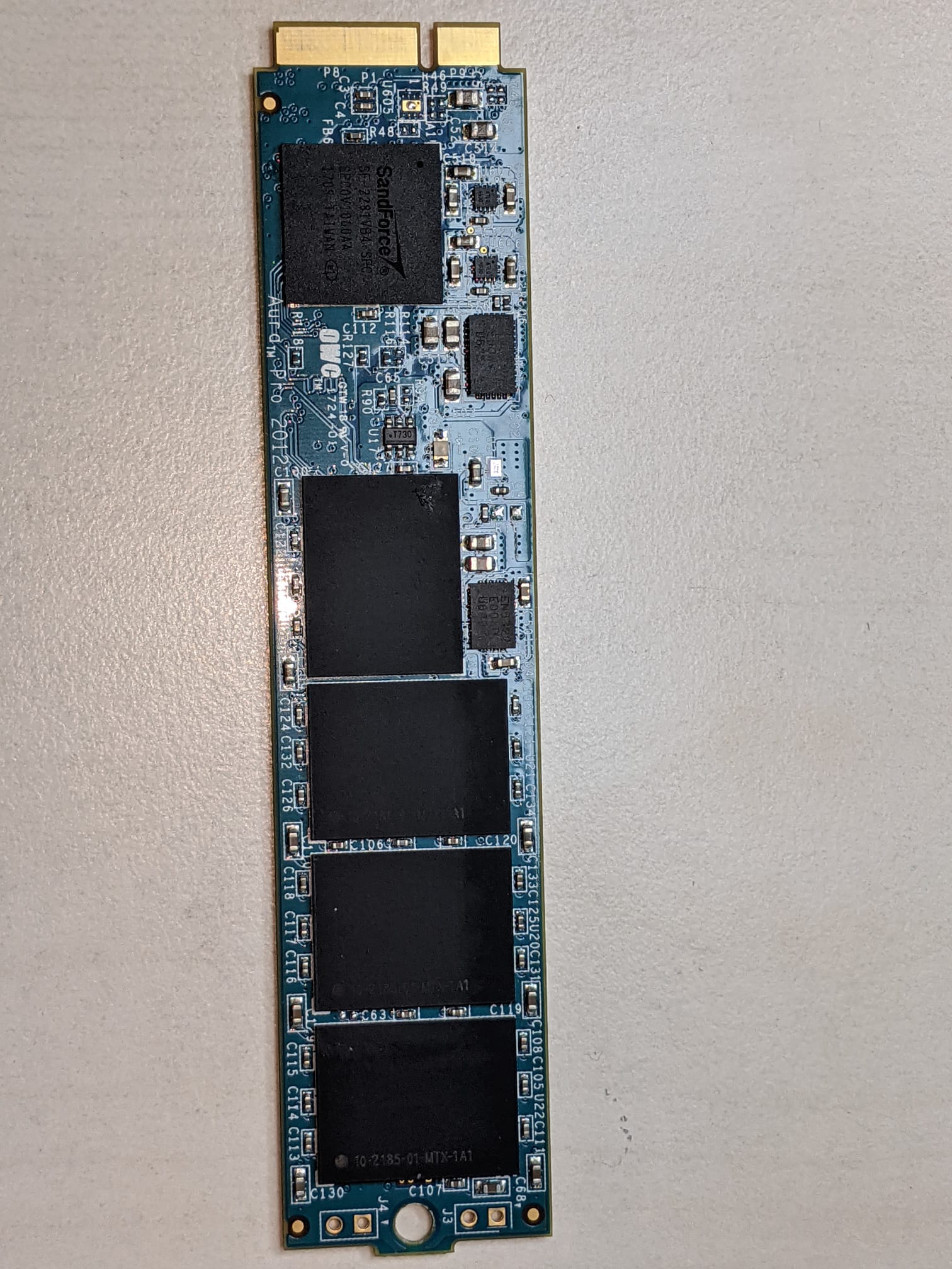

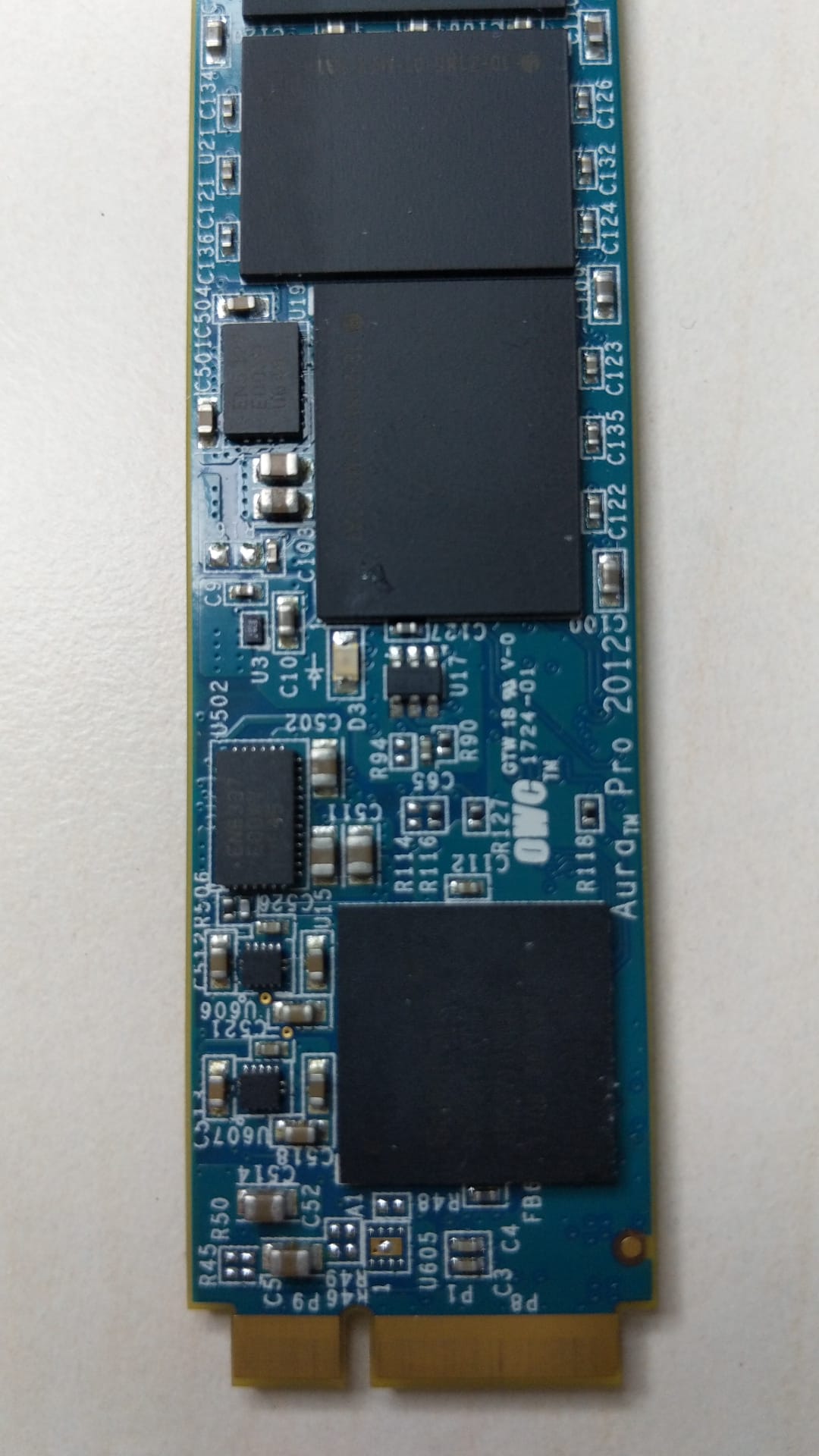

Hello
This SSD was in a MacBook pro 2012 A1466. One day, computer didn't boot. When powered using sata adpater, the LED on the SSD flash once quickly, then nothing. The SSD is not detected by anything.
It sounds to me like electronic problem. I've check on the forum, no post with this model. I'll keep measuring and see if I can find anything odd.

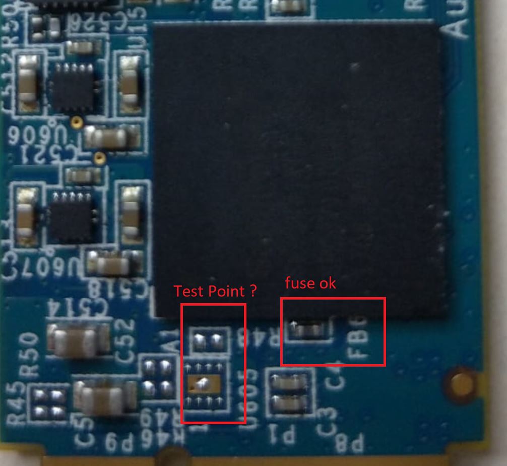

Update - I get drive READY with tweezer on J3 but report 0 capacity, I get ID and Sandforce is recognized

The only lab choices I am aware of who are able to handle failed Sandforce SSDs are Northwind (Greece) and ACE (Texas).
