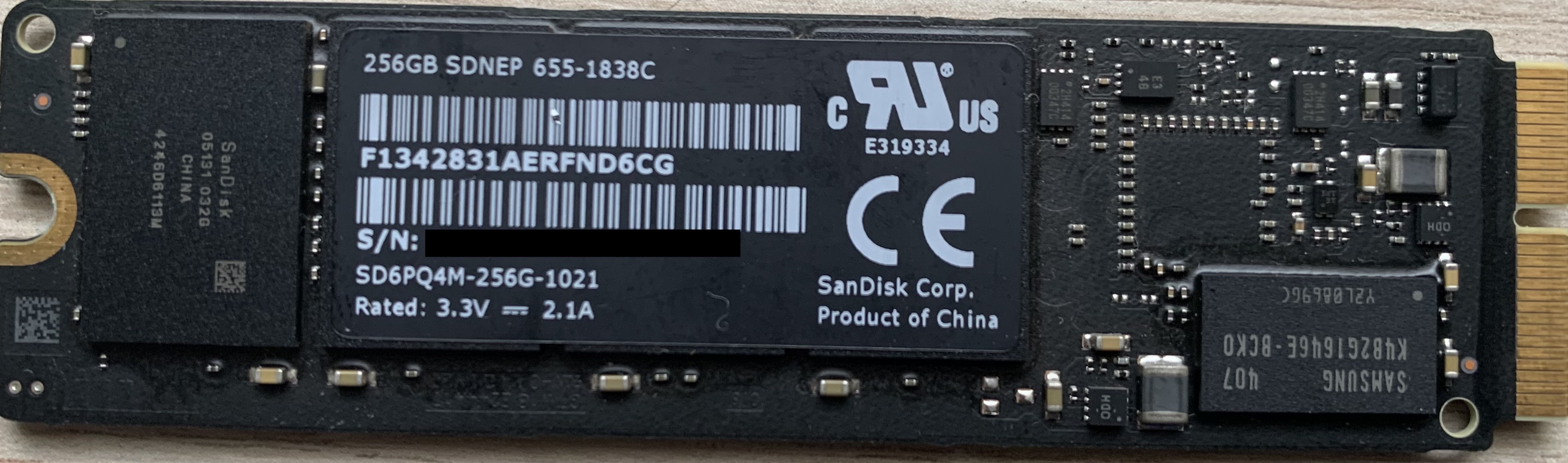

Hi to all! :mrgreen:

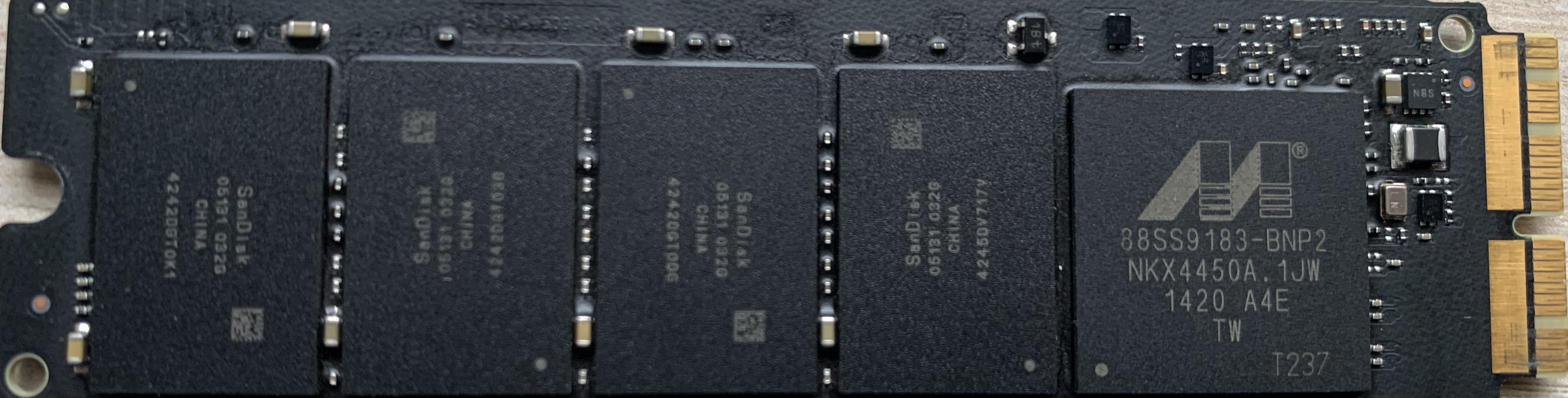

Is ssd 256gb.
not recognized and is not supported by acelabs. (pc express).
It seems to heat up a little more than normal when on.

Please infos for adapter usb??

Could try some of these.
https://forum.hddguru.com/viewtopic.php?f=1&t=40821
Probably needs PC3000 portable As Roman has said. What's getting hot?

Is processor Marvell

Is it shorted or just getting generally hot ? I put a usb meter inline to get an idea of current drawn. You could try a heat sink / fan or freeze spray and something like hddsuperclone if DE is being a pain but I'm afraid I've had no luck with them at all. Hopefully some of our more seasoned veterans may share some secrets :?:

There are 3 switchmode regulators (ODH + ODH + SBN) and one LDO linear regulator (marking "3XT"). Measure the resistance between ground and the output of each regulator. Also measure the resistance between ground and the +3.3V input.
