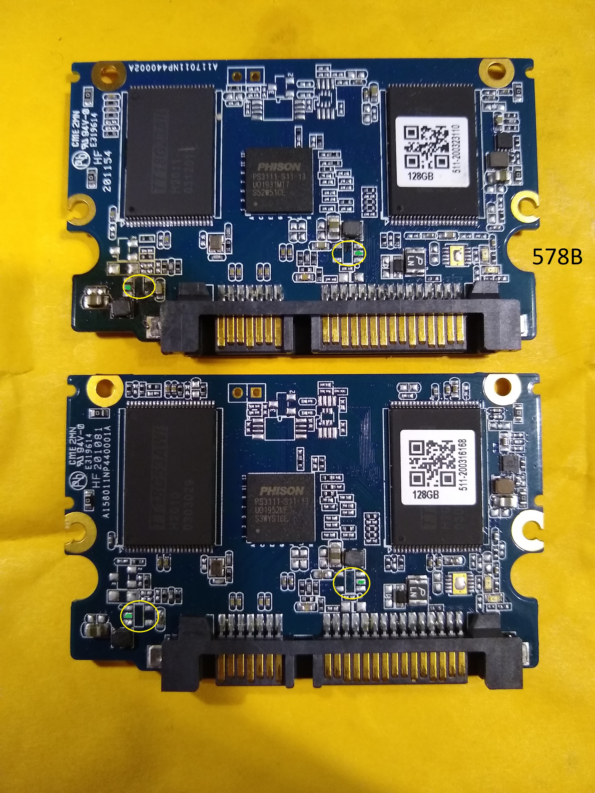

 Post subject: Need help IDing SOT23-5 chip on TEAMGROUP / Patriot 120gb
PostPosted: May 5th, 2021, 17:02
Joined: May 5th, 2021, 16:05
Greetings.
I am trying to get these working again. Data on these is not important. Hotswap or current damage.
One is a Patriot Burst 120gb and the other is a TEAMGROUP GX1 120gb.
I can't seem to find out what the SOT23-5 chips are. On one they said 578BR on the other 578BW. I am assuming DC-DC converter but no idea.
Middle pin on 3 leg side is ground.

http://www.gmt.com.tw/product/datasheet/EDS-5728B_5728C.pdf

I have another sdd. ADATA SU650. Similar SOT23-5 marked [3102] also shorted, possibly the same?

It has the wrong pin count, but ...
MT3102, M3Tek, 1.5A Continuous 2A Peak 5V Input 2.5MHz Synchronous Step-Down Converter, marking 3102, DFN_6L:
https://www.m3tekic.com/upload/2016/08/20160826154353.pdf
http://www.users.on.net/~fzabkar/Datasheets/DATAURLS.HTM
Datasheets for SSD and Flash Drive ICs:
http://www.hddoracle.com/viewtopic.php?f=100&t=1577

From this photo ...
https://goughlui.com/wp-content/uploads/2018/12/2018121421224653.jpg
... it would appear that the pinout for "3102" is ...
    1 = Pgood or Enable
    2 = Ground
    3 = Lx
    4 = Vin
    5 = Feedback
Since the 16-pin IC is made by M3Tek, I'm wondering whether "3102" is a special 5-pin version of the MT3102.
MT3123 / MT3123A / MT3123B, M3Tek, 5V 4A 1.25MHz 15uA Low Iq FAST-PWM Synchronous Step-Down Converter, marking 3123 / 3123A / 3123B, QFN3x3_16L:
http://www.lctek.net/uploadfile/cfile/upload/2016852311282.pdf
