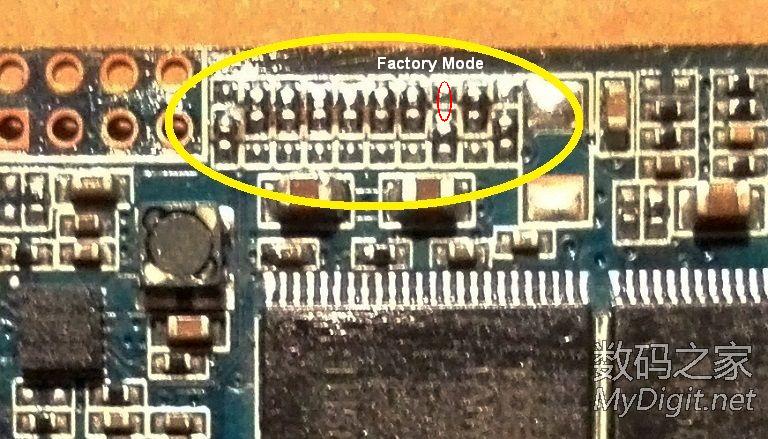

Does anyone has some info on to set a Kinston SSDNow200 with PCB 2024460-901.A00G into Safe Mode?
Here is a picture of the PCB.

short it.
you have jmf668 mptool?

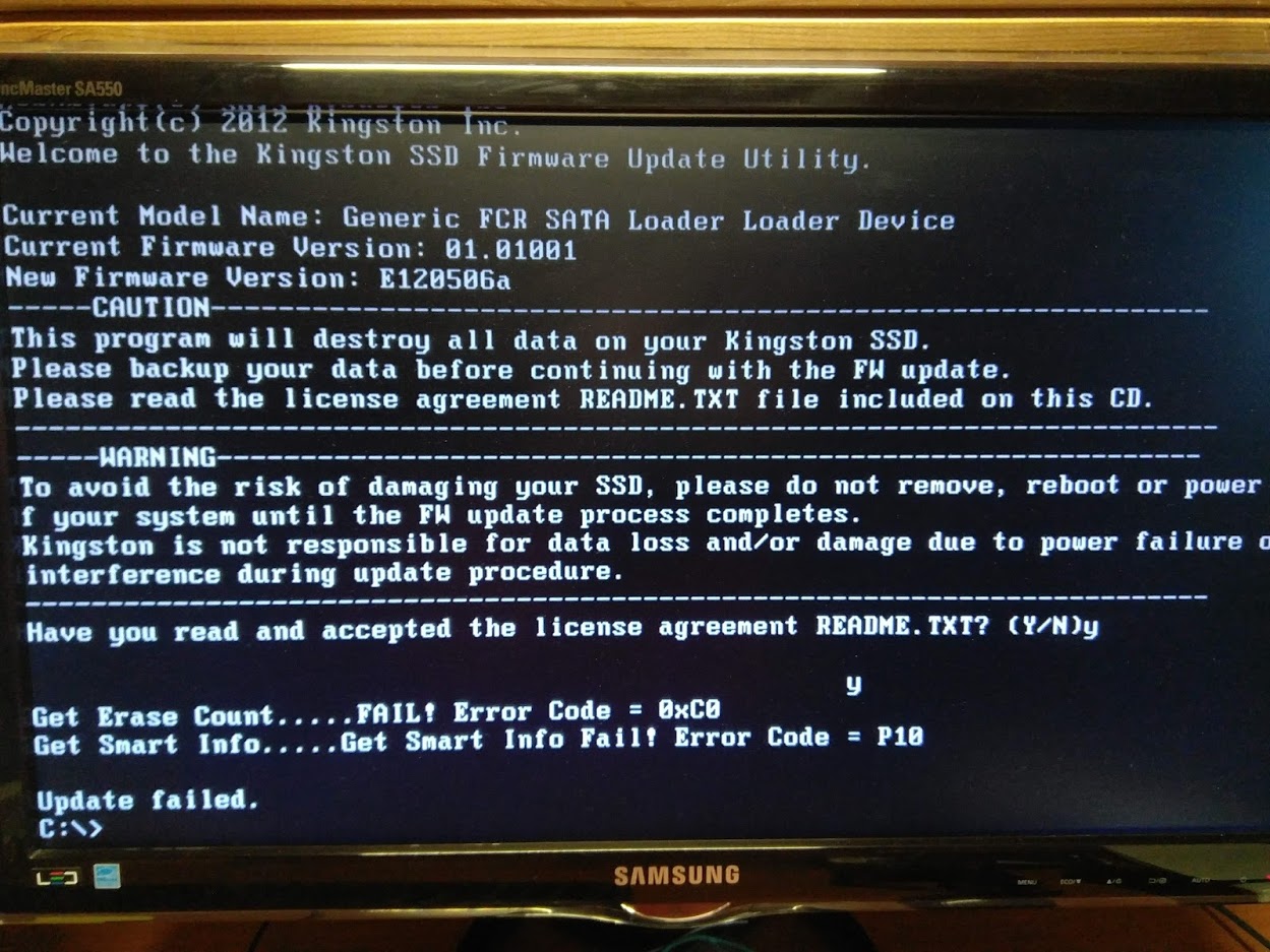

Hello VLO
Can you help me with same ssd. (Kingston sv200s37a/128g)
MB: 2024460-901.A00G
chip: Toshiba TC58NCF668GDT-BB
mem chips: Toshiba GJ7250 TH58NVG7D2HTA20
Now status name: Generic FCR SATA Loader Loader Device (0.0Gb)
Current firmware:01.01001
I try flash kingston update firmware E120506a https://www.kingston.com/us/support/technical/downloads?product=SV200S3&filename=SV200S3_64G_128G_e120506a , but have Error
Get Erase Count.....FAIL! Error Code = 0xC0
Get Smart Info.....Get Smart Info Fail! Error Code = P10

and this util not see ssd (but i not short pin in your picture)
I don't undestand when short it and move resistor or just short when connect power or short solder with a soldering iron
And i dont understand config JMicron 668 M.P. Tool A.2.0.13
