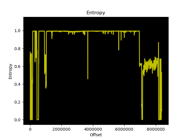

Hi all, I have a car stereo that I am trying to hack into. The stereo has a NAND flash chip (Winbond w25q128jvsiq) and a CPU (Allwinner_F1C200s). I extracted the contents of the flash chip into a .bin file and am now trying to view the files and directory stored on this chip but am having trouble doing so. I tried running binwalk and decompressing the files but can't seem to get anything recognizable. I uploaded the entropy graph along with .bin file in a google doc (https://drive.google.com/drive/folders/ ... sp=sharing). Does anyone have any suggestions?
I hope I've come to the right place. Any help would be greatly appreciated. :)
File comment: The entropy of the extracted contents.

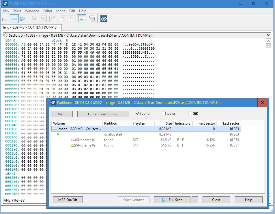

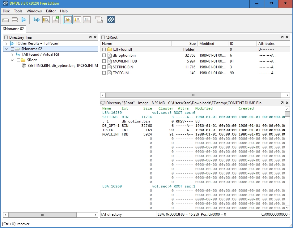

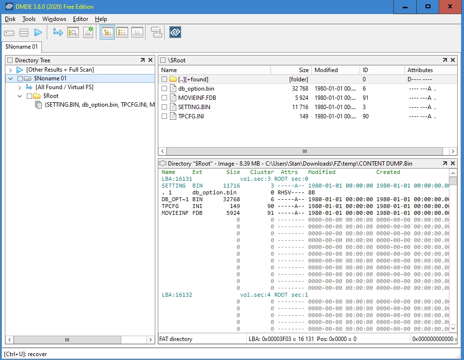

If you open your BIN as an image in DMDE, DMDE finds two small FAT16 partitions at the end.

The two FAT 16 partitions are identical and contain 4 files (attached).
