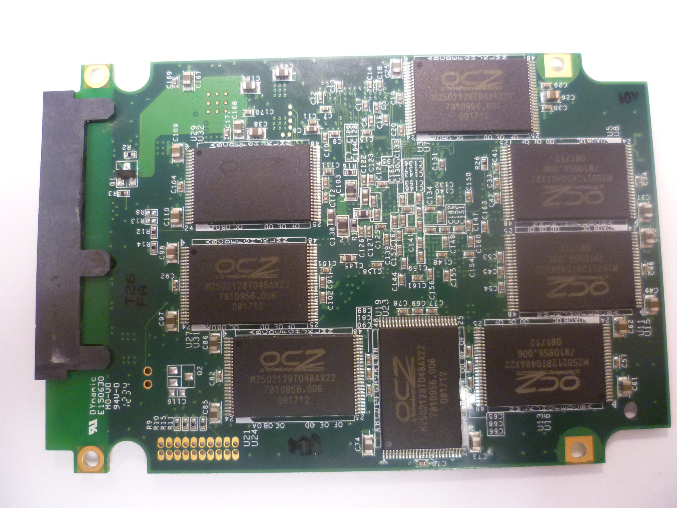

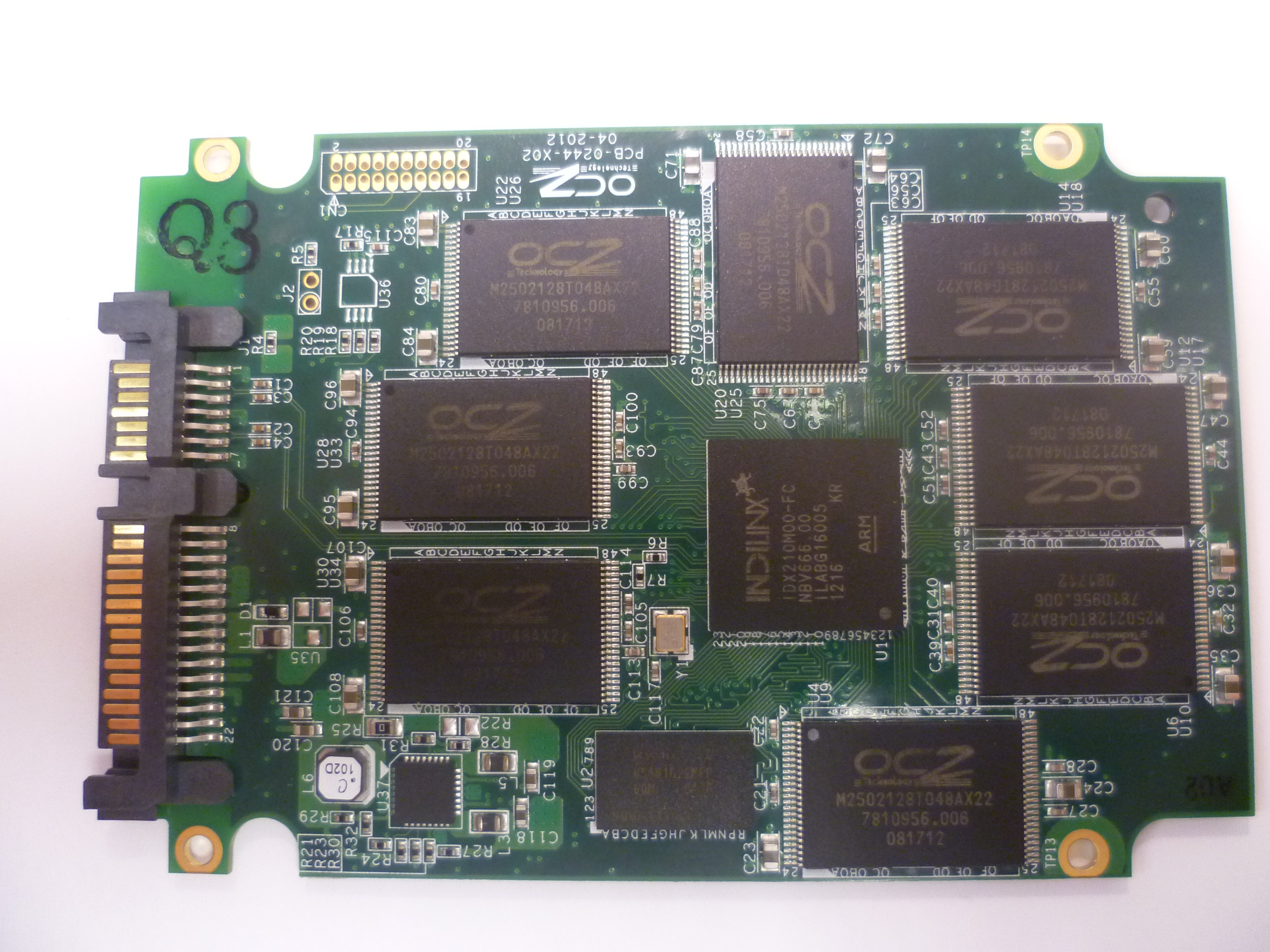

 Post subject: Dead OCZ Vertex Plus R2 240Gb
PostPosted: May 18th, 2015, 10:24
Here it is...

pcimage wrote:
Here it is...
Sean ,
What Are You Trying to Do In It [ Research or Data Recovery ] . Its Interesting To Know How In So Many NAND Flash Memories You Find The Sequence of Chips like 1...2...3... .

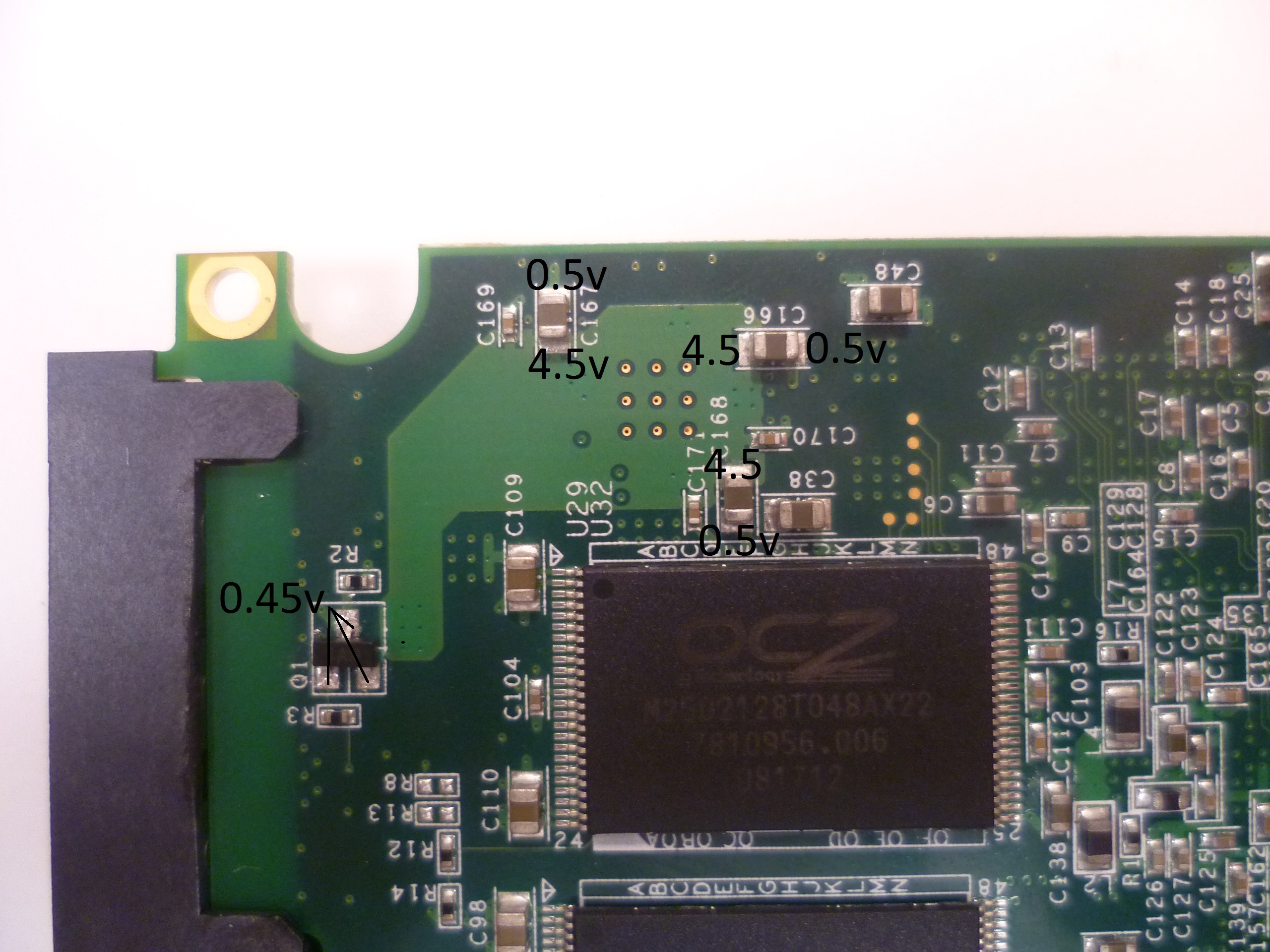

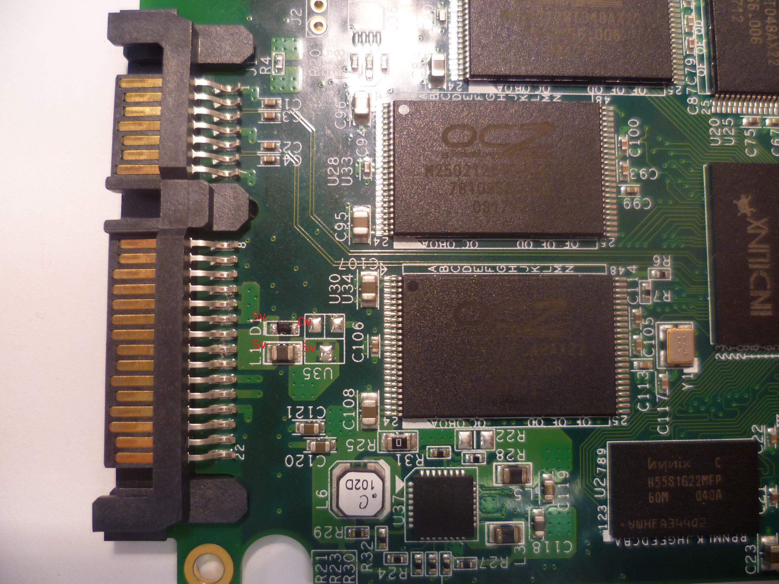

Drive is dead.
Voltages normal coming in...
 Post subject: Re: Dead OCZ Vertex Plus R2 240Gb
PostPosted: May 18th, 2015, 11:00
But on the back-side of the PCB's the capacitors C166,167 and 168 get very hot.
Voltages measured from ground for the capacitors and the transistor.
I'm no component-level electronic expert, so any help/advice gratefully received :-)

If the caps are getting hot its probably a ripple coming from the VRM..
get a scope on the VRM outputs to see whats going on..
thing is the ripple could be the result of 1 of 2 scenarios..
1. the VRM is faulty and outputting a ripply mess..
2. the VRM could be overloaded by a faulty component taking it outside of its drive specification causing the ripple.
hope that helps
Marko

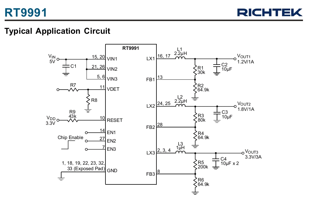

AFAICT, C166, C167, and C168 are connected across the incoming +5V supply via inductor L1. Together with L1 they comprise a low pass LC filter which is intended to remove high frequency noise from the supply. That said, the voltage at L1 is 5V, yet the voltage at the caps is 4.5V and 0.5V. ISTM that the voltage at the caps should be 5.0V and 0V, in which case you are using the wrong ground reference for your measurements.

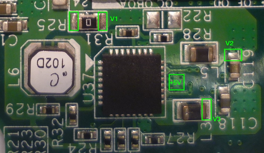

It would be very helpful to know the part markings on U37, but AFAICT it consists of 3 buck regulators. I would measure the following voltages (using the correct ground reference):
You're right, using a different ground point, the caps are read 5.0 & 0V.

The markings on U37 are:
RT9991
GQV
EG94B
Which appears to be a "Richtek" PMIC
V1 reads 0.45V average, it does waver between 0.4V & 0.5V
V2 reads 1.8V
V3 reads 1.0V
+5V reads as it should.. 5V
PostPosted: May 19th, 2015, 6:40
Posts: 17335
V1 is the NAND supply. Something wrong there ...
V2 appears to be the supply for the SDRAM, while V3 is the Vcore for the flash controller. ISTM that these two are OK.
I would start by confirming that pin 7 is high.
PostPosted: May 19th, 2015, 7:01
Pin 7 is reading 5V
Whereas pins 2,3 & 4 (LX3) are fluctuating around 0.5V
PostPosted: May 19th, 2015, 7:20
Posts: 17335
The NAND supply is being enabled, so either the chip is bad, or there is an overload on its output. Measure the resistance between V1 and ground. If the resistance is low, then I would suspect one or more of the flash chips.
PostPosted: May 19th, 2015, 9:36
Got it working :-)
C48 was the culprit, shorting the NAND side.
Cloning now....
