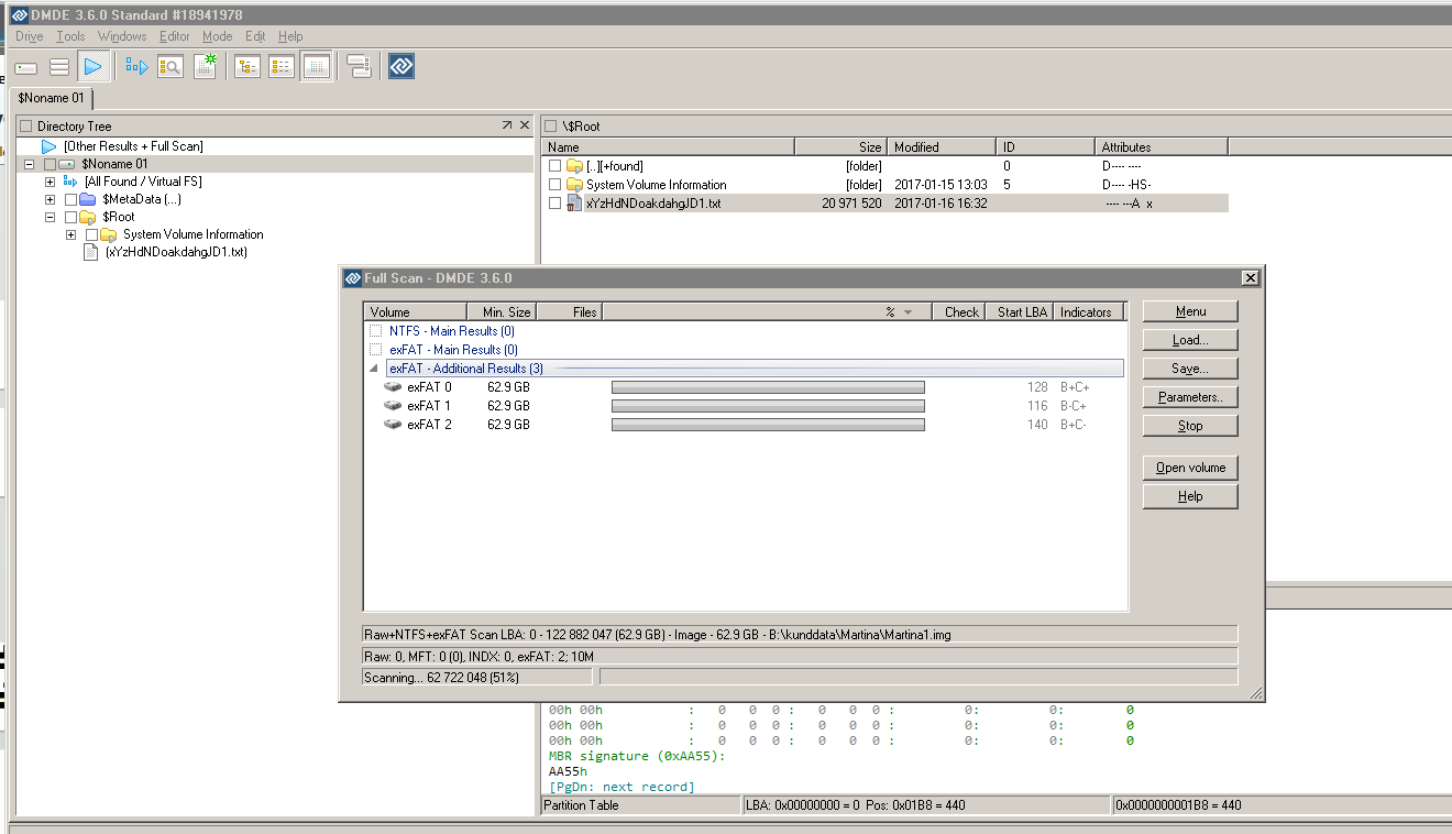

Today a customer brought me a USB-stick for investigation. She said that when it was inserted, Windows could find it but asked the user if the stick should be formatted. She clicked "no" and pulled out, never touching it again. Then she called me and brought it here.
First thing I did was to mirror the stick, no read errors or anything like that. Got a 64GB image dump which I'm currently investigating in DMDE using Raw, NTFS and extFAT-filters. I expected to see something during the scan, but I get literally nothing except for a System Volume Information-folder and a single file called xyzhdndoakdahgjd1.txt, which is 20MB large. Even if she acidentally clicked "yes" to the format question, I would have seen a lot of old files, but no.
Sysinfo tells me the stick was formatted 2017-01-15 which is prior she bought it, and the mystery file is timestamped the day after. This does not add up, and something is fishy here but I cannot figure out what. I tried to recover the txt-file in DMDE but was told there was a I/O error so I cannot peek its contents.
What happened to the stick? Has it been the victim of a ransomware attack or something? I've never seen it before.
(While writing this post DMDE finished the scan 100% with 0% information found)

I just performed a test by compressing the image (64GB):
bos@basterd:/backup/$ time gzip -1c Martina1.img > img.gz
real    6m45.718s
user    5m19.580s
sys     0m32.104s
bos@basterd:/backup/a$ du -sh img.gz
262M    img.gz
And that tells me that the image is basically filled with zeroes, so the drive has most likely been wiped. The test does not, however, give an answer to what the mystery txt-file is about; why it's there and what it contains.

When you look with disk editor, largely zeros? If she's really telling the whole story, my guess is corrupt translation table.
Ransomware leaves data behind for you to unlock after paying ransom. Ransomware that wipes everything does not make sense.
Heuh? After scanning your image file? If you open folder in hex editor and jump to first cluster file?

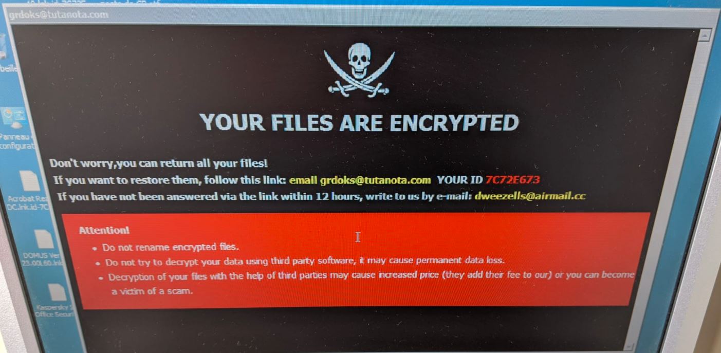

Question little bit out of topic...how do you deal with Ransomware device ? That USB drive could infect your system, isn't it ?
I got two disks from a customer, they are encrypted by ransomware. So far, I did nothing, I don't want to infect my system, I am building a Ubuntu PC for that purpose, is it the right way ?

Thank you. I don't want to hack this post. I'll create a new one with my ransomware question. Here is what customer got. He didn't pay. We had backup from last week. He's just looking for two files if possible.

Paying often enough is not a guarantee you'll be sent a decryptor. I have seen plenty of cases where people pay and get nothing, or a reply stating they want more.
To exactly know the ransomware upload an encrypted file here: https://id-ransomware.malwarehunterteam.com/ but it looks like Crysis Ransomware (= Dharma Ransomware). ID-Ransomware site will also tell you if there's a decryptor available.
If not:
- I regularly saw ransomware fail encrypt deeper nested folders, so you can always check those. Sometimes simply renaming them (get rid of ransomware extension) is enough to do the trick. A RAW scan will of course detect such files too which may be responsible for part of successful recoveries attributed to PhotoRec I sometimes see in forums.
- In general many ransomwares write encrypted data to newly created file and deletes original. If you're lucky original data may survive although there's of course the huge risk those newly created encrypted files overwrite 'vacant' clusters of the deleted original files.

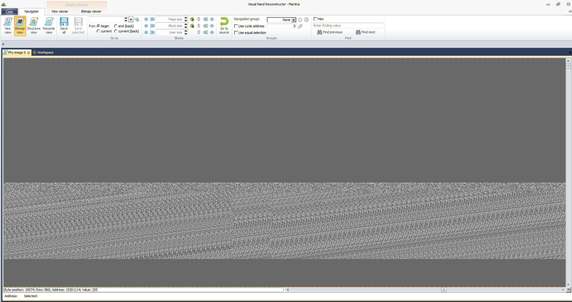

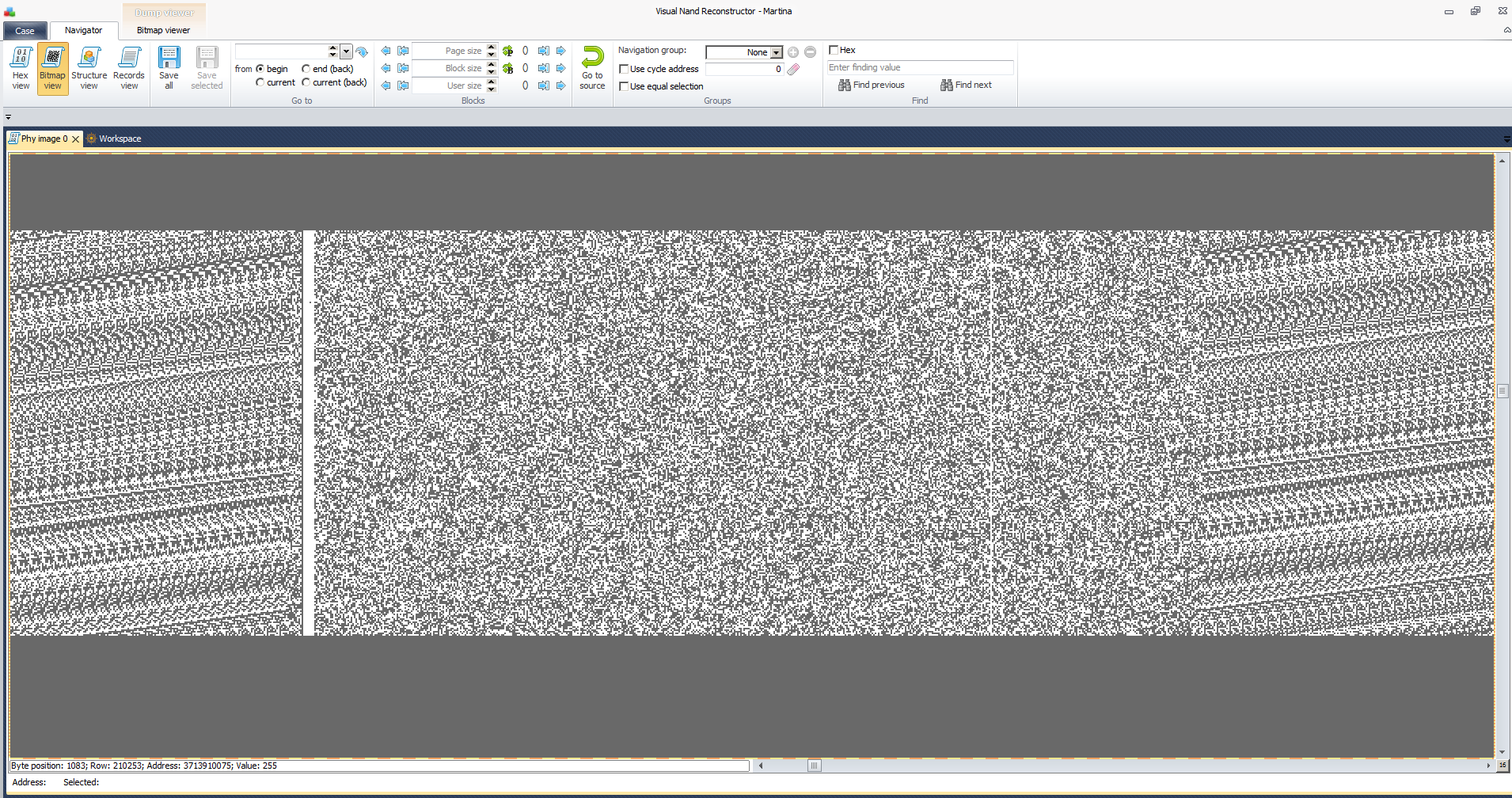

Now I made a dump of the chip. Single 64GB chip (ID 98DE949376, Toshiba P0170007-5) with unknown controller (potted IC). The only entropy I can find is near the beginning, looks like an XOR-key, but the rest of the chip is basically gray and white areas. Seems to me it's completely wiped.
I can't figure out what on earth happened. Wipe-out due to ESD or something?

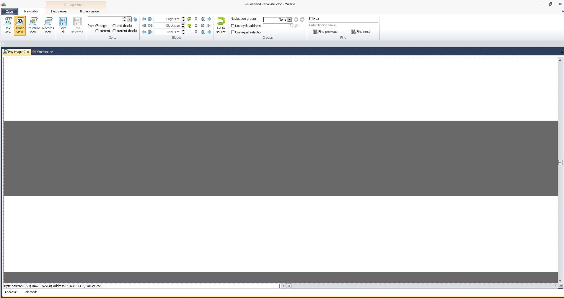

I found this near the middle. Looks like ECC, and that's the only non-repetitive pattern I can find in the whole chip. Maybe this is the mystery file.
Other than that, I find no resemblances of LBN at all on the chip.
