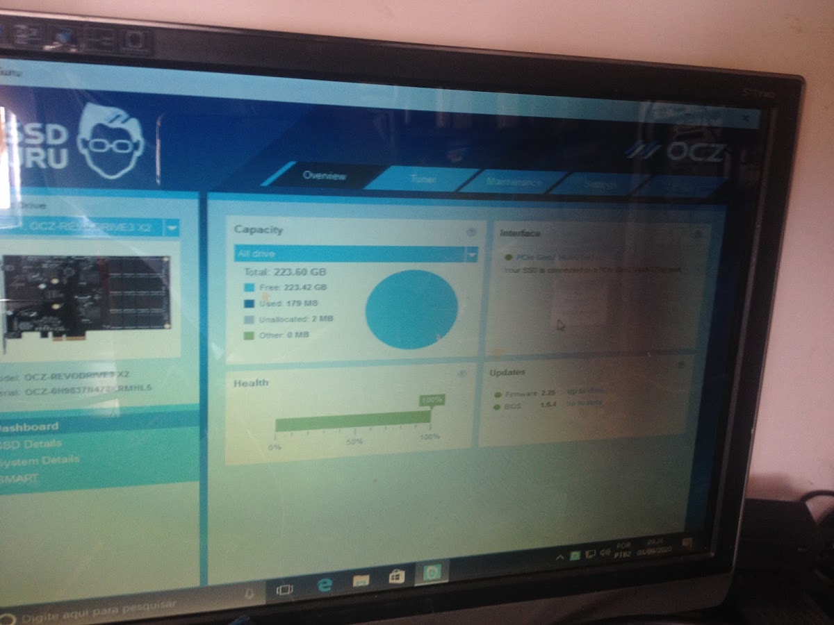

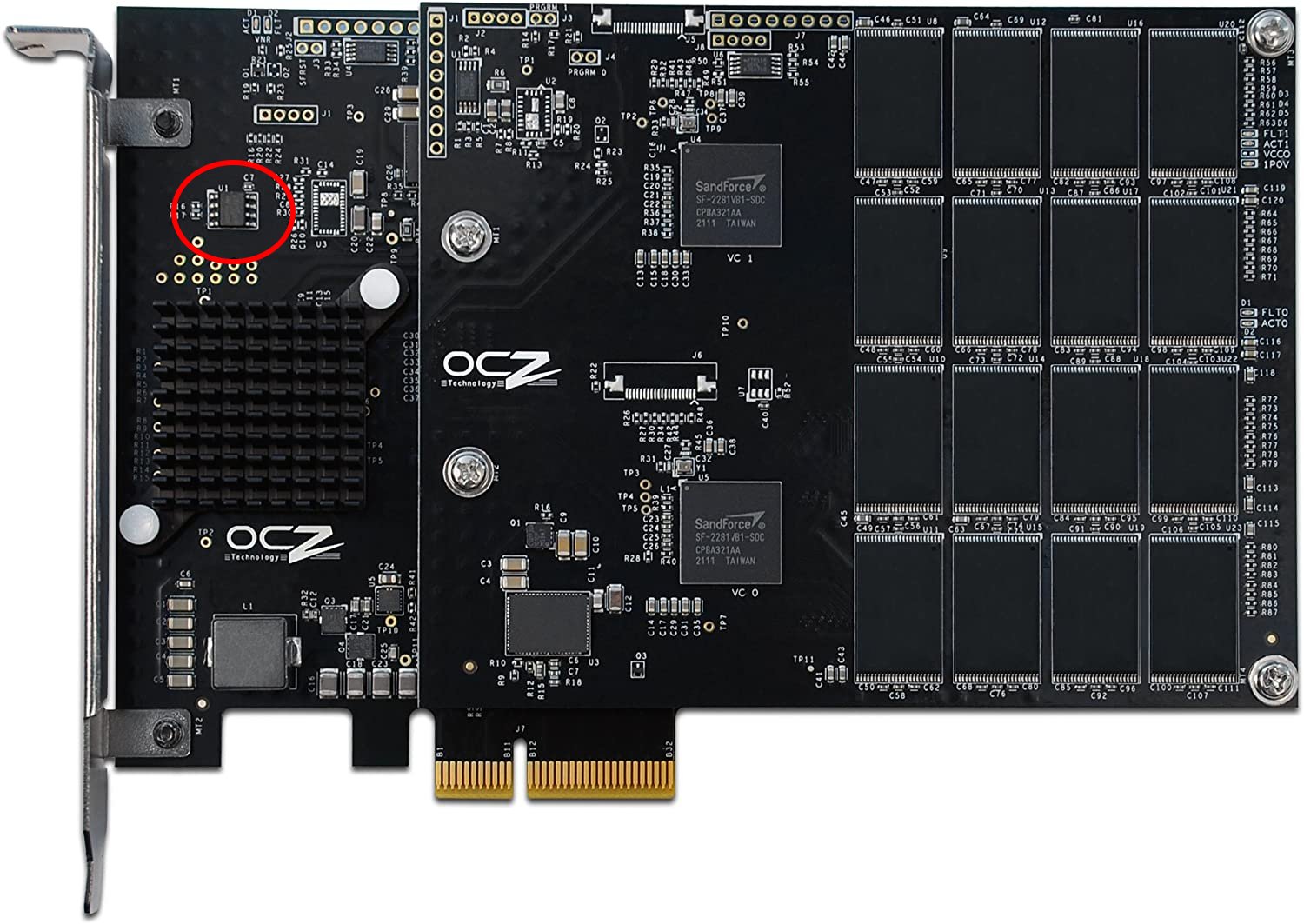

Last weekend I was trying to repair a old Ocz revodrive 3 x2 240GB.
The SSD was correctly detected by windows, but one of the four sandforce controllers, connected to the marvell 88se9485, was not starting up.
Without ideas, I have upgraded the firmware of the marvell and the of the sandforce controllers.
In the end I have discovered that the problem was a tiny little coil that was broken, after the replacement of the coil, all 4 sandforce controllers are getting detected correctly.
but the firmware upgrade of the marvell 88se9485 without one of the sandforce controller have screwed up the card config, now the card is not getting detected by windows.
Well, I m looking for a full dump of the firmware of the marvell 88se9345. It is a 25p40vp SPI flash marked as U1 on the board.
Thanks in advance

There seem to be two main blocks of code, each with an 8-bit checksum of 0x00.
Offset(h) 00   02   04   06   08   0A   0C   0E
00000000  55AA 80E9 0004 0000 0000 0000 0000 0000  Uª€é............
          ^^^^ signature
00000010  0000 0000 0000 0000 1C00 7001 5043 4952  ..........p.PCIR
0000FFE0  5652 414D 0000 0000 0000 0000 0000 0000  VRAM............
0000FFF0  0000 0000 0000 0000 0000 0000 0000 00D5
    8-bit checksum byte for block 0x0000 - 0xFFFF
00010000  4F44 494E D0CB 5589 E553 5152 5657 E813  ODIN.....SQRVW..
                                                   "ODIN" = internal product name?
00014FF0  0000 0000 0000 0000 0000 0000 0000 00CE
  8-bit checksum byte for block 0x10000 - 0x14FFF
Don't know what this is ...

The revodrive is working again!
My theory was that even if the firmware from pepe has information from a wrong array and was not exectly the same card, maybe its is "sufficiently good" to make the card get detected and enable the flasher to update the bios.
To make things worse in each operating system the flasher reacts different
- linux using generic mvsas driver: only the sandforce controllers was getting detected
- linux using the old oczpcie driver: the flasher didnt detected the card and kernel was still throwing errors relative to card config
- windows 10: ocz scsi driver detected and flasher enabling the option to update the bios, bingo!
After flashing the bios, I rebooted the system and the array was correctly detected as a raid 0 of 240GB (4x 60GB).
Thanks fzabkar and pepe for the help!
