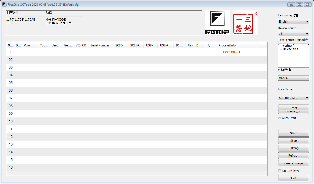

I have an HP 64GB flash drive with below details:
Protocal Version: USB 2.00
Current Speed: High Speed
Max Current: 100mA
USB Device ID: VID = FFFF PID = 1201
Device Revision: 0000
Manufacturer: NAND
Product Model: USB2DISK
Product Revision: 0.00
Controller Vendor: FirstChip
Controller Part-Number: FC1179
Flash ID code:      AD3A14030850 - Hynix - 1CE/Single Channel [MLC] -> Total Capacity = 16GB
Tools on web:       http://dl.mydigit.net/search/?type=all&q=FC1179
I visited https://www.usbdev.ru/files/firstchip/fc1179mptools/ and tested some of the MpTools programs, but they couldn't fix my drive!
Any idea to fix my flash drive?
Thank you.

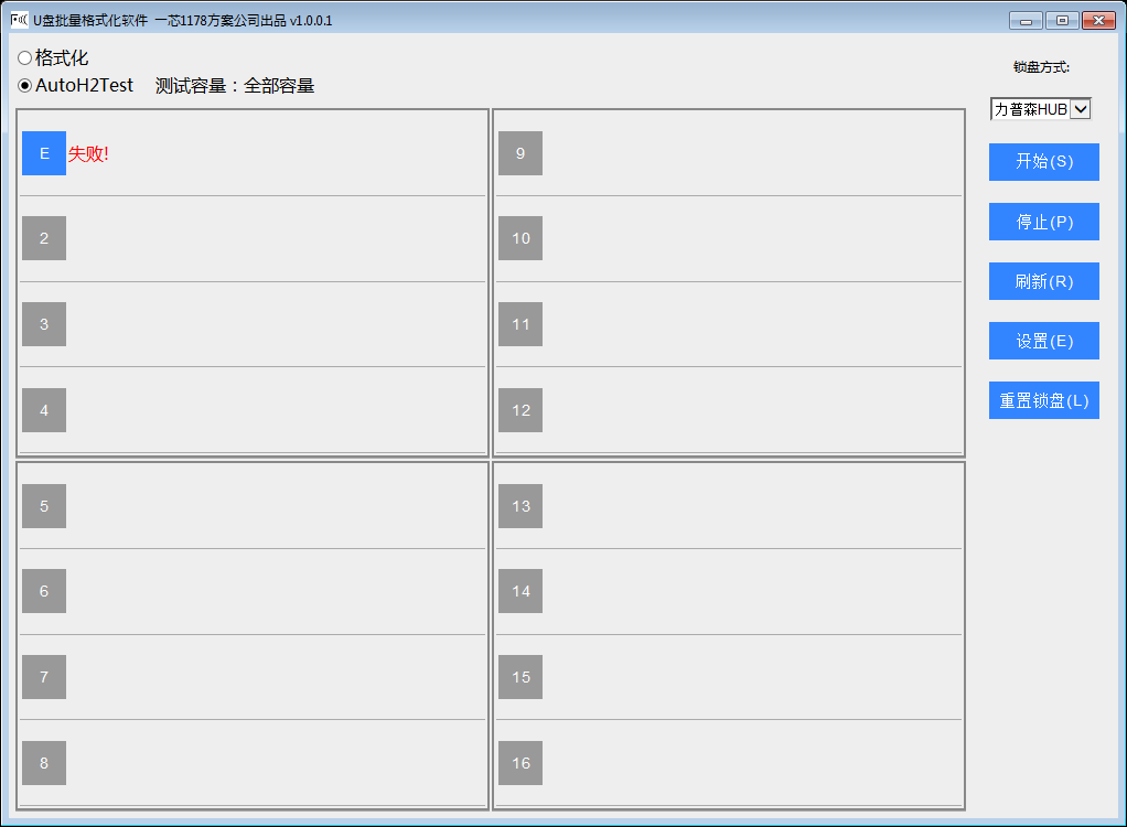

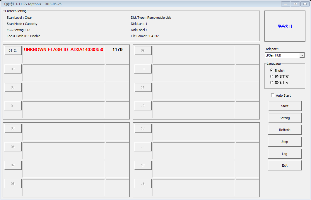

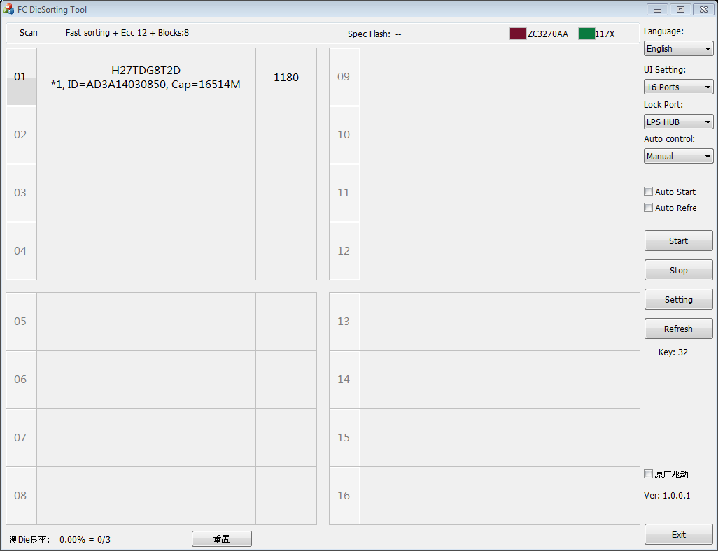

I tested some tools and attached some photos:
