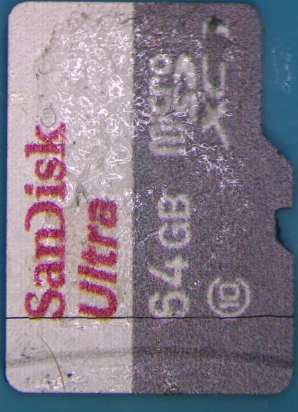

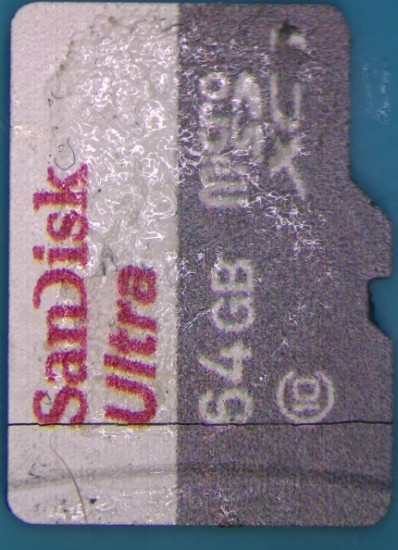

Got this cracked mSD card. I got full ID via NAND 453EAAA2, got memory dump, corrected and reread in more than 95%. Some red blocks here and there but most is good. So it's not a situation where bad blocks would ruin every file. It was used in many phones. Last one was Xiaomi Mi A2 Lite. I recovered only 69 jpegs, 10 of them work good. They are old, from another phone. I scanned the dump in every possible way. Results are the same. Client doesn't know if the card was encrypted by the phone.
But, if it was encrypted, why did i find some old pictures? It should be encrypted in 100%, right?
Looking for someone with more experience willing to check it.

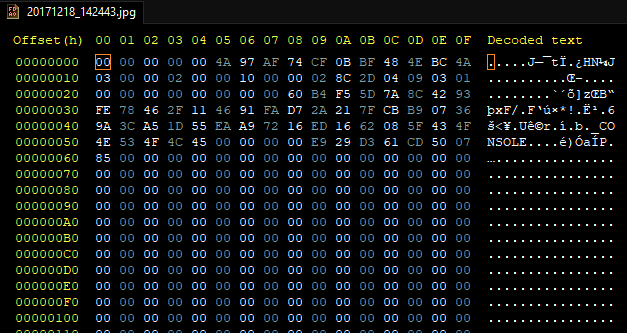

It's possible files are individually encrypted (FBE). If you scan with my tool JpegDigger (the logical image) you may be able to tell by looking at entropy map (cyan = encryption-ish entropy) although that's not conclusive 'evidence'. Also individually encrypted files I see contain string "CONSOLE".

Didn't find any "CONSOLE" except console.log files.
Jpegdigger cannot determine the file system type. Used override, set 64GB but when pressed "scan" i get:
Run-time error `13:
Type mismatch
and the program closes.
Funny thing is that beginning of logican image looks good. Looks like fat, many words can be recognized like "scroll the app" but the rest looks like garbage.

Of course here it just runs fine. Weird. You were using 2.6.280 too?
https://imgur.com/bSyOiPj
Cyan = superhigh entropy which suggests it's encrypted data.

Ah, I see. No folder tree either? So entire volume is encrypted? Probably CONSOLE string is in files encrypted with file based encryption. So your card was configured as internal memory. Other option is as portable storage and in that case encryption is optional. And if enabled it's probably FBE AFAIK.
