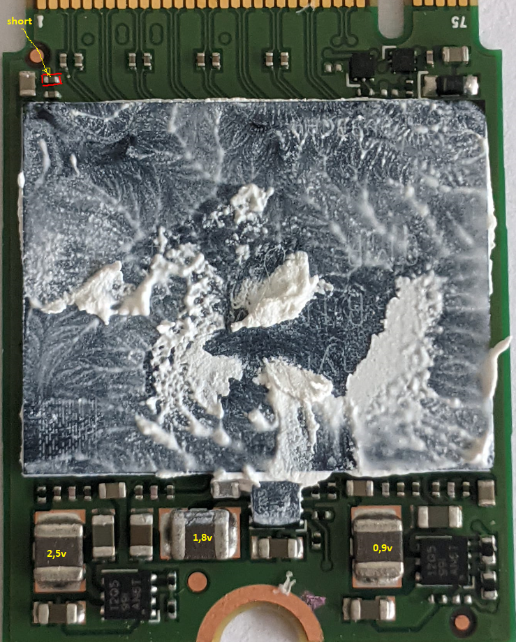

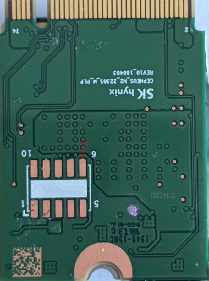

Has anyone work on those Surface m.2 before ? I am looking for test point/safe mode. I've checked all resistor and coil, nothing bad. There's on short but I beleive it's fuse.

You may be able to provoke safe mode by disabling the 2.5V supply. You could do this by grounding the Enable pin, assuming it is connected to a pullup resistor.
https://www.ti.com/lit/ds/symlink/tlv62085.pdf

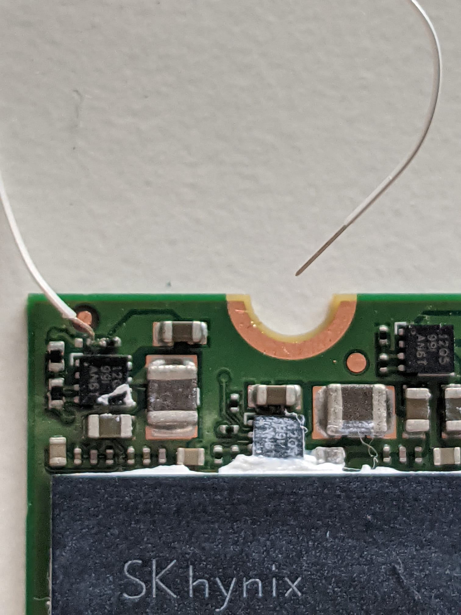

Thank you. I've tried to GND before the pull up, no luck.

ok, I desoldered the chip and could read it.

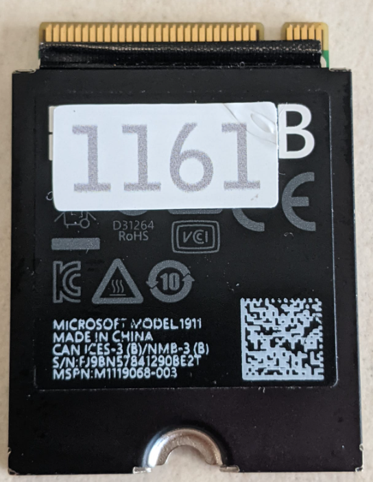

It is a PCI-E drive, but you are trying to read it over SATA.
Doh, you're right. It should have been obvious from the photo, but here is added confirmation:
https://www.techpowerup.com/review/sk-hynix-gold-p31-1-tb/
The controller is an in-house design by Hynix called "ACNT038," or "Cepheus."
Interface: PCIe Gen 3 x4, NVMe 1.3
How do you mean? Desoldered onto another adaptor, or do you have a test socket?

suricate.ch wrote:
Thank you for the info! I have been searching for a test socket for these BGA 1620 chips.
Up until now I have been using a Samsung PM971 PCIe card, I removed the existing chip and replace with the one that requires recovery. Very fiddly reball job (using universal stencil) but I have had a lot of success using soldering/reball method (Device can be access via PC3000 portable PCIe adaptor)
