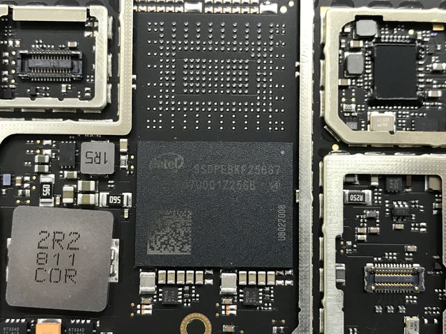

Have anyone seen this chip?
Is there any kind of interface for that?

It is strange the chip part number is the same as Intel SSD Part Numbers. maybe a fully integrated drive on a chip, a monolith SSD essentially?

Here is a SATA/PATA "SSD on a chip" (Silicon Motion FerriSSD):
http://static6.arrow.com/aropdfconversion/e34a936206aef41642e4466404978f1b53963ba5/ferrissdproductbrief_eng.pdf
http://www.storagesearch.com/ferrissd.pdf
Toshiba and Samsung both have NVMe SSD-on-a-chip products.
I suspect that the vacant BGA location above the Intel chip is reserved for a second SSD. This should make it easier to determine the pinning for the supply rails and interface signals.

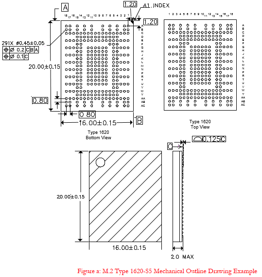

Single-package SSDs fall under the PCI-SIG, and there are four standard form factors. The Toshiba and Samsung products use the Type 1620 package that measures 16mm by 20mm. The form factor can operate over a SATA 6Gb/s bus or PCIe 3.0 with either two or four lanes (presumably NVMe).
https://www.tomshardware.com/news/intel-bga-nvme-ssd-600p,36172.html

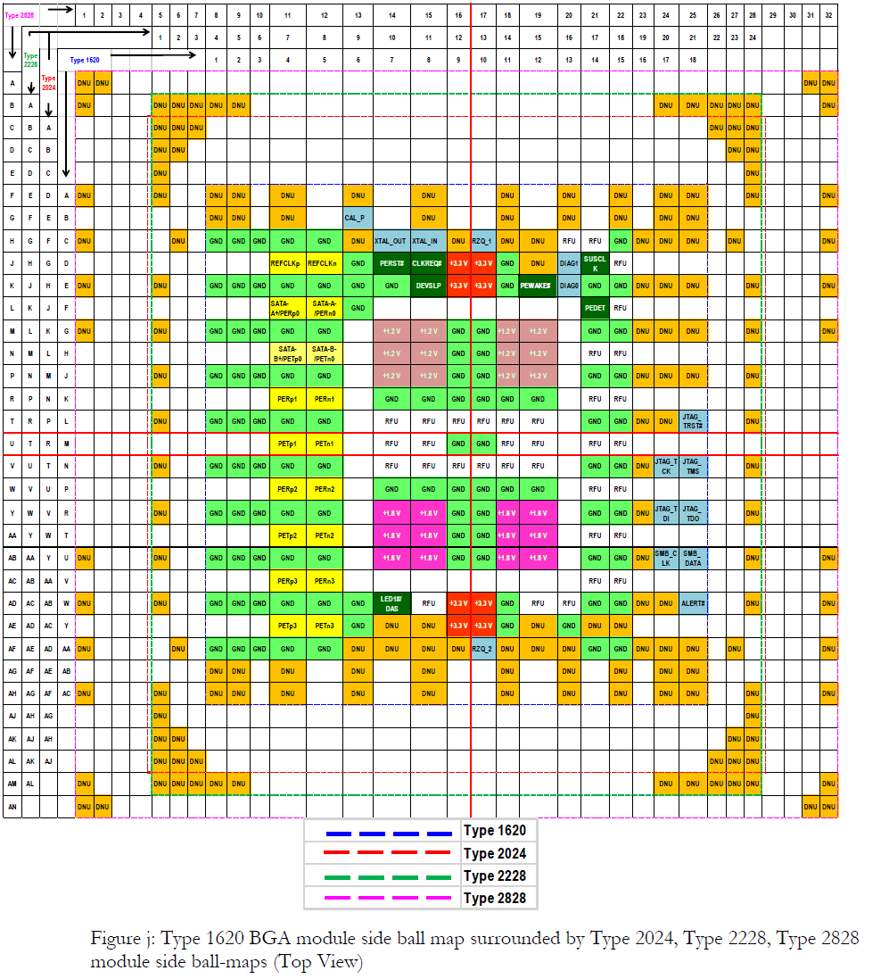

pinout (Arguably useful) : in this doc: https://pcisig.com/sites/default/files/specification_documents/BGA_SSD_ECN.pdf

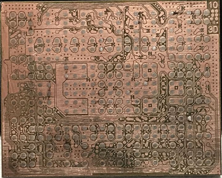

And another one came today.
Now it is Surface Laptop.
Desperately need some socket solution.

You can make one. !!
https://www.google.com.au/amp/s/m.aliexpress.com/item/32823128771.html

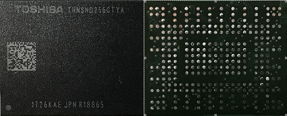

It wouldn't be too bad to just wire it up like a monolith I suppose. I doubt it'd require power input on all the different voltages either. My guess is it's just different options the manufacturer can opt to use to power it. I'd guess that just using the 3.3 or 1.8 would suffice.
