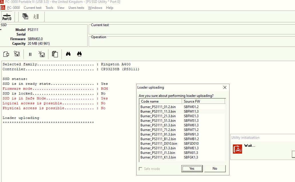

Would anyone be able to recognise this SSD? Trying to work out if it's supported under PC3K Portable. It doesn't seem to match or correspond to any model. Is it a rebranded A400?
Any help would be appreciated.

SBFK10D7 = Phison PS3111. Supported.

Thanks for the reply, still unclear as to which one to choose. Is it under Kingston?

You can choose any utility for PS3111. Loader SBFM11.3

Many thanks Agrail.
Translator built and now recovering.
