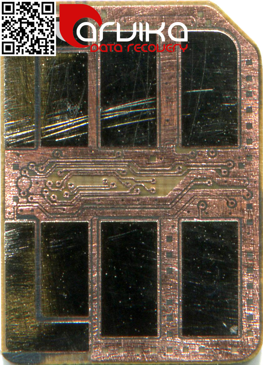

Hello
Anyone know the pinout for those Huawei Nano Memory card ? I can't order adapter here, they are out of stock and it will takes 3 weeks to get one from China.

Here is the pinout for interface And removed layer:

Thank you !
