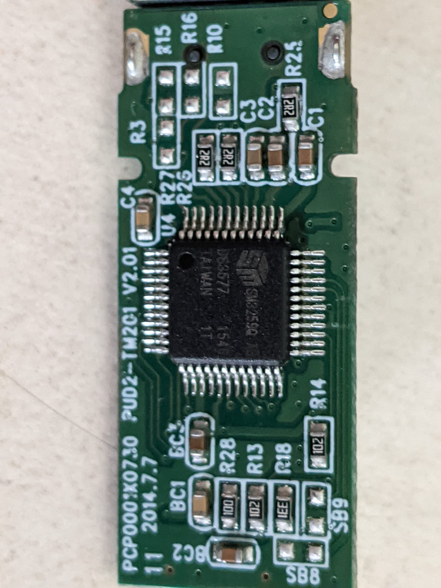

Hello
I got this USB drive, 16GB. Drive is recognized, mounted but look like controller go BSY afer 1-2 seconds. I tried to clone with PC3K but I need to unplug, plug again and it get between 0 and 4 mb each time... so I am going nowhere. It's SM controller, SM32590. Is there anything I could try ?
I could save all small files but impossible to get file larger than 500 Ko
Chip-off is not an option for now.
Claude

USB Stabilizer can sometimes help with this type of scenario.
Before I had that I used a YKUSH XS to power cycle (https://youtu.be/3Euh4eD_x-Y). HDDSuperClone can now also work with the YKUSH which has the advantage of running in Linux. Also HDDSuperClone supports more YKUSH boards although I still prefer YKUSH XS as it forces USB 2.

Guessing you don't have a USB stablizer handy?
What settings in PC3K are you trying?
Have you tired in a usb 2 port?
Have you tried hddsuperclone?

Thank you.
No, I don't have a USB Stabilizer yet.. maybe it's time to get one. I've tried USB 2.. same.
I've tried with HDD Superclone, worst thant PC3K, Linux doesn't recognized NAND, just gives an error.
PC3K, I have tried on/off hardware retires.. Pendrive always disappear on windows, so changing settings have little effect. If I could automate the "unplug, plug back" that would be enough. I have such behavior with SSD in the past and PC3K could handle it.. not here.
What is the best choice in USB stabylizer ?
Do you have the paid pro version of HDDSuperClone? If so you would need to use the Direct USB mode to attempt reading, likely with a relay to power cycle. The pro version used with a relay can be like a USB stabilizer. The free version is not much better than using the OS.

Thanks. I have the Pro version but don't have a relay, I'll see how to get one in Europe.

Hello
I got YKUSHXS today. I can turn it on/off from cmd line but I'll need to script it to automate it.

Big thanks Arch Stanton :cool:
I could recover it with PC-3K and YkushXS. Was pretty easy, just did a little batch loop.
:loop
echo Loop Start now
timeout /T 15 /NOBREAK
ykushcmd.exe ykushxs -d
timeout /T 3 /NOBREAK
ykushcmd.exe ykushxs -u
goto loop
I'll do the same with HDDSuperclone to compare, maybe tonight, if not it will be in 10 days as I'll be off for next week.
