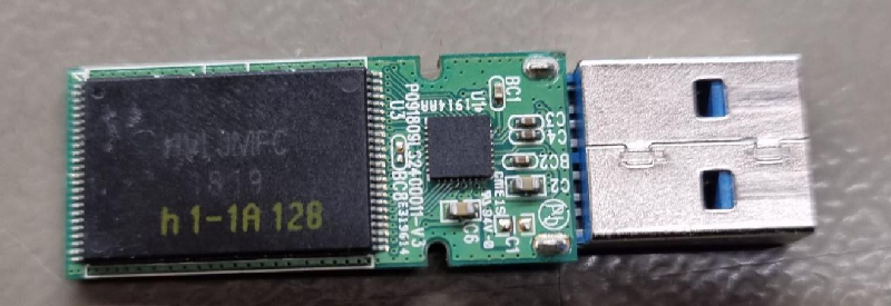

I try to recover data from broken USB stick for a friend. It's the first time I try to do that.
The USB stick is build around PS2251-09-26 and a "noname" NAND.
Controller PS2251-09-26 seem completely broken so I unsold carrefully the NAND

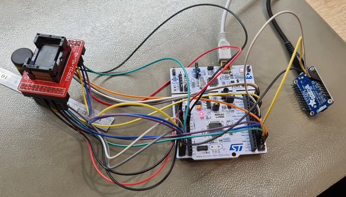

And I build a "Poor Man NAND Reader" with a TSOP48 adapter, a NUCLEO board and some dupont wires...
(I add a FT232H breakout to increase serial output speed).
I write a peace of code to download data on PC from serial port.

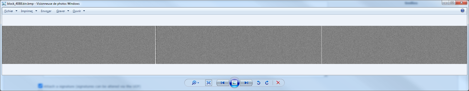

I write a small code to concat some block and add BMP header (I concat only 8 block because of the limitation of the bmp size)
Now I can use the Windows image viewer to quickly navigate into NAND blocks or GIMP for pixel (offset) measurement

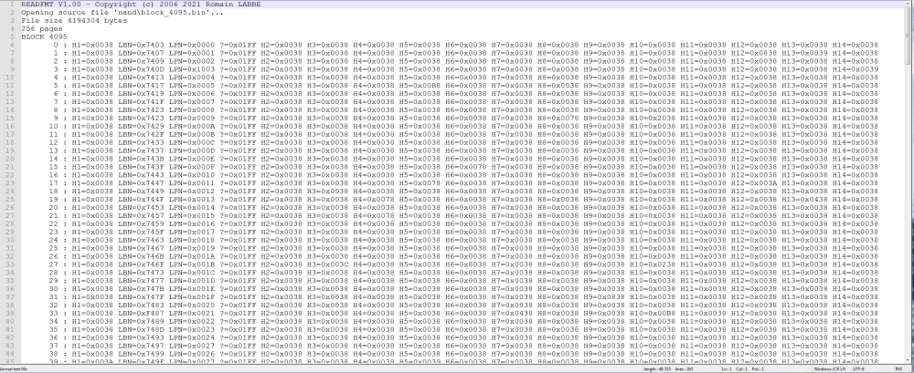

I'm able to find some header, LBN and LPN and some thing look like flags "0x01FF".
I can get the boundary of all area of the pages
      25 : H1=0x0038 LBN=0x7467 LPN=0x0019 ?=0x01FF H2=0x0038 H3=0x0038 H4=0x0038 H5=0x0038 H6=0x0038 H7=0x0038 H8=0x0038 H9=0x0038 H10=0x0038 H11=0x0038 H12=0x0038 H13=0x0038 H14=0x0038
      26 : H1=0x0038 LBN=0x746B LPN=0x001A ?=0x01FF H2=0x0038 H3=0x0038 H4=0x0038 H5=0x0038 H6=0x0038 H7=0x0038 H8=0x0038 H9=0x0038 H10=0x0038 H11=0x0038 H12=0x0038 H13=0x0038 H14=0x0038
      27 : H1=0x0038 LBN=0x746F LPN=0x001B ?=0x01FF H2=0x0038 H3=0x003C H4=0x0038 H5=0x0038 H6=0x8038 H7=0x0038 H8=0x0038 H9=0x0038 H10=0x0238 H11=0x0038 H12=0x0038 H13=0x0038 H14=0x0038
      28 : H1=0x0038 LBN=0x7473 LPN=0x001C ?=0x01FF H2=0x0038 H3=0x0038 H4=0x0038 H5=0x0038 H6=0x0038 H7=0x0038 H8=0x0038 H9=0x0038 H10=0x0038 H11=0x0038 H12=0x0038 H13=0x0038 H14=0x0038
      29 : H1=0x0038 LBN=0x7477 LPN=0x001D ?=0x01FF H2=0x0038 H3=0x0038 H4=0x0038 H5=0x0038 H6=0x0038 H7=0x0038 H8=0x0038 H9=0x0038 H10=0x0038 H11=0x0038 H12=0x0038 H13=0x0038 H14=0x0038
With the header Hx and LBN I'm able to get the full logical block number I think

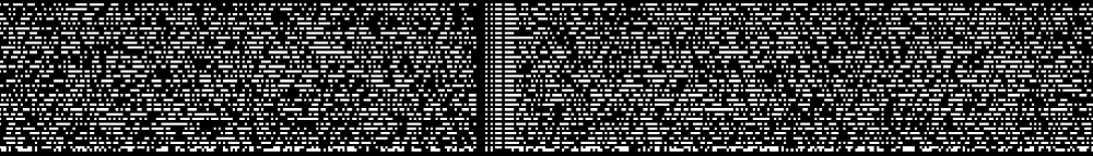

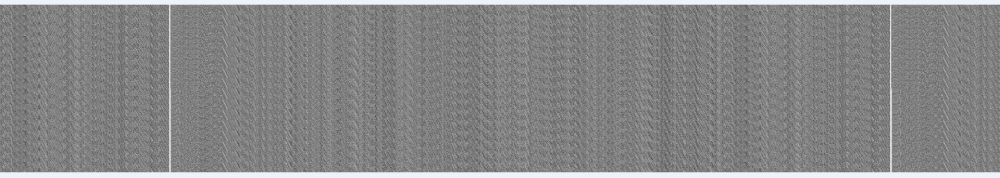

When I take look on the bitmap representation I found different type of blocks
I'm not sure what kind of block/data it is.
Some scrambled/noisy block : XORED DATA ?
Some recurrent pattern block : 0 XOR KEY ?
Some unscrambled bloc : BLOCK TABLE ?
I really don't know what are thoses unscrambled information

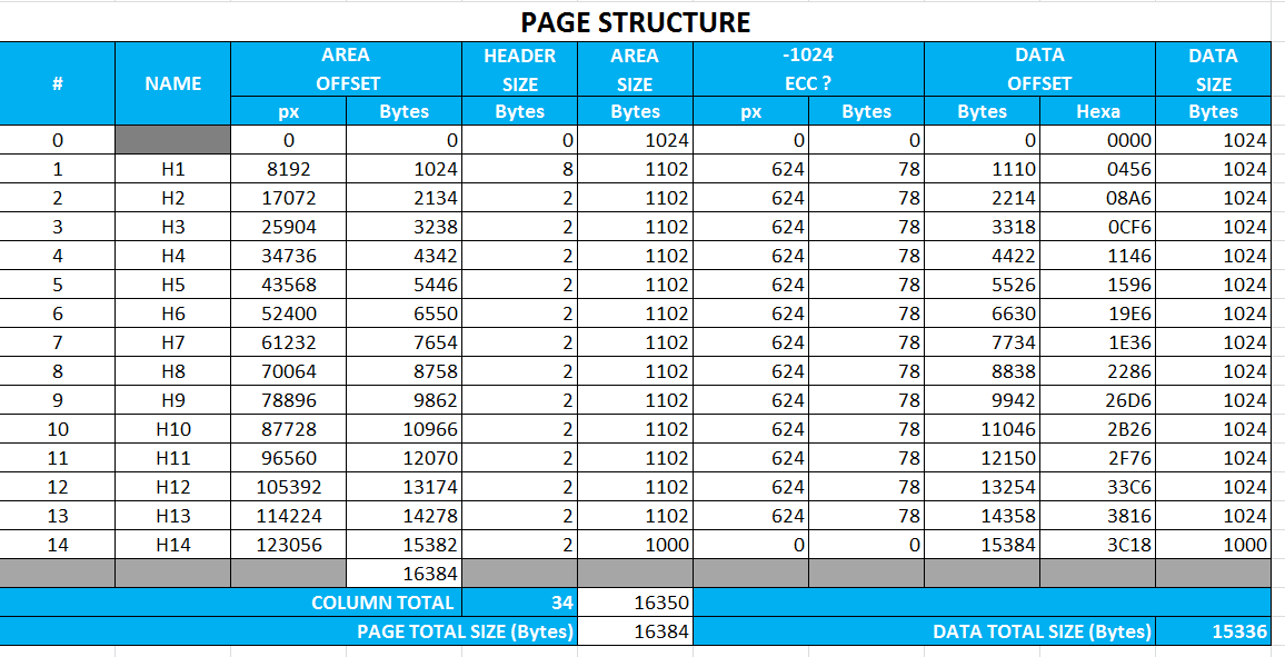

I begin to document the format of page

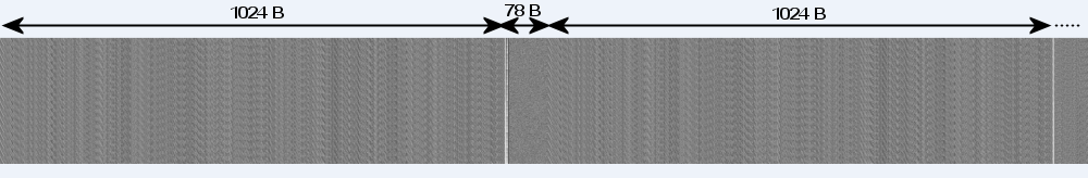

I write a small code to extract and filter the 15 data areas of each page without the header and 78 bytes (ECC ?), I take look on a block with visible repetitive pattern
I can see the repetitive pattern (the key ?) is shifted left of 1024 bytes at every pages
For instance I'm not sure about key length... but I think it's page size (15336 Bytes) but visualy it seem to be 1024 Bytes...

Posts: 922
XOR block usually start from 9A9EF0 at this model, but start from correct ECC. Wihtout it all data will be broken and all your work will be useless.

Many many thanks for the key start, that what I found, I found the shifting rate too. Big THANKS thanks for confirmation this help me a lot.
I thought that ECC data was not scrambled by XOR key, so XOR key is "round robin" shifted applied on all datas parts (1024 bytes) of a page except on "headers/LBN/LPN" (8+(13x2)=34 bytes) and "ECC" (13x78=1014 bytes). Did you confirm that ?
In other words:
Did you confirm ECC (78 bytes) areas are not XORed ?
Does ECC (78 bytes) is applied on scrambled data or unscrambled data (1024 bytes) ?

 Post subject: Re: Help to unscramble my NAND flash
PostPosted: September 9th, 2021, 17:02
Posts: 4790
there seem to be a couple of errors in the above.
page size is surely not 16384 bytes. The page should fit an integer power of 2 sectors (512 bytes), so 14*1024 + ECC is not enough.
Try setting the read page size to 20KB and check where the page actually ends. (usually FFs are read beyond the end of the page).
in your case it should accomodate like 16 1K sectors plus ECC plus SA.

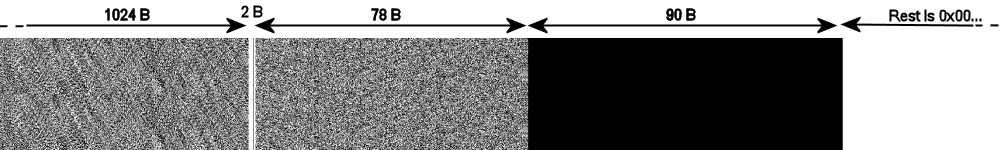

Ok pepe, you are right, i'm not read the entire pages...
I do a quick test and I receive that at end of pages.
Last sector of data         1024 B
The delimiter/header           2 B
The missing area (ECC?)       78 B
A full of 0xFF area           90 B
The rest of 20KB is 0x00
                       SIZE OF PAGE
Without 0xFF area   141360 px    17670 B
With 0xFF area      142080 px    17760 B
Pfff... I need to re-read all my NAND...
I will take this opportunity to optimize my power supply filtering and level...
Another big THANKS pepe, this help me a lot.
PostPosted: September 10th, 2021, 12:17
Joined: September 6th, 2021, 15:07
Posts: 22
Location: France
Ok, so this is the true page structure of my NAND for instance

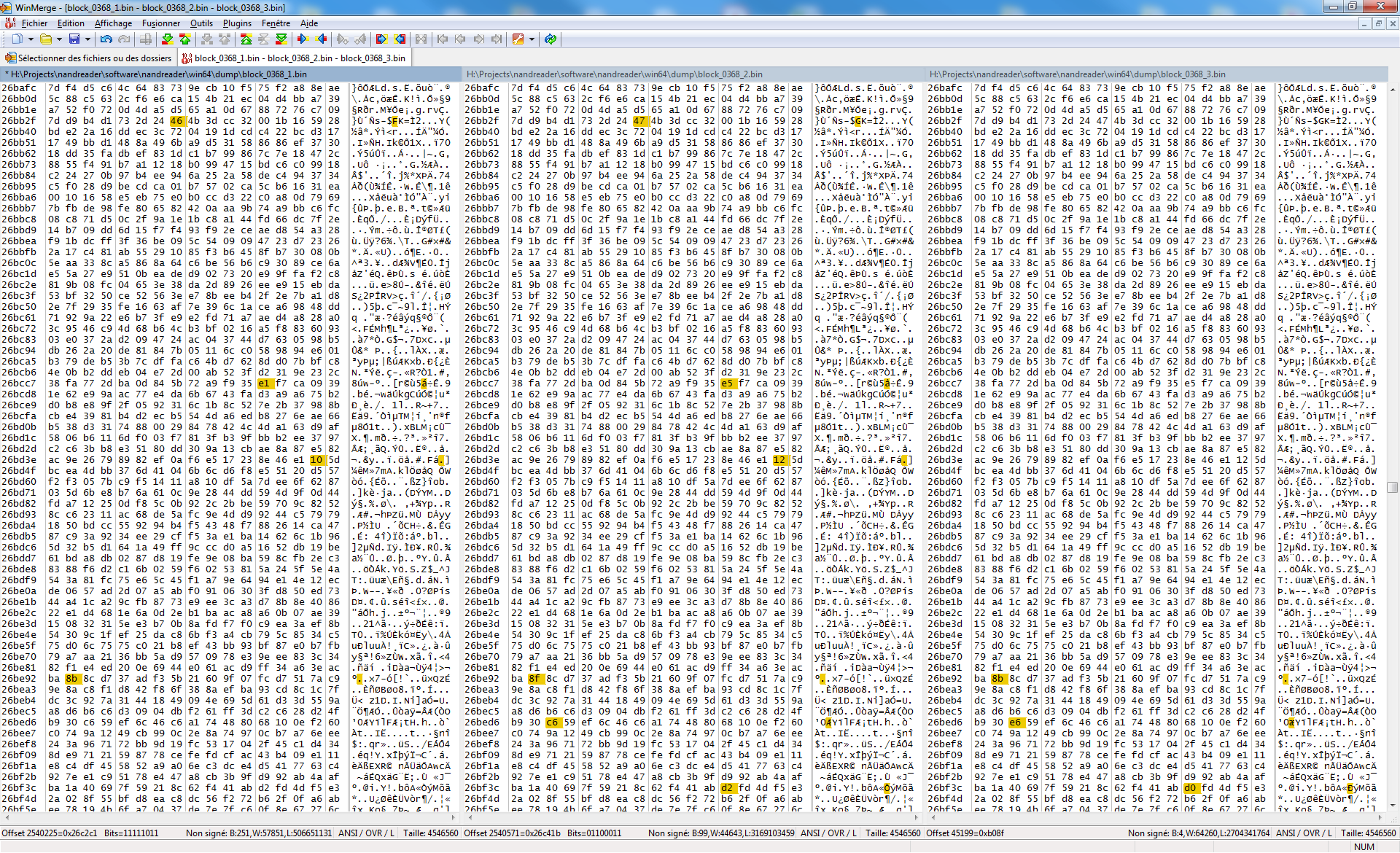

My reader is not very good in that state, if I had time, I will probably make a small PC to connect properly the TSOP48 adapter and the NUCLEO board, integrate the FT232H and a small adjustable power supply (0 .. 3V3) with good filtering.
For example when I read 3 times a block, sometimes I got some different read byte (just 1 bit is different essentially)
First I use the 3V3 of the NUCLEO and dont have any decoupling capacitor near the TSOP adapter, and I read that, lowering the power supply voltage of a NAND improve readability, I don't know if it's true.... I will try with my lab power supply...

supply voltage may affect data integrity but you can't really decide what's good and what's wrong without calculating ecc.
