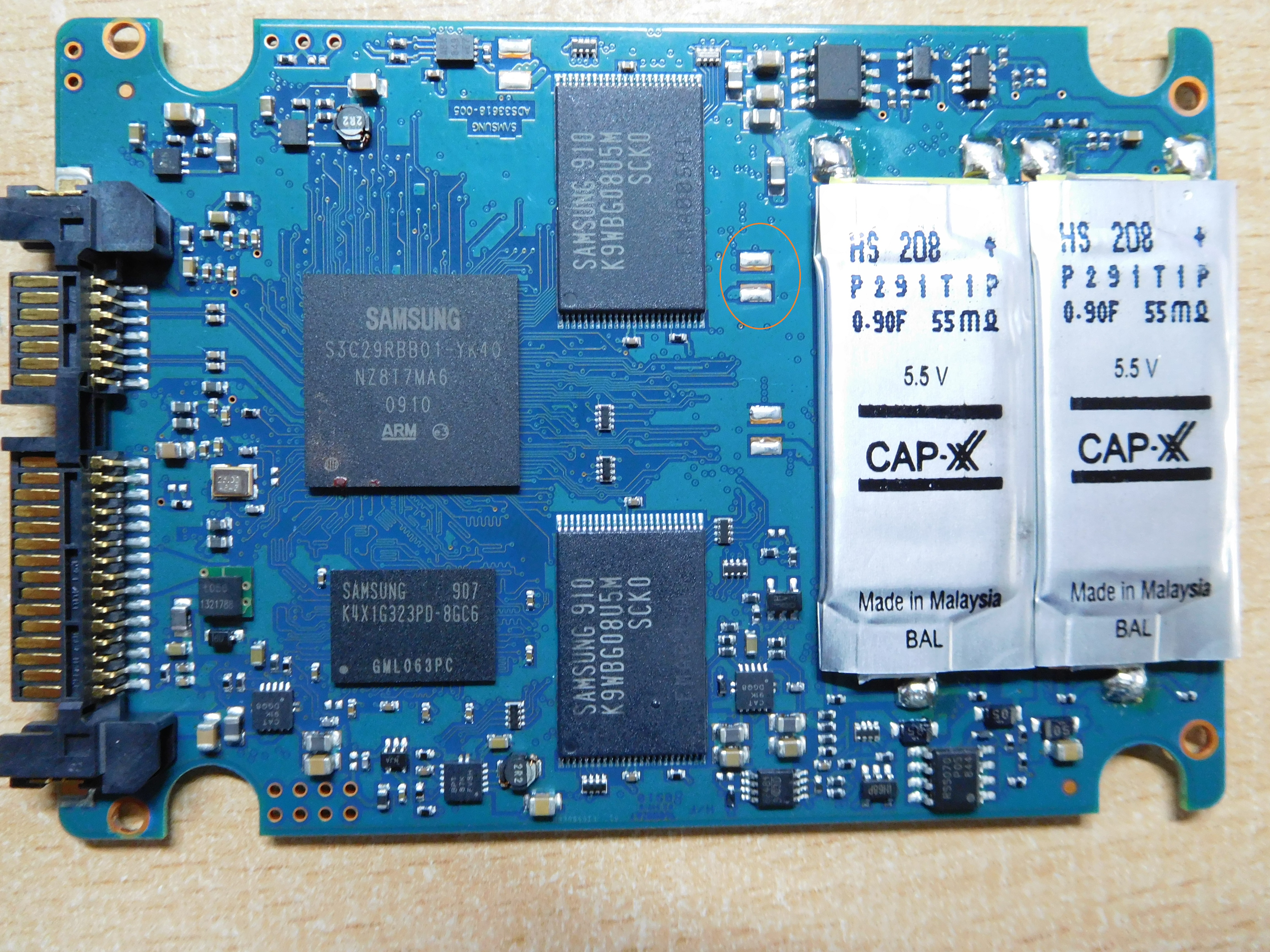

Got a Samsung MCB4E60G5MXP-0VBH3 with S3C29RBB01-YK40 controller.
It does get full ID but no sector access. As those controllers are supported via PC3000 wanted to try it. But this PCB is different than those in utility. ACELab has no expirience with such PCB's. So maybe here i'll find someone that had it. I've tested all the easily visible points.

What about shorting a NAND Ready/Busy pin to ground?

This one keeps the drive in BSY only.

Would it be safe to assume that entry into safe mode requires that a particular test point is shorted to ground? If so, then measure the voltages at all the likely candidates. They should be sitting near the Vio supply rail, most likely via an internal or external pullup resistor. Once you have identified the possible locations, measure their resistance to Vio -- it should not be 0 ohms.
You can identify the Vcore and Vio voltages by measuring the bypass capacitors under and around the controller.

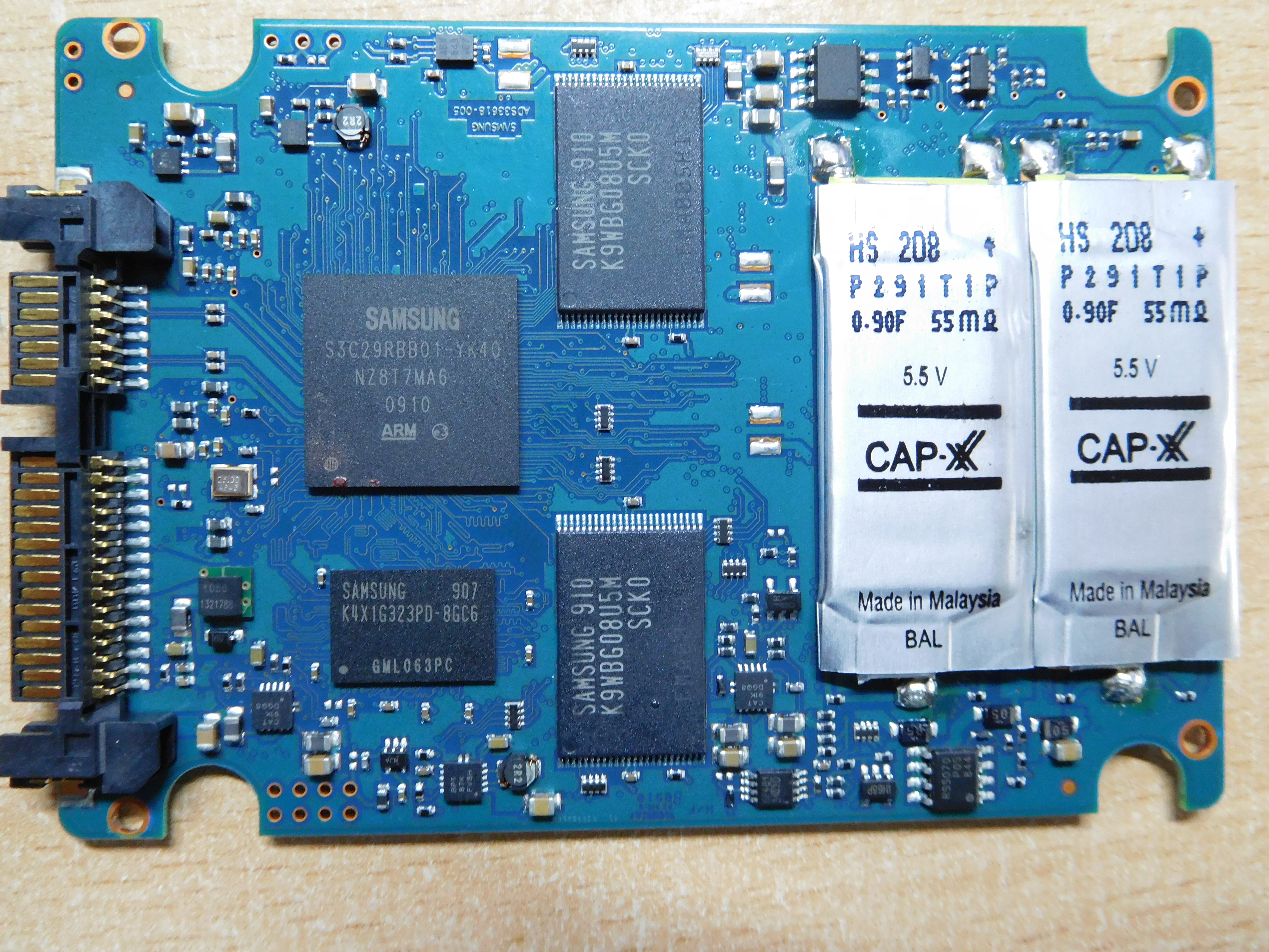

Found something that seem to give safe mode when shorted for 2 seconds. But it gives another problem with translator. Also there's info that drive is password locked.

Those look like the pads for a capacitor. It seems to me that you shorted a power supply. Why would you just short things randomly?

I'm probably wrong but this should also give safe mode. And it's on a donor.

Do you measure 3.3V between those pads? If so, they could be the NAND power supply, in which case the controller may go into safe mode because it doesn't find any NAND chips. In any case there should be a proper way to do this, eg by disabling the appropriate DC-DC converter.

Yes, those are from NAND power supply. Strange that PC3000 didn't show this but i found that:

Didn't find a proper way yet. Your scheme is understood but hard to find on the PCB.
