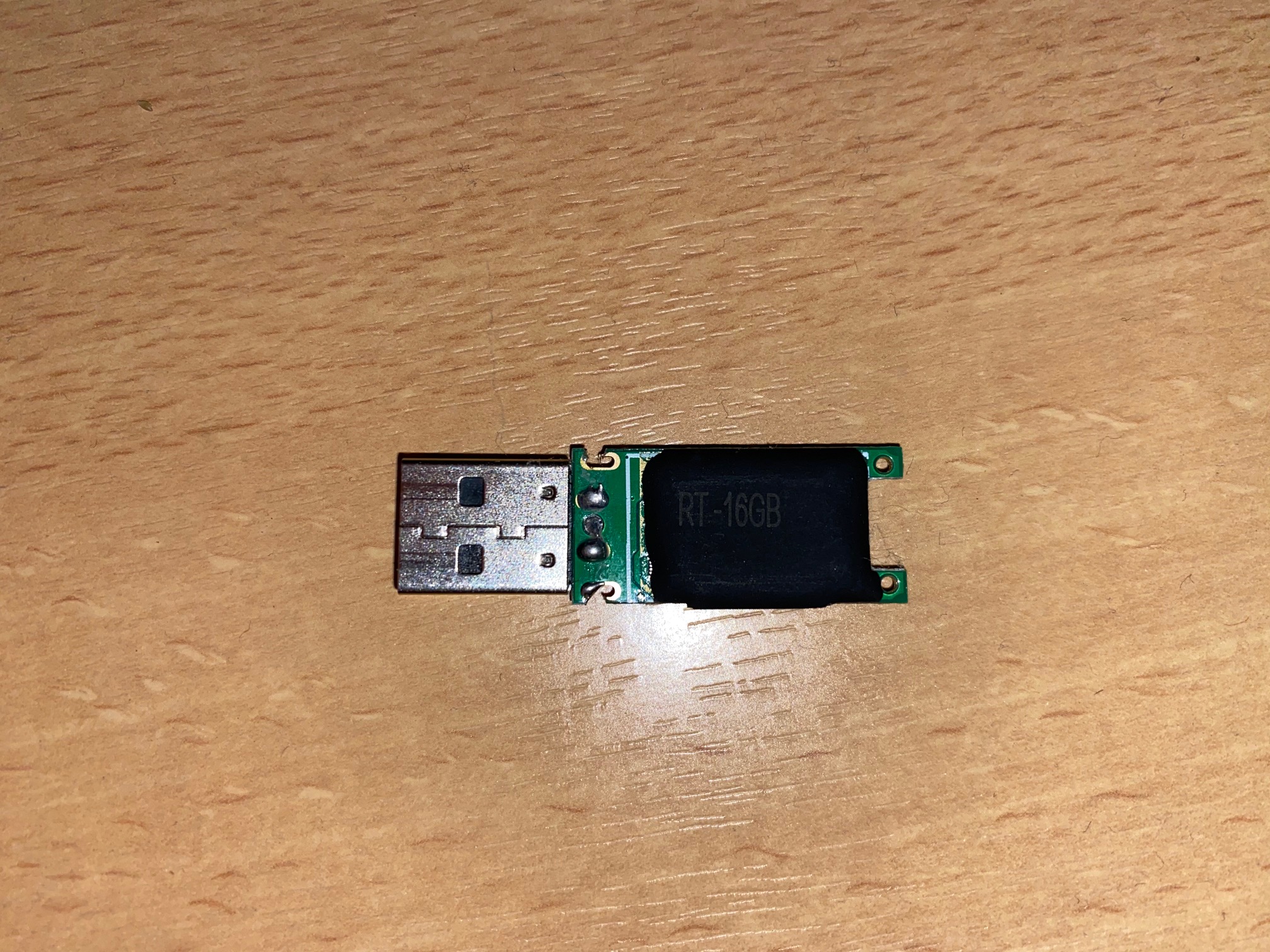

any suggestion to remove coating for chip off

There's no way to do it. Better to find pinout on the controller's side.

Controler is Chipsbank CBM2099E

Find a pinout online or discover it by yourself. Then remove the controller and read the memory. But CBMs are not easy to recover.

do you have a photo of the other side?

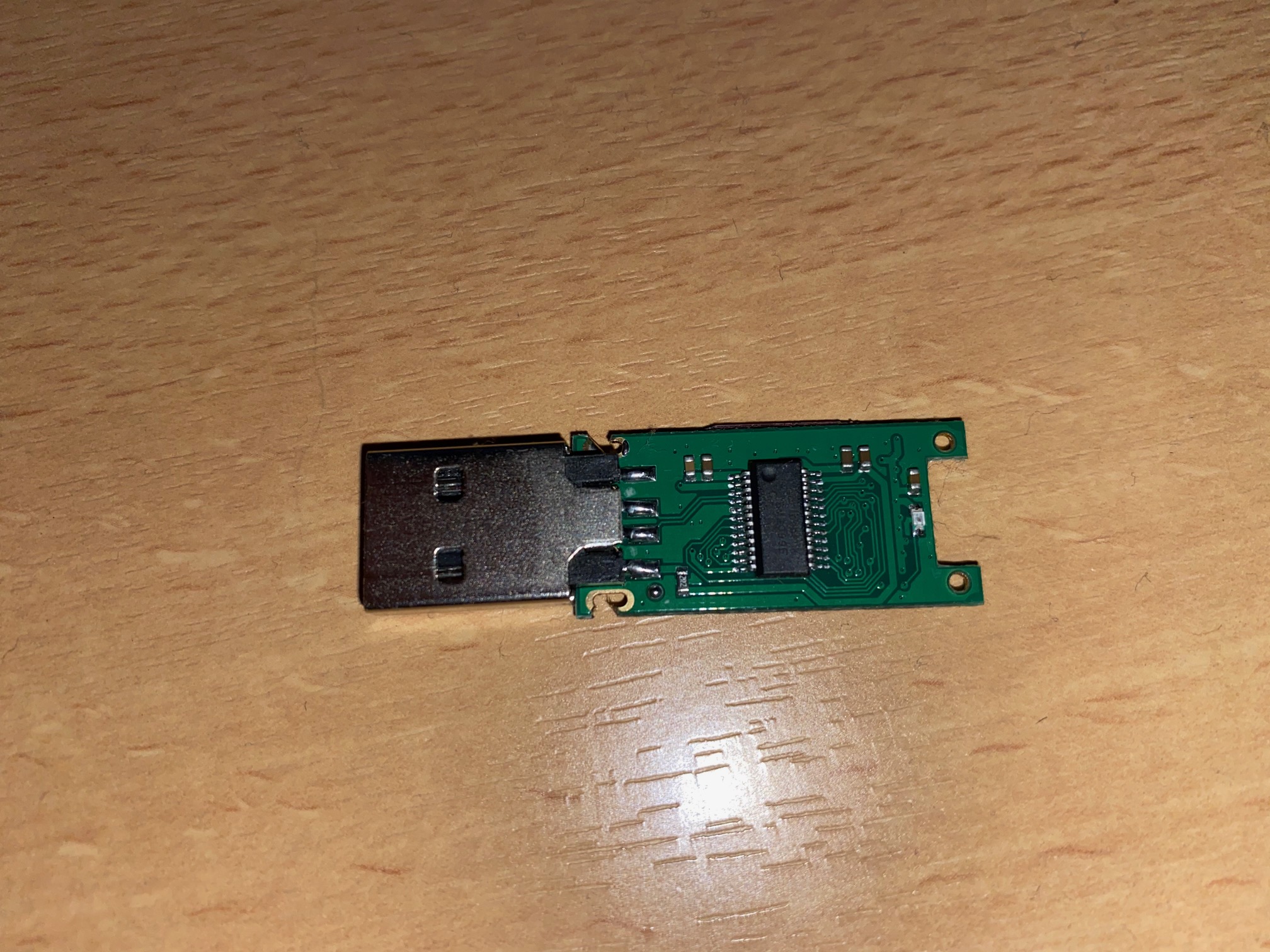

Picture of other side

Those are in Flash-extractor's database if you have it.

I had a similar device, but it had ITE5019, which has obviously different pinout, judging by the pcb traces, so i can't help with this one :(
