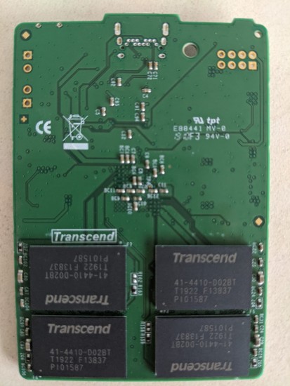

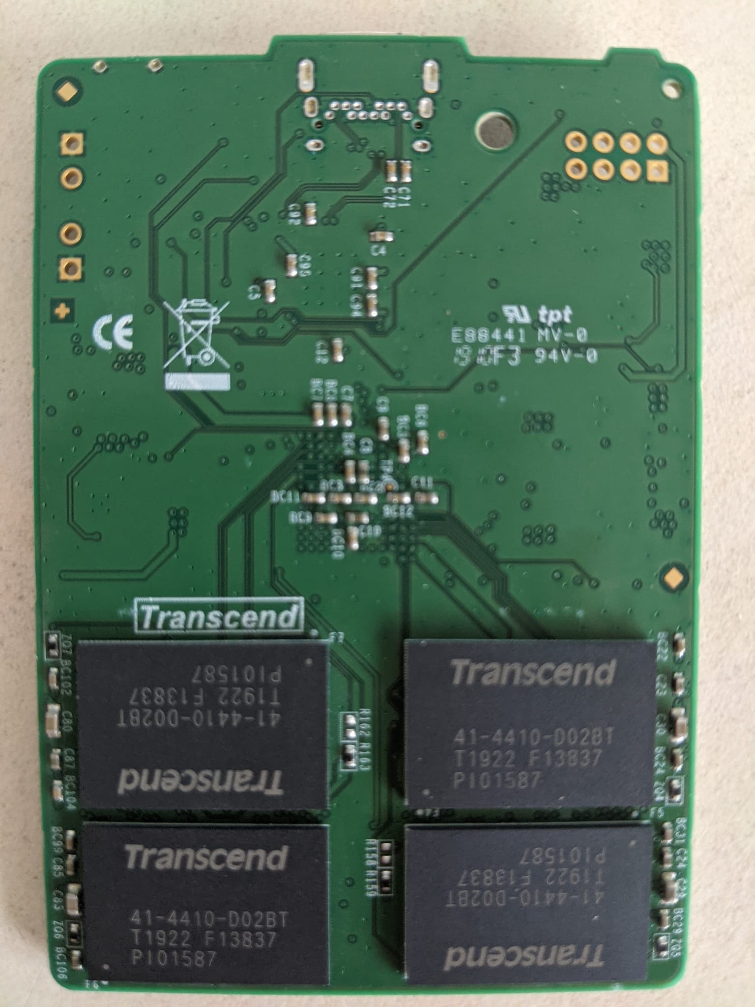

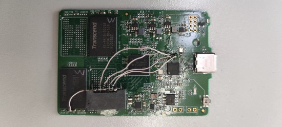

This is a USB-C SSD,never seen this one before. Any experience ? When plugged, the blue LED flash once.
when plugged to PC3K, ACT REG keep flashing red...
In the meantime, I'll start investigate.

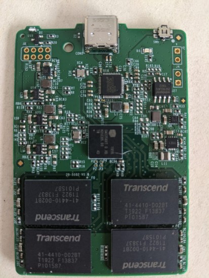

Have seen this one i think. Photos are a little blurred :)
I would hook it up via SATA and procced from there.

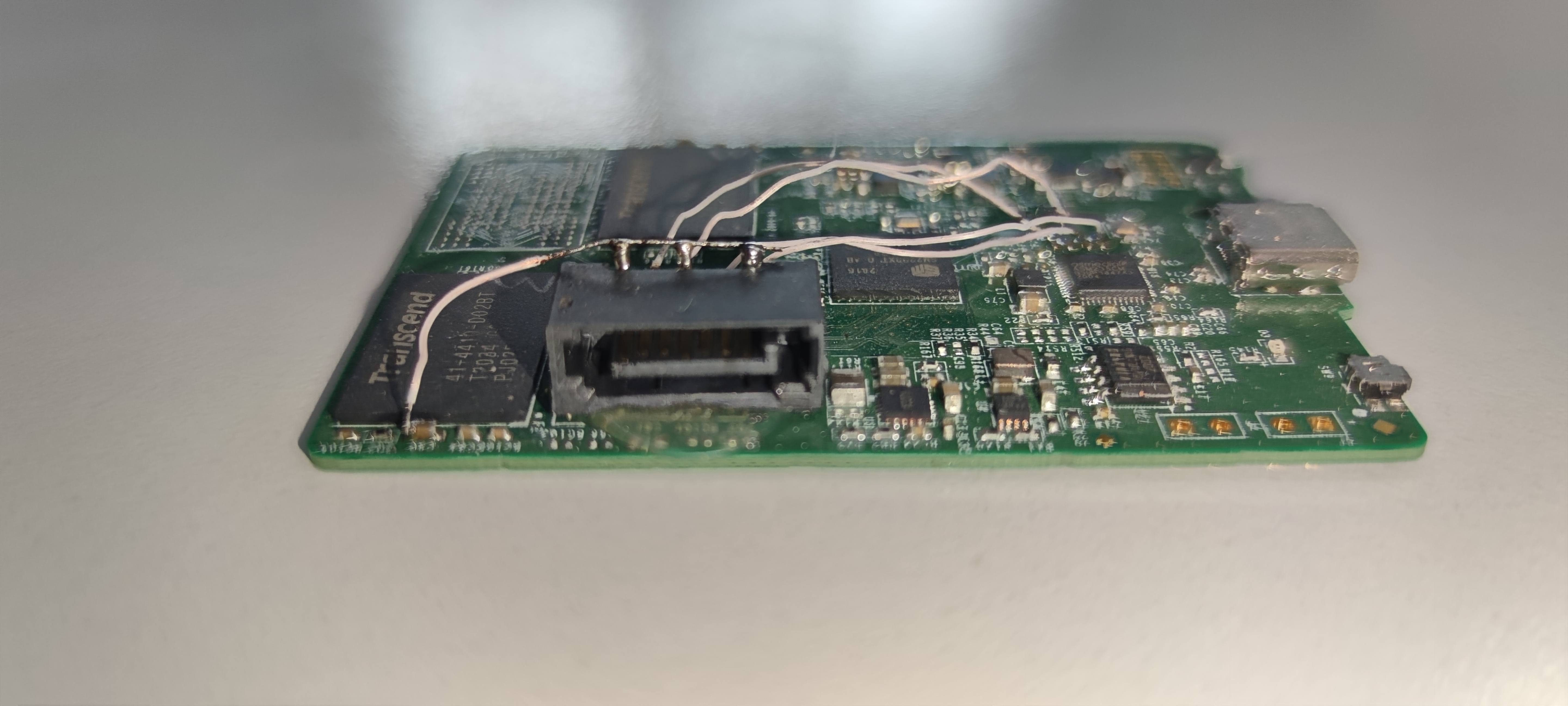

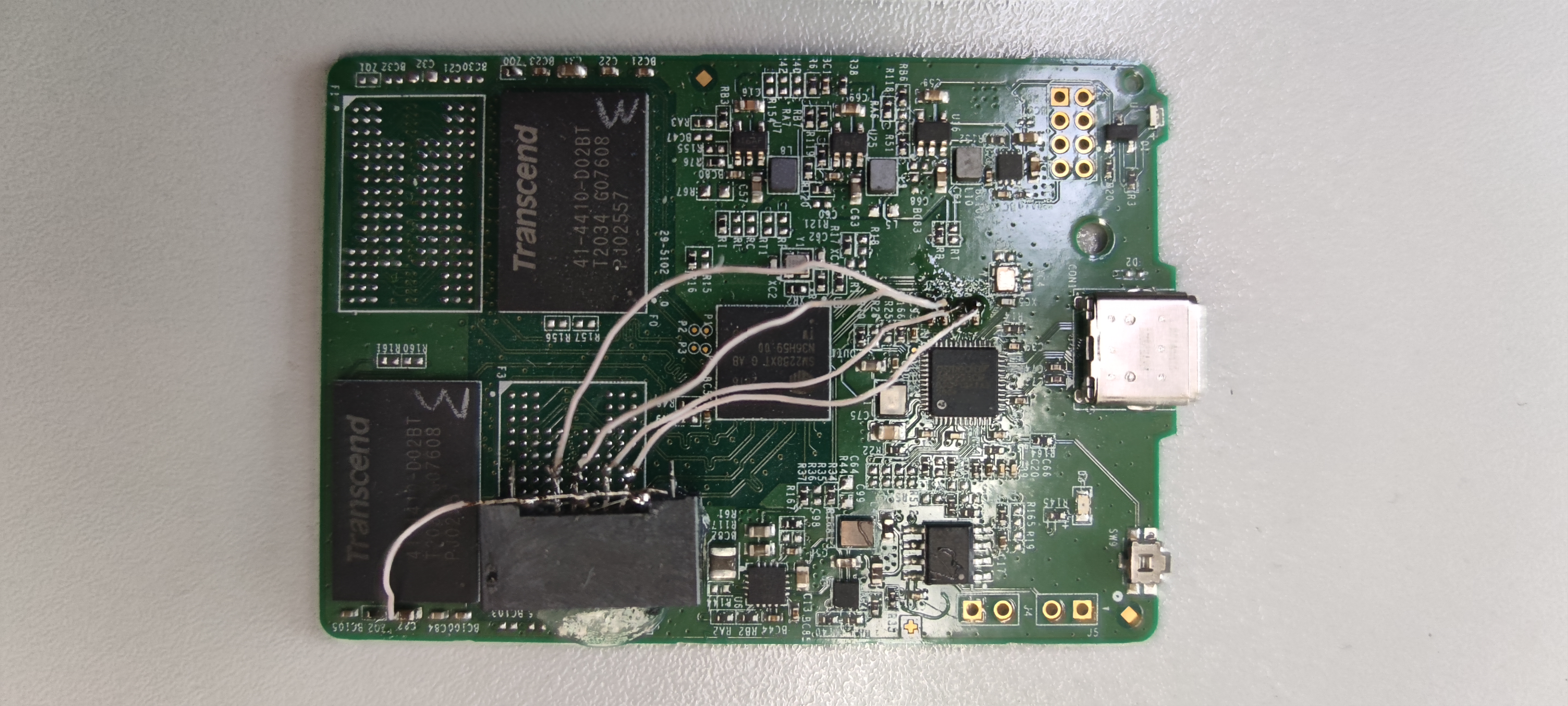

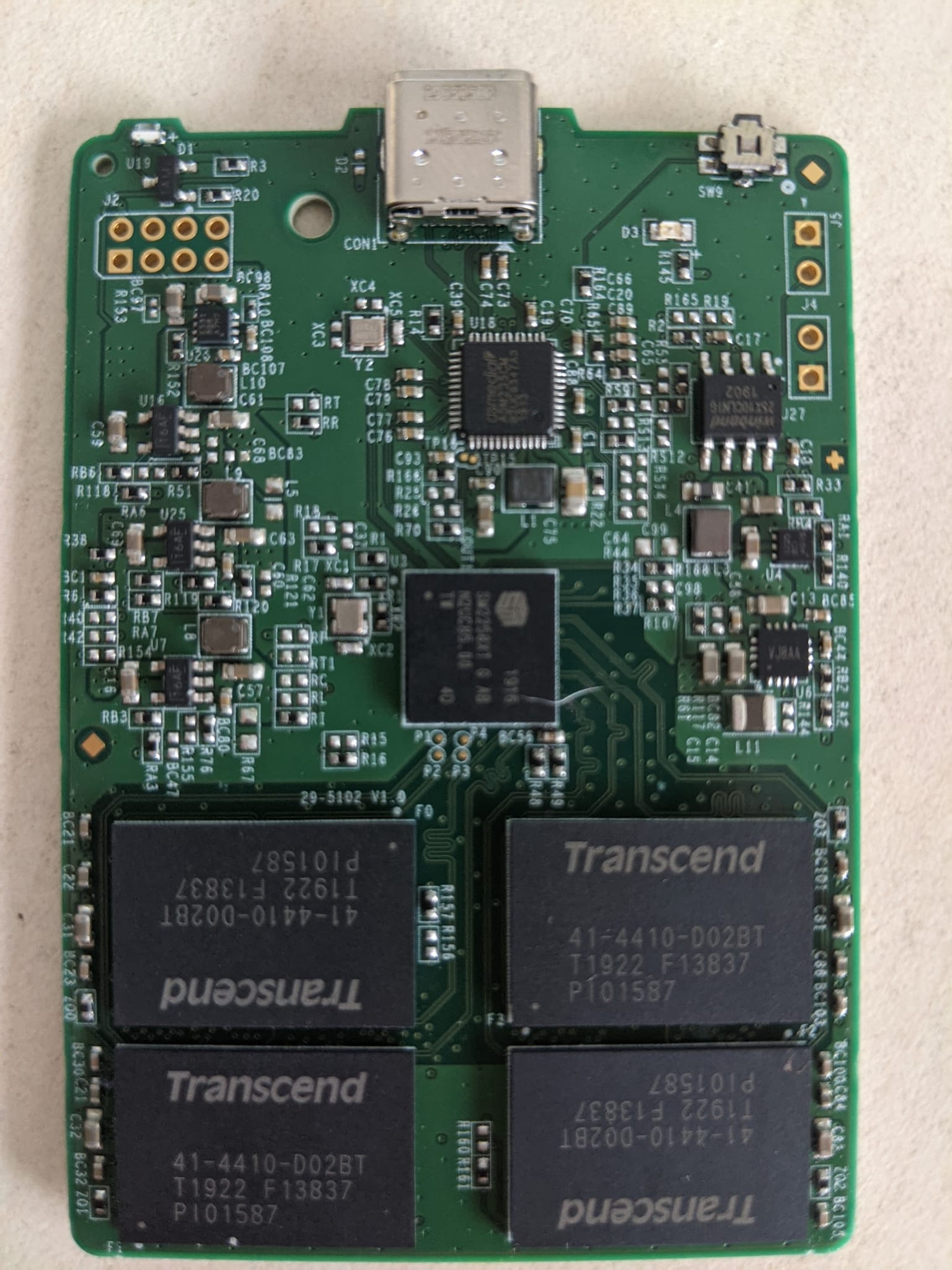

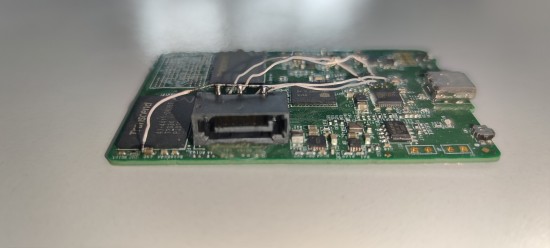

SATA connection:
You will need a PC-3000 SSD as the drive is encrypted.
