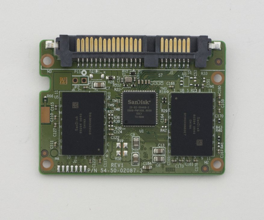

Hi
Can anybody tell me, where is the short point for safe mode on
this WD GREEN SSD
Thx

jp2 or one of the pads on the bottom left?

Is this controller supported in PC3k ?
Is it Silicon Motion?
 Post subject: Re: WD Green safe mode
PostPosted: October 14th, 2021, 10:21
Posts: 3550
No, it's a Sandisk, 20-82-00469 I suppose.
It's not supported by PC3K, but it can be recovered if NANDs are in good condition.

Yes, it could be recovered by chip-off. We do last week one with same controller.
Arvika ,
i have never tried chipoff in SSD ,Is the entire thing same to same like in typical NAND devices ,Reading Correcting ECC ,XOR ,Image building etc

Generally yes, but more complicated.
