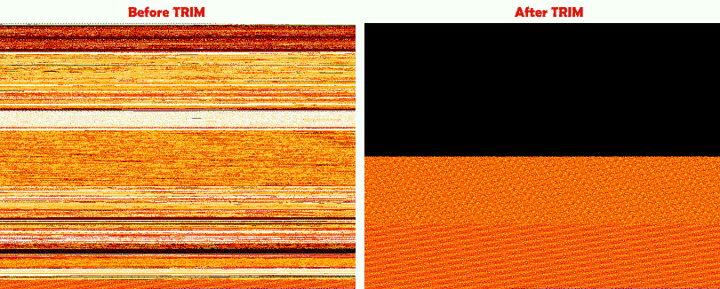

Let's not make it more difficult or mysterious than it is.. Camera can do:
Equivalent of quick format > recoverable - Majority of cases can be recovered as many camera's do a 'quick format' and nothing else. You can use DMDE, R-Studio or any file recovery tool. Using HEX viewer will see data.
Equivalent of full format aka zero fill, not recoverable - Then there's chance a camera offers 'full format', so write zeros to entire card, typically this takes time, more than a few seconds! This can not be recovered. Using hex viewer you will see zeros.
Equivalent of TRIM, recoverable by chip-off / off-chip (PC3000, VNR, FE) - Then there's specific brands/models that send SD_ERASE command which is kind of SD card equivalent of SATA TRIM. Command typically finishes this in less than 10 seconds. Sony camera's are often doing this. Using hex viewer you will see zeros or in some cases patterns as seen here (an additional SD_ERASE resulted in reading zeros everywhere). I assume the more powered-on idle time the card experiences the higher the chance blocks actually get erased and thus become unrecoverable.
File comment: entropy map before and after sd-erase

Thanks for sharing such important information . Entropy after format shows lots of original sectors are modified.

 Post subject: Re: Zero filled (camera formatted ) micro SD card recovery q
PostPosted: October 1st, 2022, 7:21
Posts: 4790
the point of trim is to free up unused areas to perform Block Erase commands on these. This probably involves relocating pages still in use in the target block, then erasing it.
After this point the block won't contain pattern or anything, just FFs, prepared for subsequent write OPs.
Trimming is probably performed in the background, so it does not complete instantly, but i think it does not take too much time to happen.
So if you find anything else than FFs (except for a low number of bit errors) in a block, it wasn't trimmed for sure (yet). It might get trimmed by the bkgnd process though, if the unit already received such command.
SD erase command is far from being equivalent to Trim, since the latter one is selective while SD erase actually erases ~all the blocks in the flash, without thinking.

Wo Thanks a ton for the information . Though FFs are not present they might appear later if trim command is already issued. Thank you for pointing out differnce between Trim and sd erase :D
