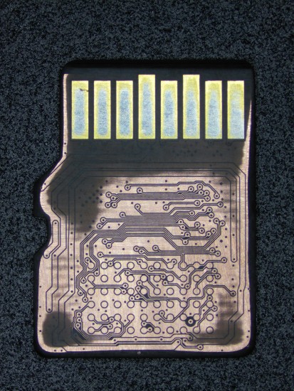

Hi i have Verbatim 32 gb micro sd card and i need pinout for it. I will try to read nand directly thru linux and same communicate with standard pads. The idea is to see and read part of memory what some application is reading PGP public key and change this public cay to other. I tested that already with normal nand and is work now i need to transfer this trick to micro sd card but i dot have pinout.

Arvika has got a lot of pinouts for monoliths.
http://www.odzyskiwanie-danych.com.pl/m ... abase.html
 Post subject: Re: Micro sd card pinout
PostPosted: October 30th, 2021, 1:38
Posts: 922
I think better choose other card. This one use LDPC and maybe encryption. Better if you use some Kingston 6x4 pinout or Sandisk 3x7 (but not all, some of them is crypted too).
