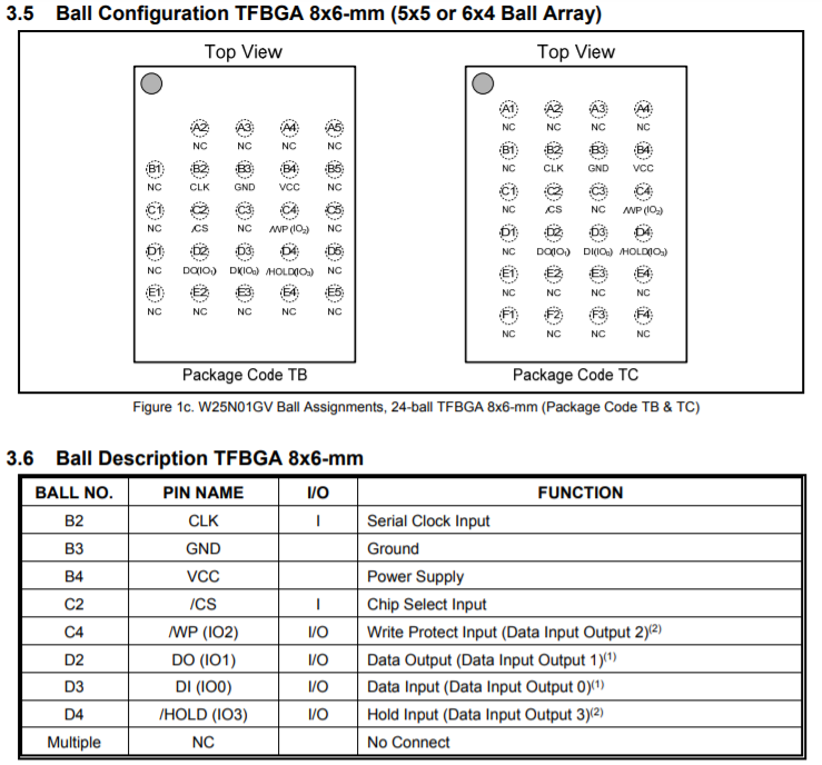

Hi all!
Got W25N01GVTBIT, NAND Flash 1G-bit Serial NAND flash.
Need data from it.
It is not in any databases of programmers. Trying to read with the closest settings - can read only 128m from 1g.
Please advise...

Sorry if this is obvious ...
1 gigabit = 128 megabyte
 Post subject: Re: Please help read the chip
PostPosted: November 28th, 2021, 20:20
Correct,
Its 1 Giga Bit Not Gigabyte So Its 128 :mrgreen:
