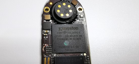

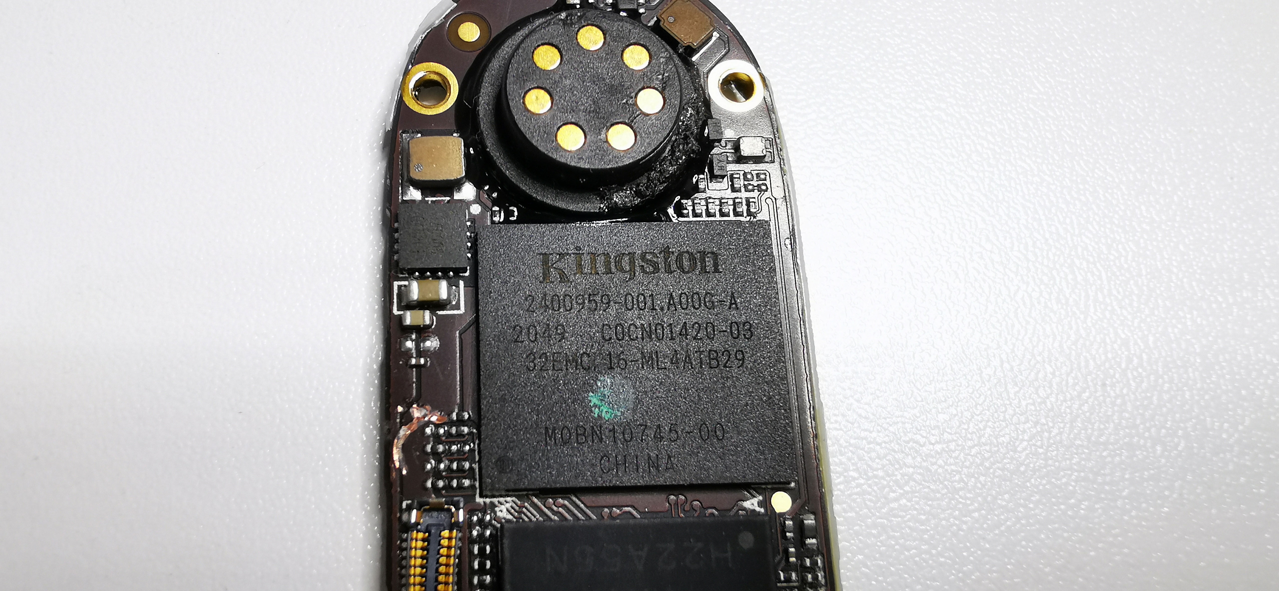

Hello guys,,,
Anyone saw this chip or can ID it?

Is this a Voice recorder ? . Might be it can be repaired ,Whats the chip like from the bottom do share very interesting
 Post subject: Re: Anyone can ID this chip?
PostPosted: November 28th, 2021, 10:16
It's a 32GB eMMC + 16Gb LPDDR4x Combined Package
You can see it listed here: https://www.kingston.com/unitedstates/u ... dded-flash
Should be fun trying to determine the pinout.

Posts: 17256
Kingston doesn't have any chips of its own. Underneath it's probably a Samsung KM4X6001KM-B321.
https://www.samsung.com/semiconductor/mcp/KM4X6001KM-B321/
https://fccid.io/O57TBX306X/Letter/Declarationa-Letter-4798942.pdf

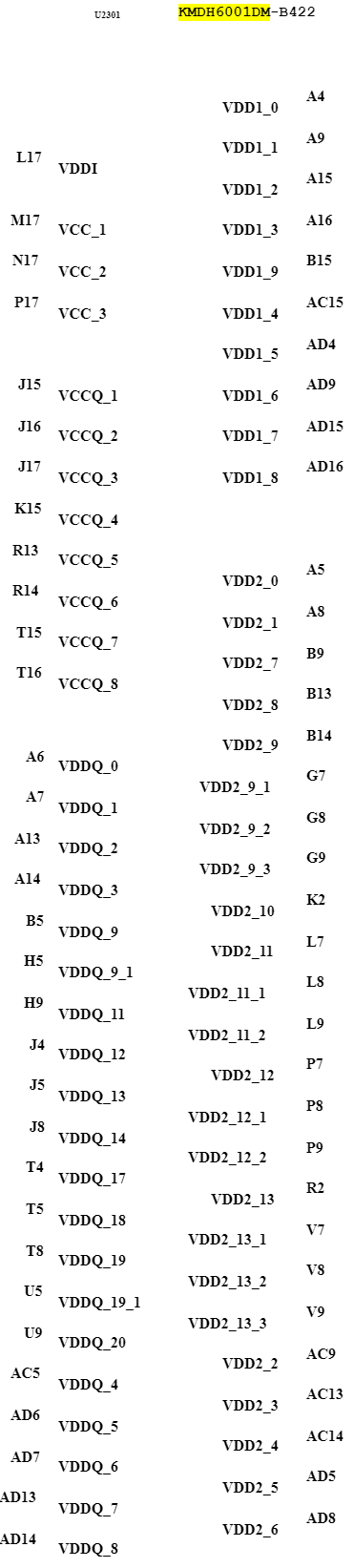

Compatible chips (with same pinout)?
H9HP53AECMMDAR-KMM
H9HP53AECMADAR-KEM
H9HP53ACPMMDAR-KMM
H9HP19ABKMMDAR-KMM
H9HP52ACPMMDAR-KMM
KMDX60018M-B425
KMDP60018M-B425
KM4X6001KM-B321
KMDX6001DM-B422
KMDV6001DM-B620
KMDH6001DM-B422
KMDH6001DA-B422
KMDD6001DM-B320
KMDD60018M-B320
KM3V6001CM-B705
KM3H6001CM-B515
KM3H6001CA-B515
H9HP52AECMMDAR-KMM
H9HP52ACPMADAR-KMM
H9HP27ACPMMDAR-KMM
H9HP16AECMMDAR-KMM
H9HP16ACPMMDAR-KMM

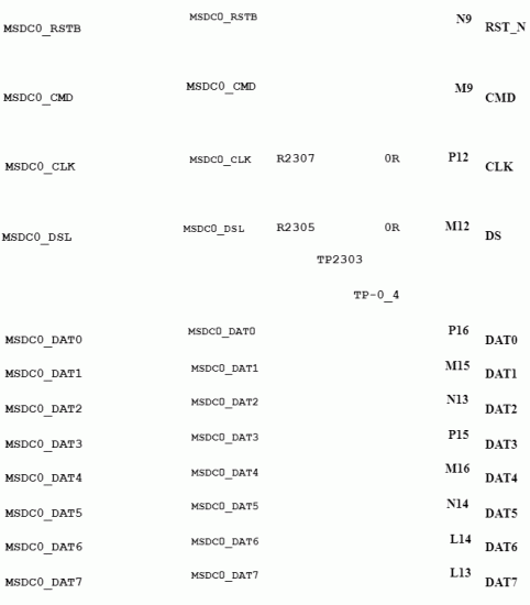

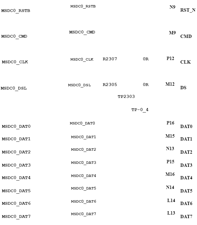

N9 - RST_N
M9 - CMD
P12 - CLK
M12 - DS
P16 - DAT0
M15 - DAT1
N13 - DAT2
P15 - DAT3
M16 - DAT4
N14 - DAT5
L14 - DAT6
L13 - DAT7
The link to this Android schematic is dead ...
http://www.henxtec.cn/Android/pdf2016/2019-10-1/OPPO%E5%85%A8%E7%B3%BB%E5%88%97%E5%8E%9F%E5%8E%82%E7%BB%B4%E4%BF%AE%E5%9B%BE%E7%BA%B8/OPPOR15%E6%A0%87%E5%87%86%E7%89%88%E5%8E%9F%E5%8E%82%E7%BB%B4%E4%BF%AE%E5%9B%BE%E7%BA%B8/R15%E6%A0%87%E5%87%86%E7%89%88%20%20%E5%8E%9F%E7%90%86%E5%9B%BE%20%E7%94%B5%E8%B7%AF%E5%9B%BE.pdf
... but the cached versions are still available:
https://webcache.googleusercontent.com/search?strip=0&q=cache:http%3A%2F%2Fwww.henxtec.cn%2FAndroid%2Fpdf2016%2F2019-10-1%2FOPPO%25E5%2585%25A8%25E7%25B3%25BB%25E5%2588%2597%25E5%258E%259F%25E5%258E%2582%25E7%25BB%25B4%25E4%25BF%25AE%25E5%259B%25BE%25E7%25BA%25B8%2FOPPOR15%25E6%25A0%2587%25E5%2587%2586%25E7%2589%2588%25E5%258E%259F%25E5%258E%2582%25E7%25BB%25B4%25E4%25BF%25AE%25E5%259B%25BE%25E7%25BA%25B8%2FR15%25E6%25A0%2587%25E5%2587%2586%25E7%2589%2588%2520%2520%25E5%258E%259F%25E7%2590%2586%25E5%259B%25BE%2520%25E7%2594%25B5%25E8%25B7%25AF%25E5%259B%25BE.pdf

The following schematic has the ballout (page 5).
DT02_S_2.0_20200812.pdf [1.34 MiB]
Downloaded 496 times

By the way, just for the record, this is from the Action CAM (Insta360 GO 2) ---> Forensic case (accident)
Thank you all for your help here again :-D
