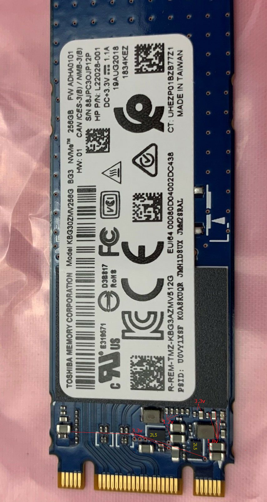

I have Toshiba 256GB M2 Toshiba SSD kbg30zmv256g.
The hdd is not detected. Behavior like NO hdd is connected with pc3k or like the power failure hdd.
I have tried to found faulty components and created the output voltage diagram.
Attached the image of m2 sata. How to recover the data?
Thanks,
File comment: Voltage output Toshiba SSD kbg30zmv256g.

Google tells me that this is an NVMe SSD. Does PC3000 support NVMe now?

I have m2 to sata converter.
So I have used the sata converter and checked on pc3000. but not shown any led like busy, drd, dsc.
also I have used working m2 drive with this connector. it detects and shows drd, dsc enable.
Thanks,

yes You are right.
I have B+M key socket 2(sata) m2 NGFF SSD converter. Due to same type of pin slot I have checked the NVMe on this adapter.
Now I have used the nvme supported motherboard. It detects in bios. but not found in windows10. Device manager shows dirver missing "Standard NVMe controller"
Thanks.

thinclient wrote:
yes You are right.
Thanks.
So you have updated BIOS and installed newest drivers for mainboard?

thinclient wrote:
yes You are right.
Thanks.
coz its controller is gone crazy, same scenario with SSD with BSY
chip-off is a must with high pro. tools (VNR helps a lot here)

HaQue wrote:
thinclient wrote:
yes You are right.
Thanks.
What happens now?
Toshiba online site shows it use the microsoft default nvme driver. no need of any extra driver.
I have checked the system with other working adata drive. it detected in windows.
Searching solution. I doubt in the Toshiba nvme controller. but no separate controller found in this drive.

I don't know.. what is the controller? Is there any chips on the other side? I don't think so.. so a single chip? If so must be a BGA SSD, and I am unsure of if these have been recovered by any tools yet.
The XG5 is also the first SSD from Toshiba to leverage the company’s 64-layer BiCS 3D flash memory (TLC) which delivers the highest layer count in the market.
Newer XG6-P have 96layer BiCS Flash! Are these chips supported in our flash tools?
I would be interested in a picture of the drive without the sticker (even though I think this picture is not of the real patient, but a stock picture from ebay)
BTW, it says NVMe right on the label...
Also, in regards to the label.. does "R-REM-TMZ-KBG3AZMV512G" mean that this is a refurbished 512G SED drive? I think the "0" in "kbg30zmv256g" means not SED and the "A" in "KBG3AZMV512G" denotes a SED drive

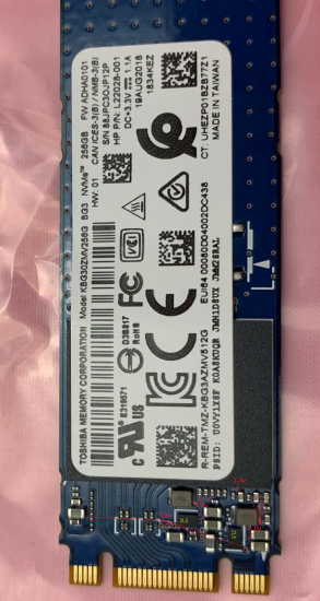

Hello all,
I've just received one of these this afternoon. The BGA chip is marked with:
Toshiba KBG30ZPZ256G
18109AE TWN SG1386
It looks like it is the BG3 64-layer package. Specs at: https://business.toshiba-memory.com/en- ... d/bg3.html
The failed SSD I have in gets a hot BGA chip when powered.
John
