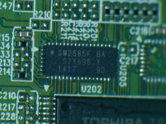

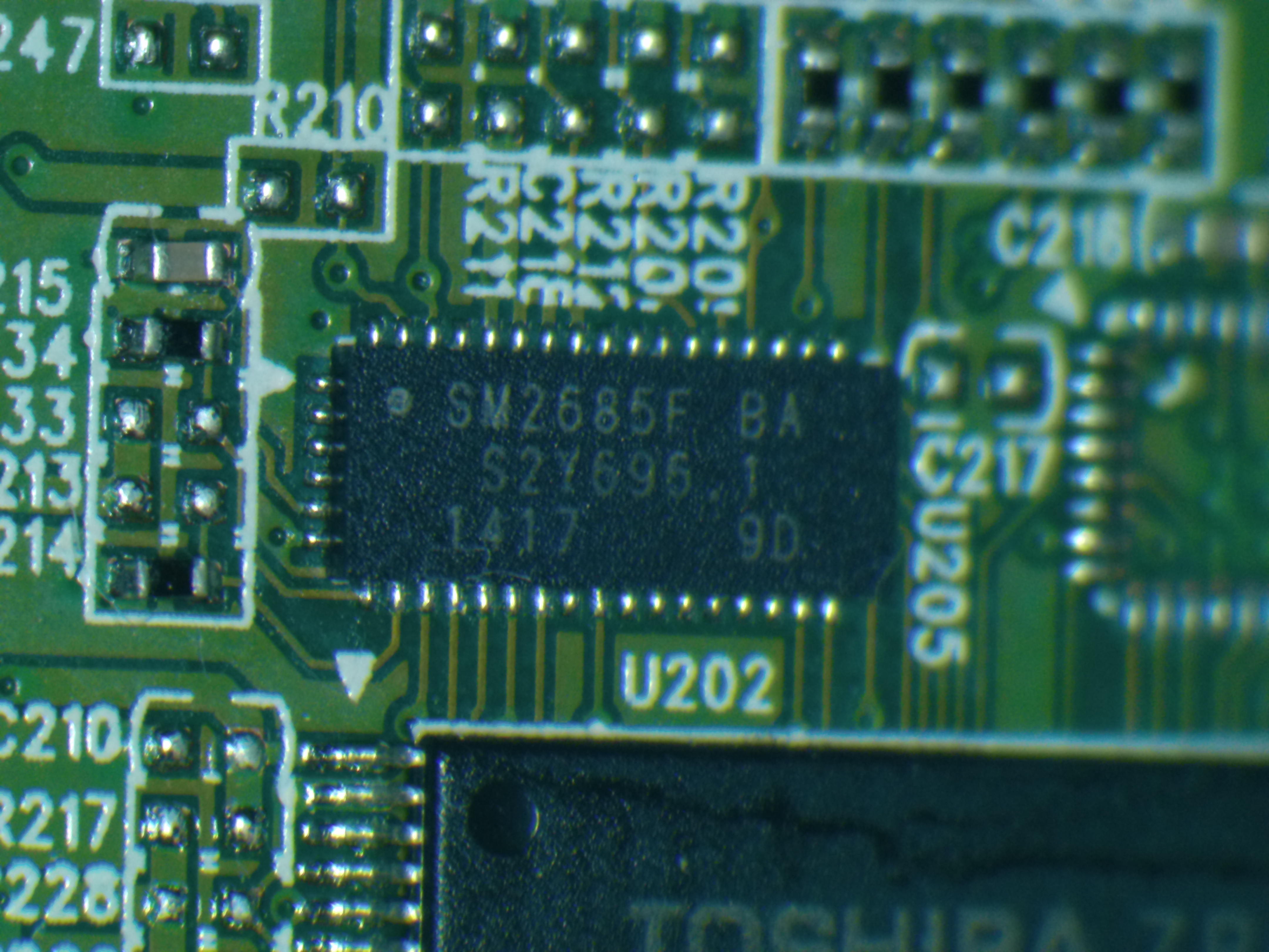

This is a picture of the IC on the board of the cheap MP3 Player I was given.

This controller has an SD card interface. If we can see the whole PCB, perhaps we may be able to identify the SD pins.

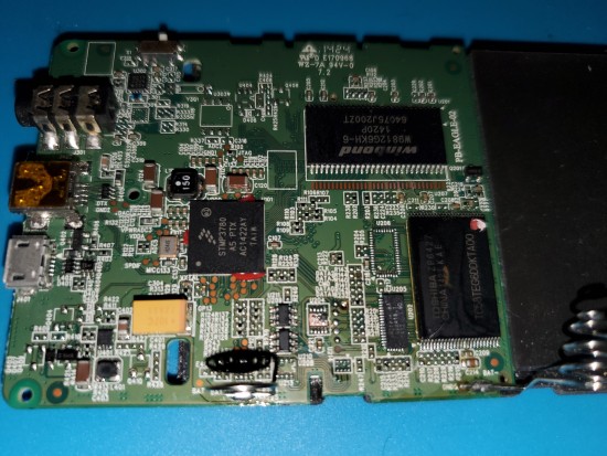

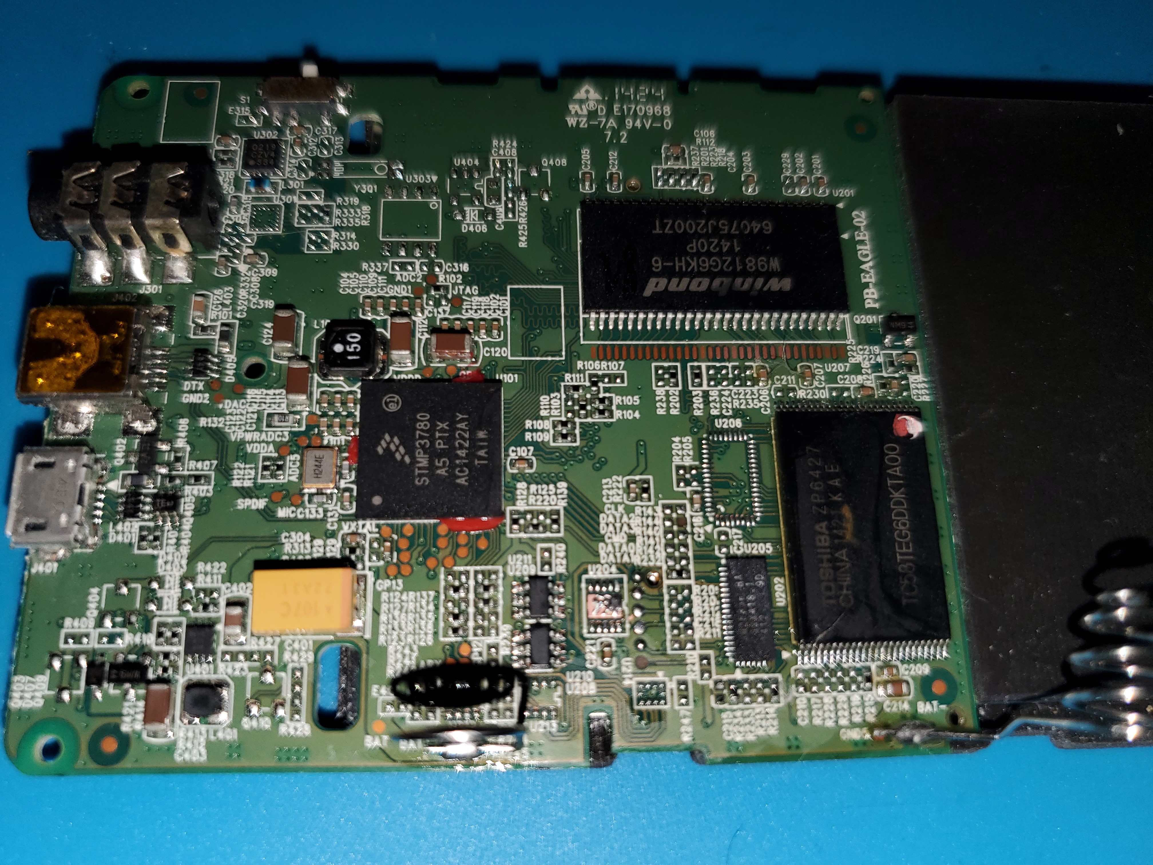

I performed a chip-off NAND dump with my T56 programmer. The player does not allow me to connect to the SD Card interface while the controller and memory are on the player, at least not that I know how to. I get what appears to be a valid dump, as I get no errors on the verify, and it is not filled with repeating characters like a bad dump commonly contains.

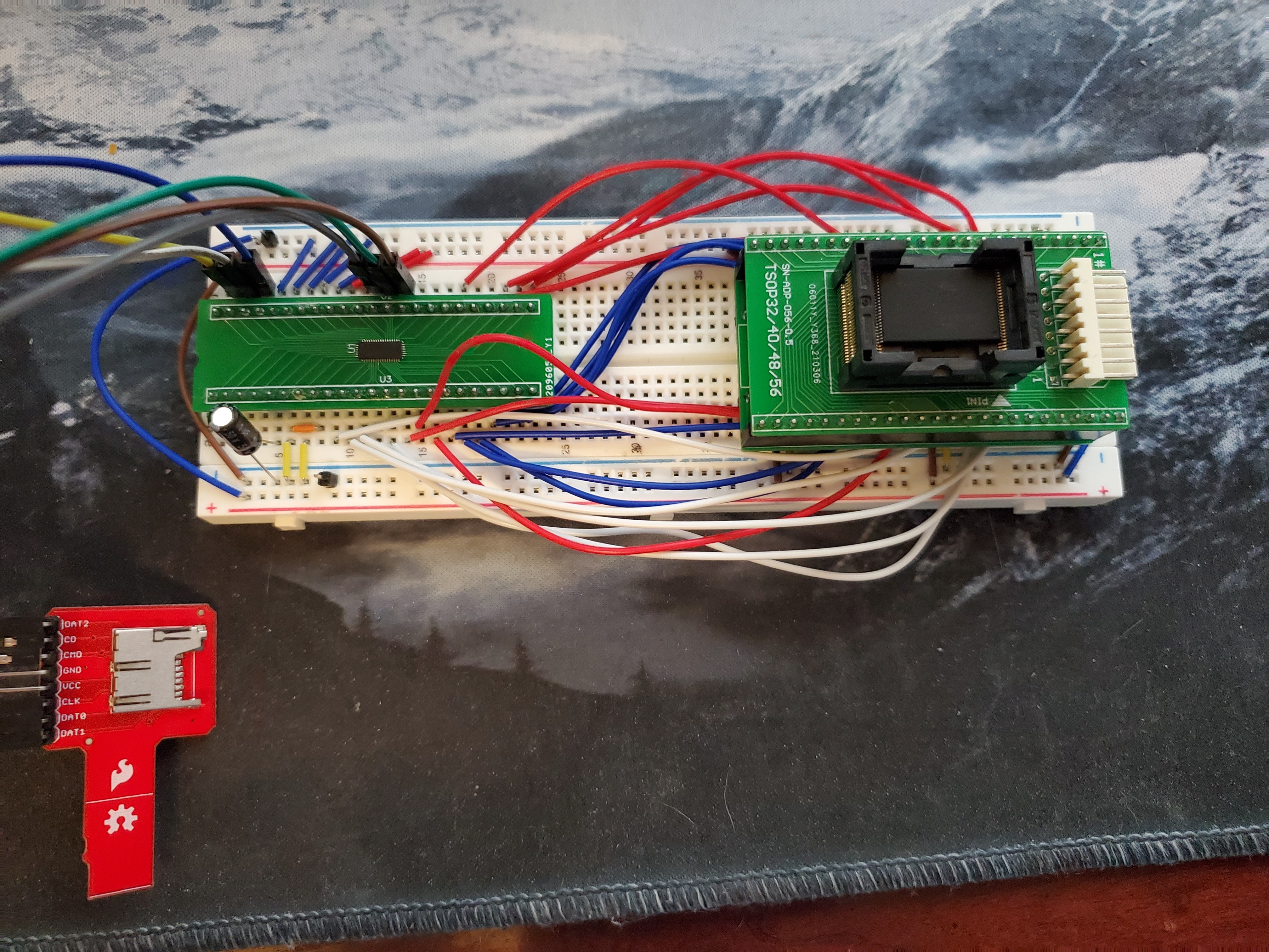

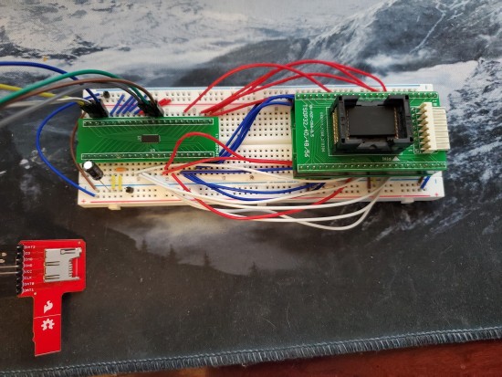

I pulled the Controller and the NAND from one of the players I have, and tried to use the controller to read the NAND off board, but I have poor quality prototyping equipment, so the connections are not stable. I am waiting on some perfboard to prototype the setup correctly, to see if I can get a good read. I have a feeling that there is more to the setup than just the controller and the NAND. It is possible that there is some secure communication or interface logic between the Controller and the Processor in the MP3 Player, that I am unaware of.
Later versions of the player used an EN2685F populated in a different spot on the board for the controller. It does not appear to be a drop in replacement (The spot above the SM2685F).

Try to dump the NAND via SD after disabling the crystal for the STMP3780 chip.
I can see two coils. They would be parts of two step-down buck converters.
