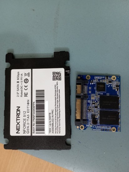

This SSD is hardly 2-3 months old , lower grade nand chips might be the reason of early degradation (though 500 TBW is been given) . Here is snap of the SSD

The MAS0902A is the most data recovery practitioner-friendly of the cheap controllers in my opinion, and most of the time, damaged drives allow you to access logical sectors. Instead of fatal firmware corruption. Although PC3000 SSD does not support it yet, most cases can be restored by DE clone

yes we tried to reverse clone in DE ,but controller restarts continuously so couldn't succeed.

Can you adjust the NAND Vcc in-circuit?
In-circuit recovery of SSDs with "weak" NAND:
http://www.hddoracle.com/viewtopic.php?f=106&t=2740

What a comprehsive R & D done by fzabkar , appreciate your technical expertise. I am doubtful we will be able to make changes in voltage due to insufficient experise in electronics. :good: :-D
