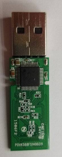

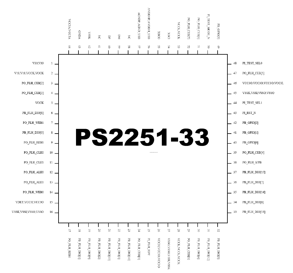

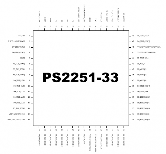

I have an Imation flash drive with a PS2251-68-5 controller and eMMC169 chip. The controller has a hole burned out the middle. The nearest pinout I could find for this controller is for the PS2251-33. Does anyone have the correct pinout, or know if the picture attached would be the same?

I don't see any eMMC pins in the PS2251-33 pinout diagram.

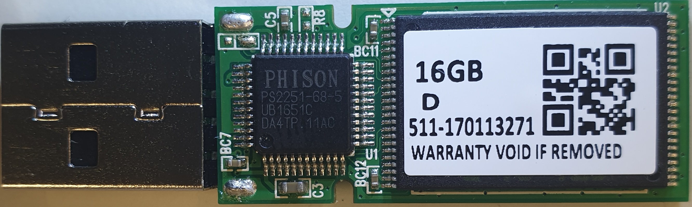

There wouldn't be, the controller uses NAND. The controller pins would go to the chips other raw NAND pads, not typically shown in the datasheet.

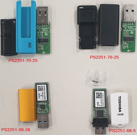

Tim, just find another 2251-68-5 drive with a TSOP. then work backwards on that drive to find pinout of controller. These drives are very common in verbatim, Toshiba, emtec etc.
case in point, I bought my weekly test drives yesterday and out of 4, all were Phison, and one was a 68-5.
I don't have a DMM here with me, and tonight and the weekend is nuts but I could trace one for you by Monday if it helps
edit,
you may get some hints on which pads, (but not the order) by looking at the pics from bolo and their adapters!

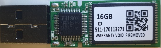

Am I blind, or does the Toshiba flash drive consist of a 28-pin controller and 24-pin flash IC?
 Post subject: Re: PS2251-68-5 Pinout
PostPosted: September 13th, 2019, 2:09
Posts: 4001
If you were blind, you wouldn't even see that! sorry :-)
no it does appear like that, but because I reduced the quality of the picture and it is blurring the pins.
here is a better picture of that one.

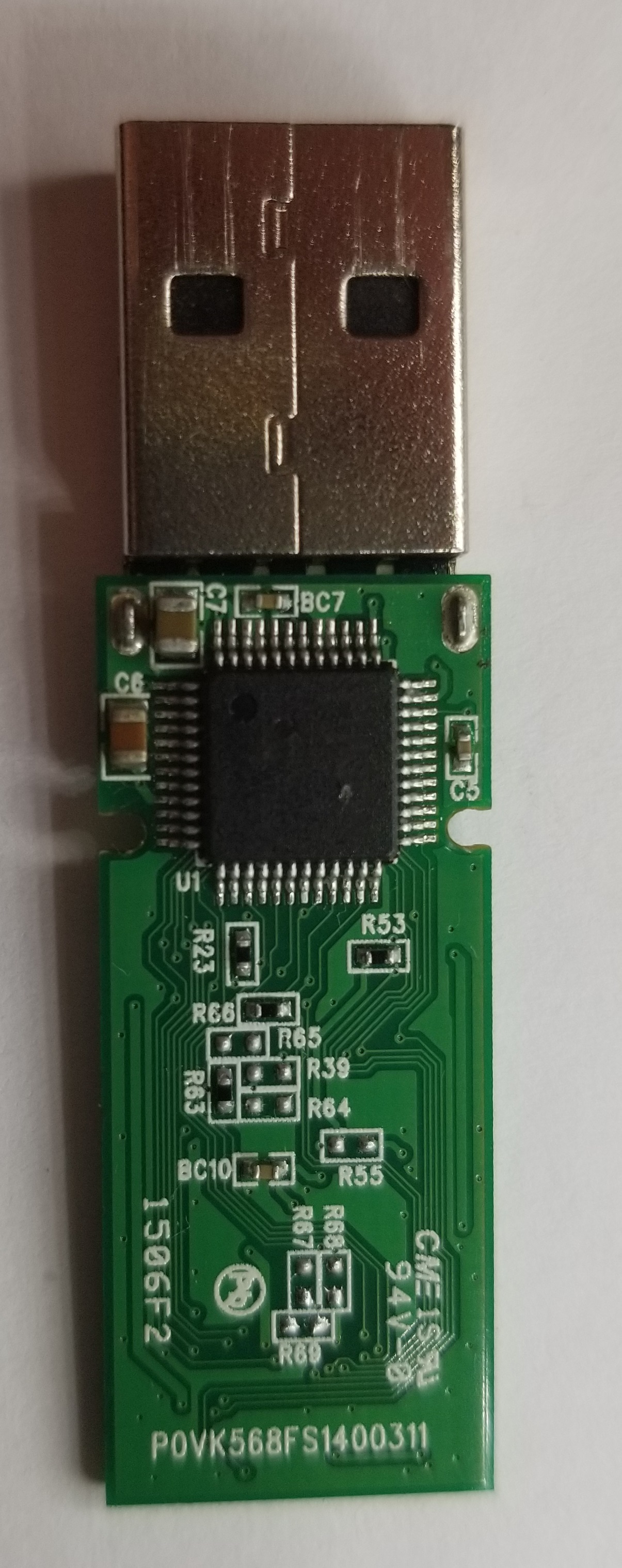

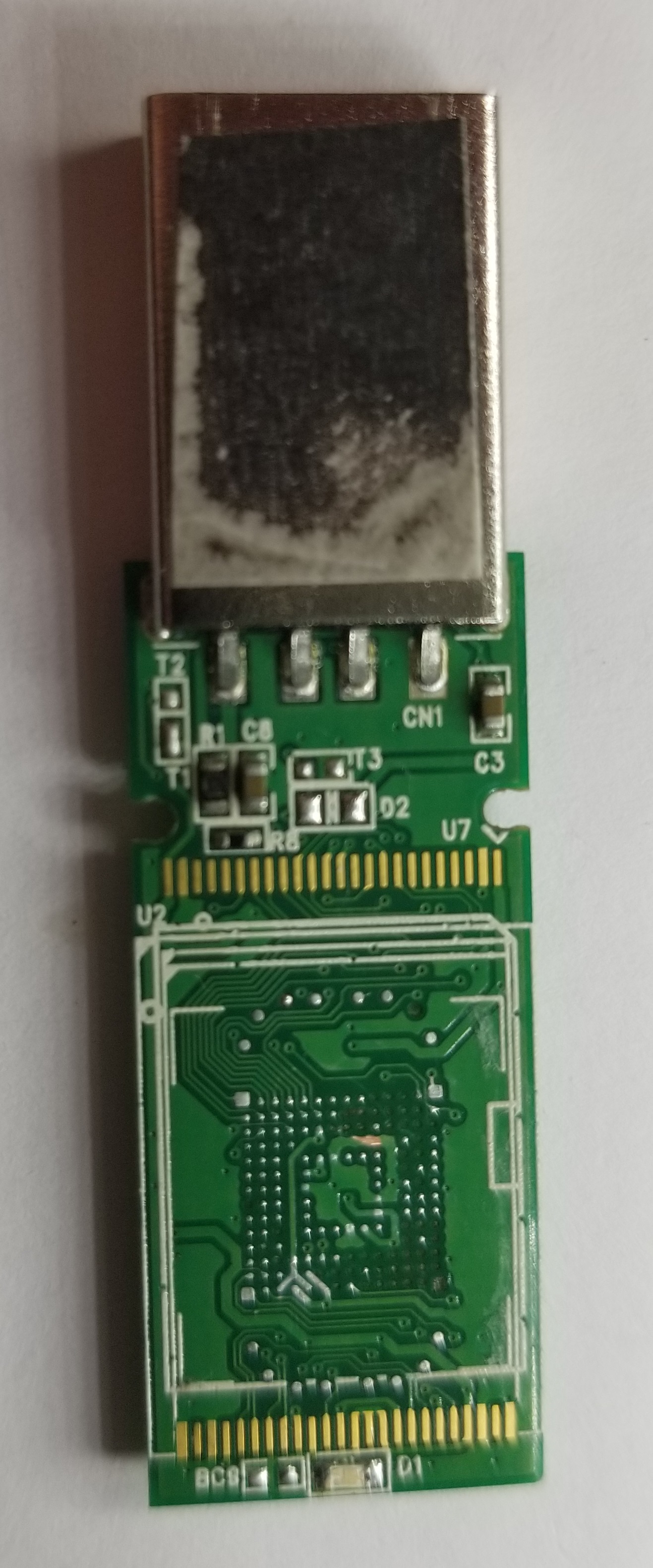

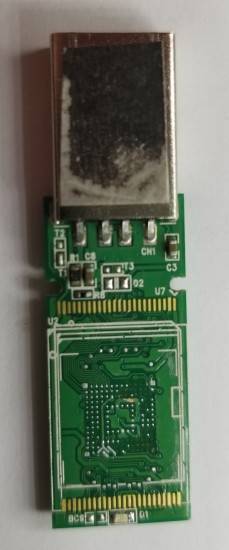

For completeness here is the PCB.
Brian, this particular board also has TSOP connections which will make the job easier. I presume a donor controller in this case may also work. I will try both and get back to you.

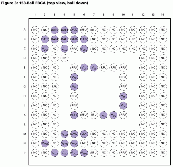

Well, the PS2251-33 has 64 pins while the PS2251-68-5 has 48 ...

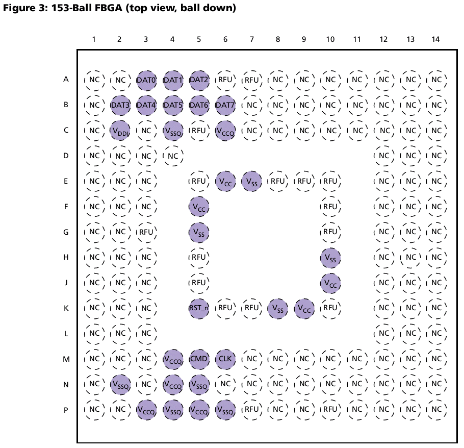

You haven't identified the flash IC, but the BGA balls do appear to match an eMMC BGA-153 pinout. Does this mean that the controller can be configured to handle either eMMC or regular NAND flash?
You are correct. I did say it was the nearest I could find at the time, but should have looked at the number of pins for a more accurate representation.
I didn't see the need to identify the eMMC chip as we do not know the pinout. The pinout for the BGA-153 and BGA-169 have the same pinout. However the pinout you have supplied is via the eMMC controller, we are after the pinout to the eMMC NAND :wink:

Because the external flash controller bypasses the internal eMMC controller and routes directly into the eMMC NAND. So the only way to get the NAND pinout is via the flash controller. Or am I not understanding your question?

Can we assume that the TSOP-48 pads reflect a standard ONFI pinout, as in HaQue's example?
PostPosted: September 14th, 2019, 4:15
Posts: 922
ddrecovery, why do not trace from TSOP48 pads to pads for eMMC chip? It is 10 minutes work maximum, and you will get the pinout. You not need controller pinout.
PostPosted: September 14th, 2019, 4:29
Posts: 17323
I was thinking the same thing, but how can we be certain that the TSOP-48 pinout is standard ONFI? In fact, if we knew that the pinout was standard, then there would have been no reason to remove the chip.
PostPosted: September 14th, 2019, 4:57
Posts: 922
fzabkar, from my experience for about 10 years I meet only three cases that TOSP48 have other pinout than standard. Anyway, it is easy to check.
