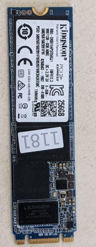

 Post subject: SSD Kingston 256GB SNS8154P3/256GJ, Phison PS5008
PostPosted: July 21st, 2021, 7:52
Posts: 191
Location: Switzerland
Could not find anything regarding this device on forum and google.
PCIe SSD is not detected at all. It was in laptop and stopped to work suddenly. If anyone has experience with those. Maybe the two holes are for safe mode ?
Nothing get super hot. Controller is warm, all looks normal.
Claude
 Post subject: Re: SSD Kingston 256GB SNS8154P3/256GJ, Phison PS5008
PostPosted: July 21st, 2021, 8:06
I see it is supported by PC3000 Portable III. Assuming that it is a firmware related issue, you aren't going to get anywhere without it. You are welcome to sub it to me, but I'm sure that there are closer options.

one options is to buy PC-3000 Portable but it's damn expensive.
PostPosted: July 21st, 2021, 9:27
Posts: 4848
Nikola has it...
PostPosted: July 21st, 2021, 14:34
Posts: 922
We have it too. PS5005 is also supported by FE and VNR. So if PS5008 is not crypted it should be supported too by chip-off.

I got another drive like this, it was in Acer PC.
Now I got PC-3000 Portable and I could clone it.
