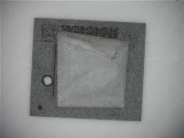

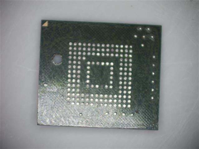

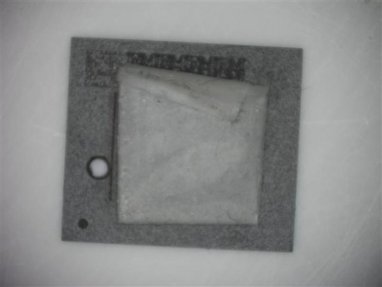

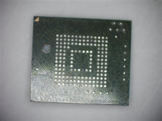

Yeah, in case anyone else gets this POS.
And yes, that's a hole in the eMMC. If anyone cares the controller (eMMC - DOA) is dead. Guess why /joke.
Typical promo stick crap.

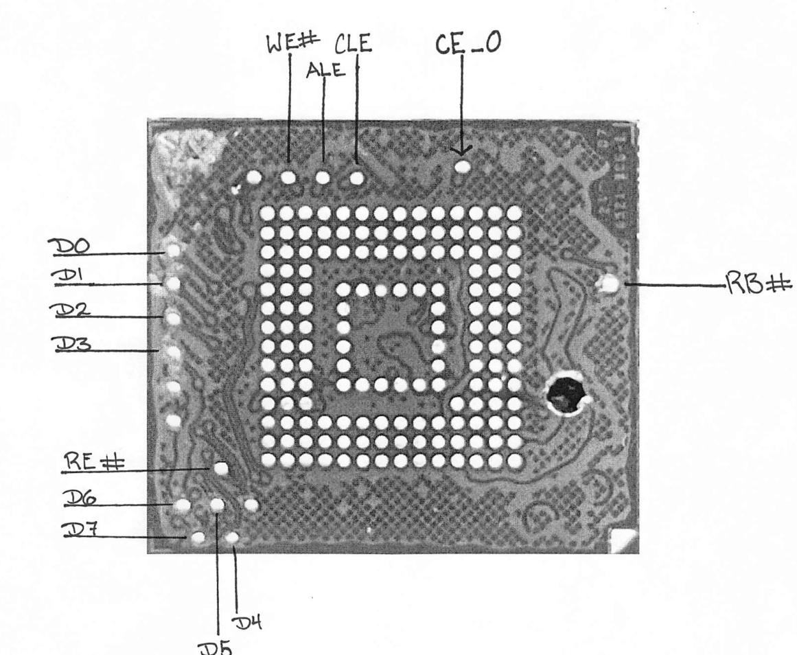

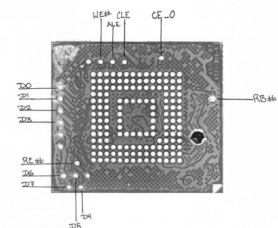

Use eMMC pinout for ground and VCC.
