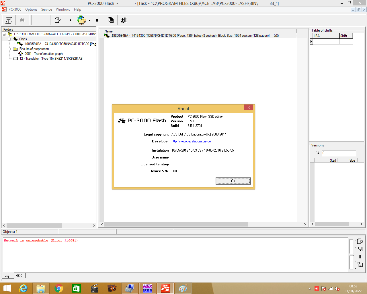

Hi to all!
Sorry, no pc-3000 flash experience.
SK6211 BAPC-8 TC58NVG4D1DTG00
1chip memory 2gb
Pc-3000 flash
Please, old (Version 6.5.1)
outdated. see the print.
Is dump is bad.
Link download dump.
https://we.tl/t-IuZKL1lHaq
Help?

Page size error loading the file into a blank project with the same chip id - on ver 7.2 here.

update tool is solution!
Thanks!
