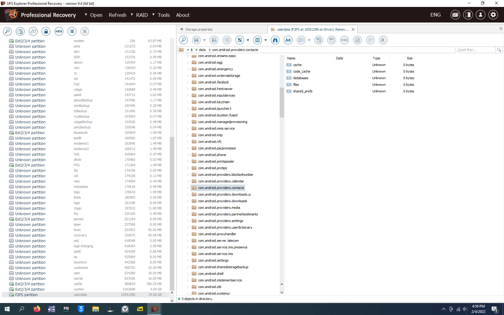

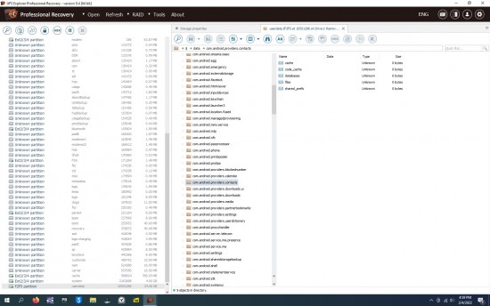

Thank you for the UFS Explorer tip! It was F2FS and this software did read the filesystem. I was able to navigate to data\com.android.providers.contacts, but the contents of this folder are all "Unknown" and 0 bytes. Is this because there was never any contacts stored on the phone (i.e. the contacts were all cloud synced from Google or another online account) or because it's corrupt?
I attached a screenshot so you can see what I mean. Thanks again for the help.
Might be because the owner used a seperate app for contacts, or they may be stored in a different place in the file system. Or I guess the phone might have been factory reset.
