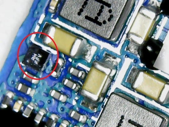

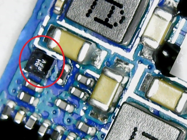

hello

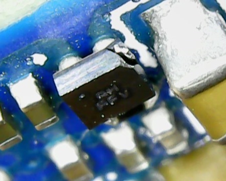

i have this sandisk X400 m.2 sata, SD8SN8U-256G-106 with broken chip, any advice which chip this is ?
danno ssd mvme.jpg (50.67 KiB) Viewed 7200 times

Grab a new one off a donor. Google suggests an LDO but you'll need someone with better electronics understanding.

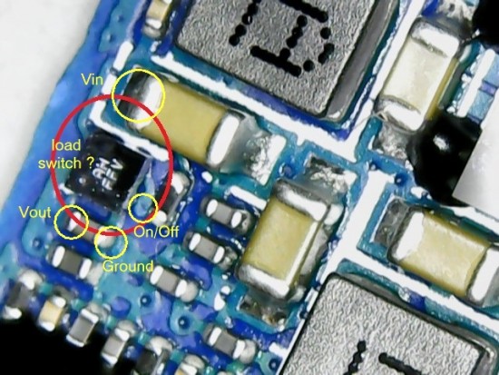

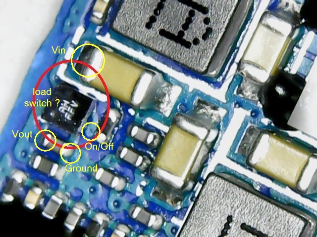

IMHO, it's either an LDO regulator or a load switch, probably the latter. If you can confirm that it is indeed a load switch, and provided that the load side is not shorted to ground, then it should be possible to connect Vin to Vout with a jumper wire.

SiP32462DB-T2-GE1, Vishay Siliconix, 50 mOhm, Slew Rate Controlled Load Switch, Vin = 1.2V - 5.5V, 1.2A, marking AH, WCSP4:
https://www.vishay.com/docs/67754/sip32461.pdf

If Vout is shorted to ground, look for a shorted ceramic capacitor.
