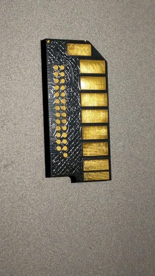

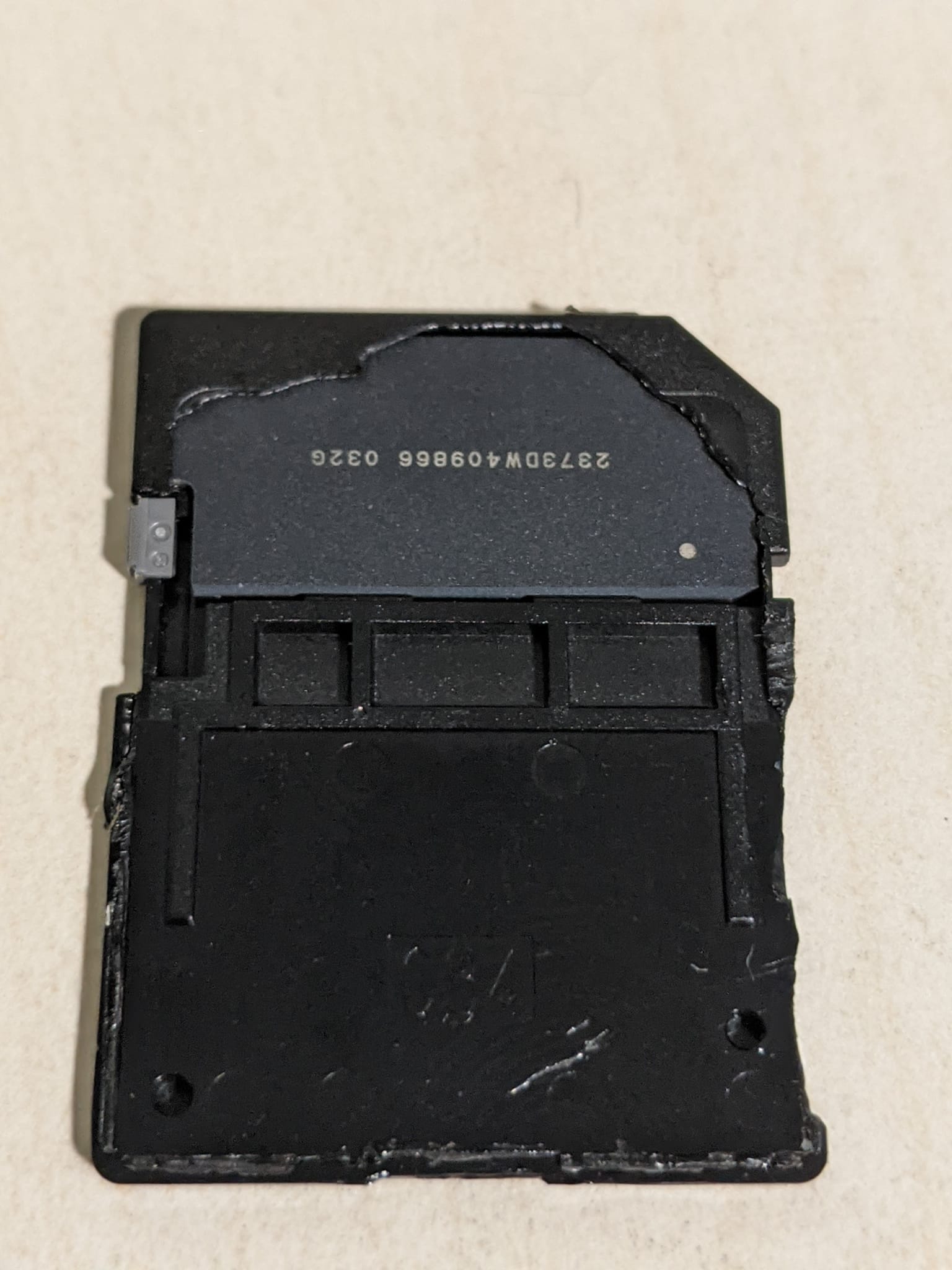

Hello ,
Wise people have already commented ,can you share the layout and photos of this case so that we could have a reference ,Infact i am interested in creating a thread of crypted and LDPC devices

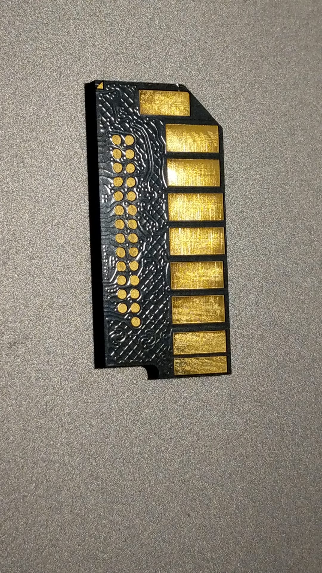

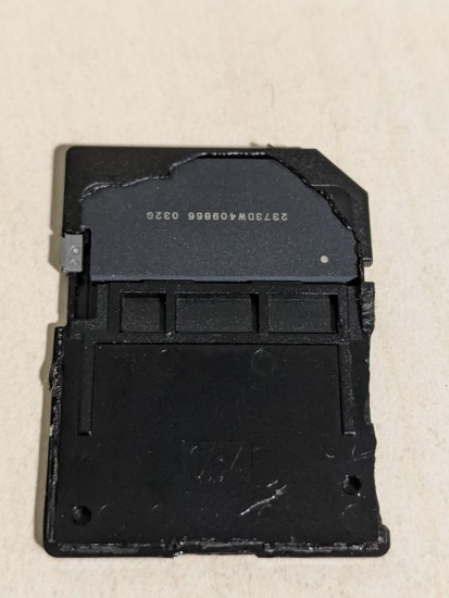

Here you go.

 Post subject: Re: Can someone do Sandisk dump with dynamic XOR key ?
PostPosted: February 7th, 2022, 8:58
Posts: 922
SD v43 from my database. http://odzyskiwanie-danych.com.pl/monol ... abase.html
Crypted.

samstown wrote:
Here you go.
How about removing the coating and taking a good shot and adding it here to start with -> https://forum.hddguru.com/viewtopic.php?f=10&t=42141
