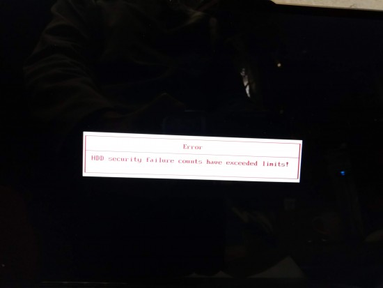

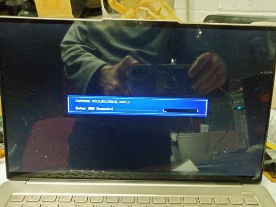

Lost Password issue with a 512GB SSD in a Lenovo S940 laptop.
SAMSUNG MZVLB512HBJQ-000L2
I am unable to reset/reformat the drive.
If I leave the SSD in the laptop, it keeps asking for the HDD password even though the BIOS is setup to boot from a USB drive (after first removing the SSD to get to the BIOS) and does not let me boot to Windows. If I remove the SSD drive the machine boots to windows.
How can I unlock/reset/format the SSD drive? Is there a master password?

Bitlocker ? you getting a blue screen asking for pw ?
 Post subject: Re: Samsung SSD with lost password
PostPosted: February 15th, 2022, 11:43
Joined: February 14th, 2022, 13:20
Location: united states
Yes, it is a blue screen with white borders and fonts asking for PW.
I don't know if Samsung would use Bitlocker.
I have attached the pics.
PostPosted: February 16th, 2022, 0:52
Posts: 2857
This is drive password not bitlocker, and you can forget about resetting/hacking it
