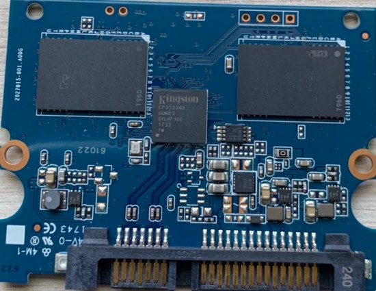

Hi!
Please info safe mode?

The 2-pins top-left are mostly the one
the other 4-pins (3+1) is the TX/RX pins
115200 :wink:

Forgot to ask, this is Kingston SA400S37 - 120GB right?
115200 :wink:
Yes correct!
Closed!
Thanks!
SA400S37 - 240 GB!

Noted. :beer:
