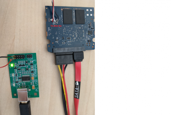

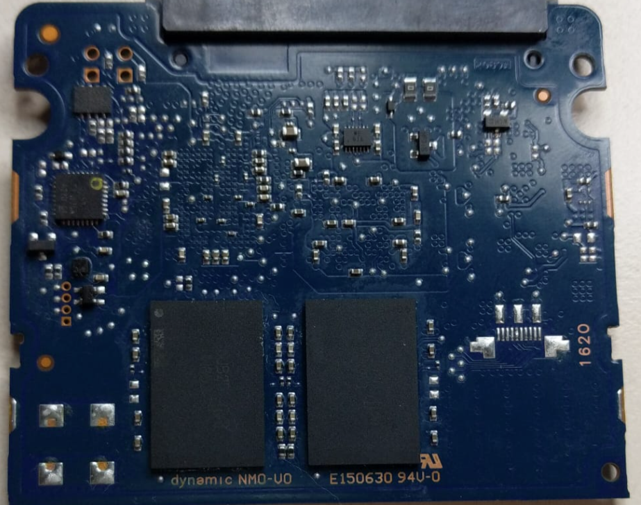

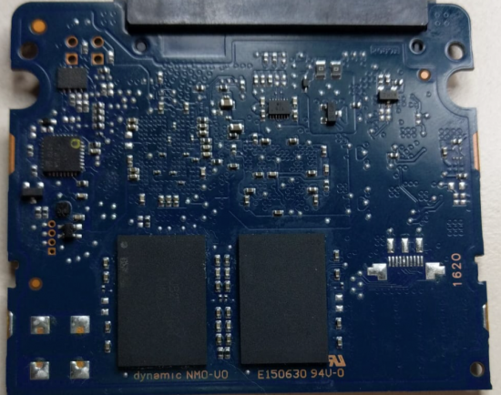

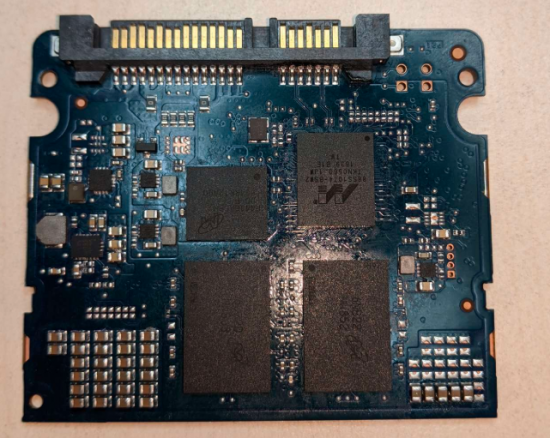

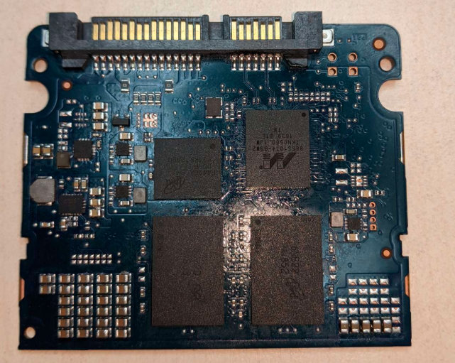

I got a MX300 SSD CT525MX300SSD1 that doesn' t ID. Always BSY. I tried cold and hot, when connected to PC3K, it's always BSY. Controller is Marvell 88SS1074.
I've search on this forum and google, nothing really help me, someone suggest rebailling.
Sam

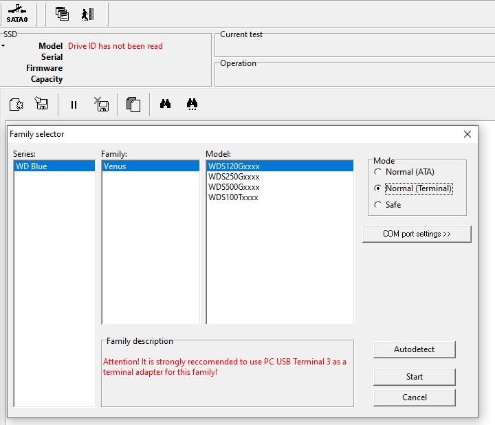

Do you have PC3000 SSD? Did connect terminal and jumper for safe mode? Try the WD utility?

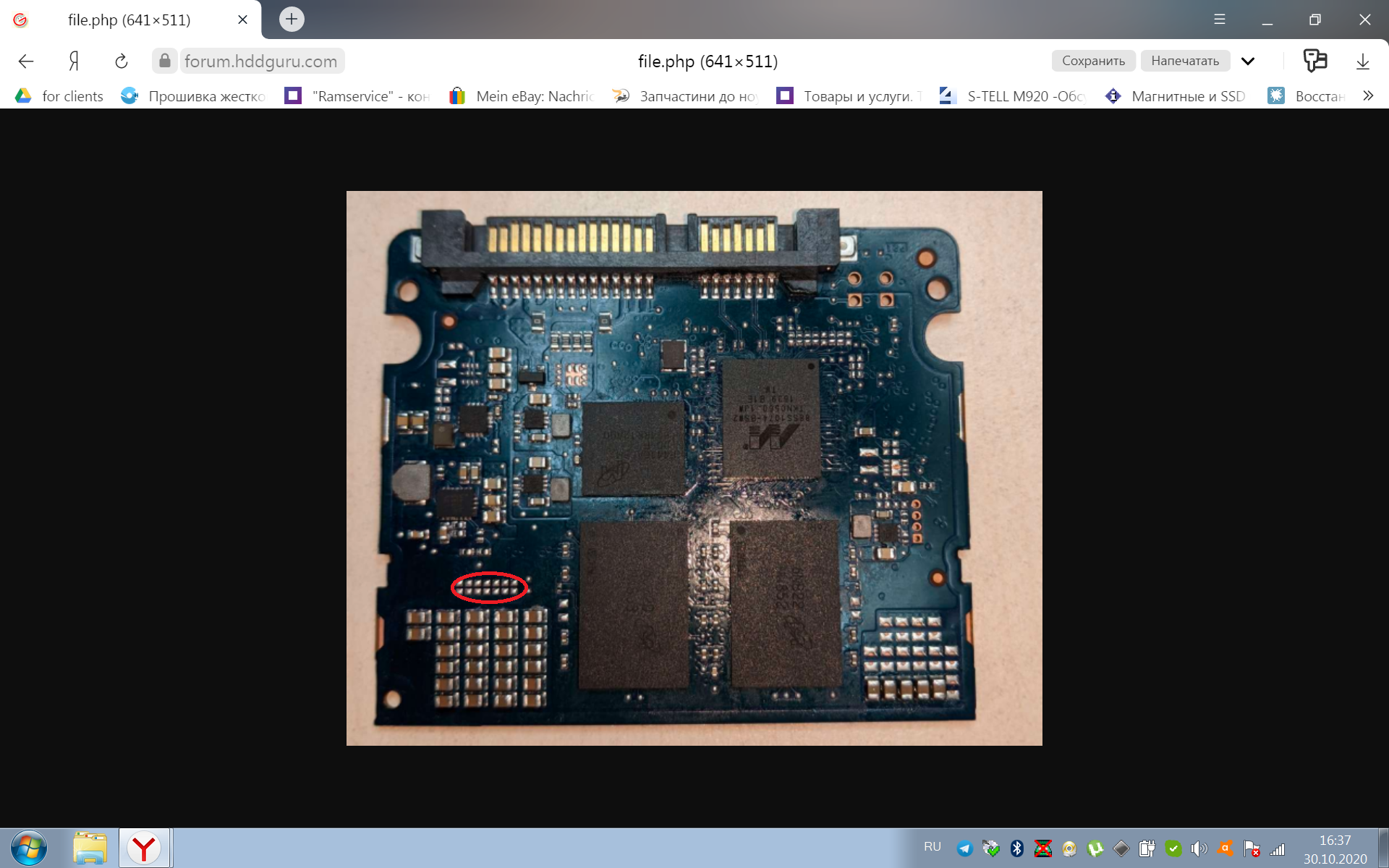

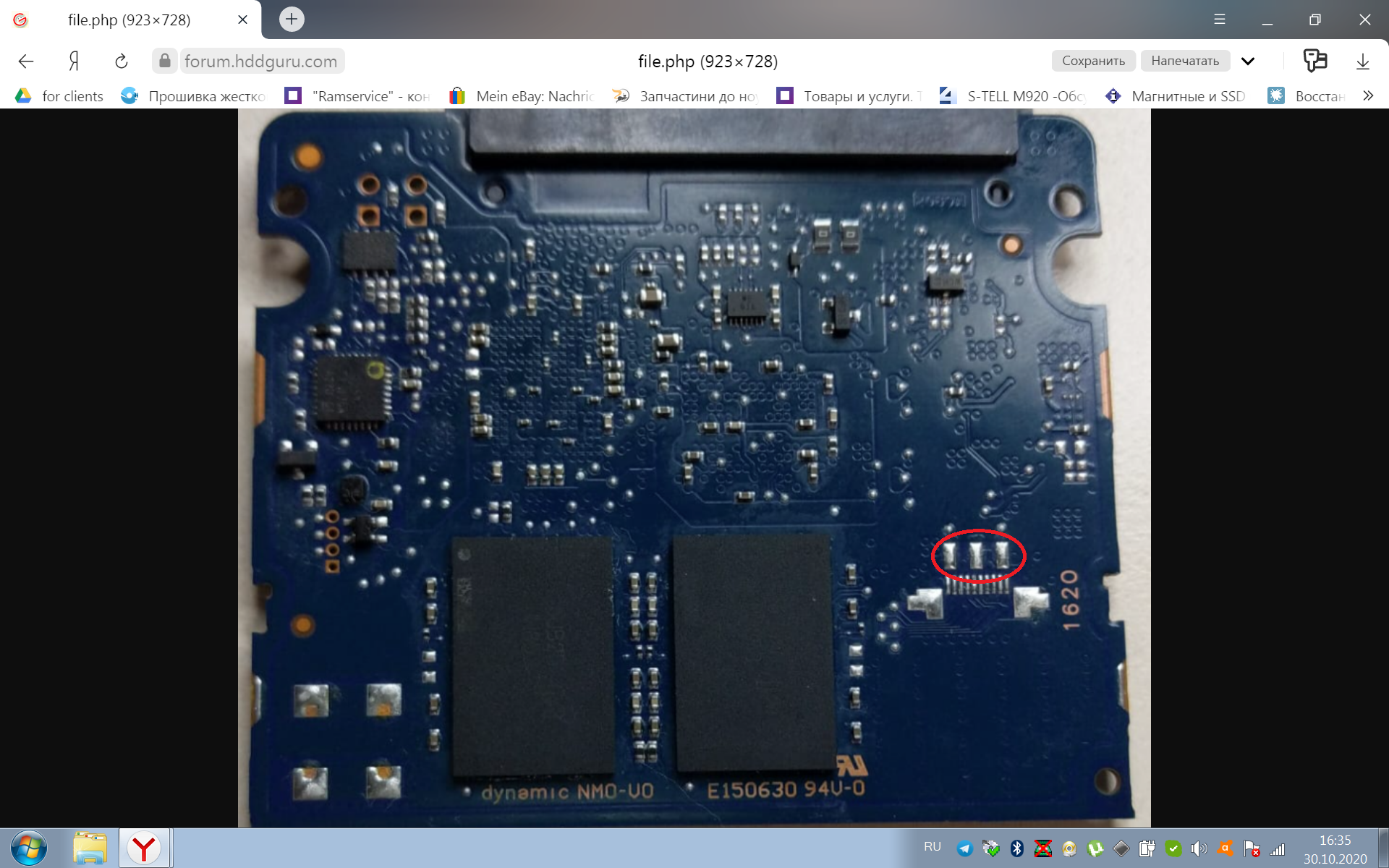

Thank you for your relpy. Yes, I do have PC3K SSD. I've compare Crucial PCB with WD but I can't find where are RX & TX. I've google it, so far no luck. Do you have an idea ? There's 4 holes near the conroller chip, maybe that could be for JTAG ?
 Post subject: Re: Crucial MX300 SSD CT525MX300SSD1 - No ID - always BSY
PostPosted: October 30th, 2020, 10:33
Joined: February 18th, 2020, 9:35
Posts: 75
Location: Ukraina
In this SSD, the introduction of technical commands for ATA and the terminal is blocked

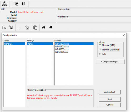

terminal

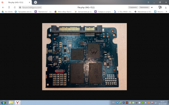

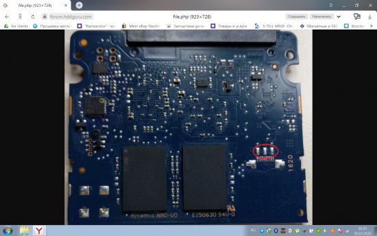

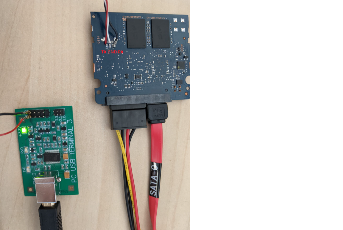

Put jumpers

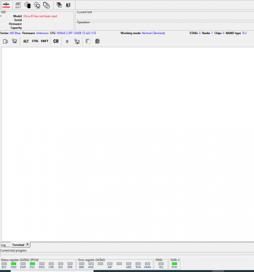

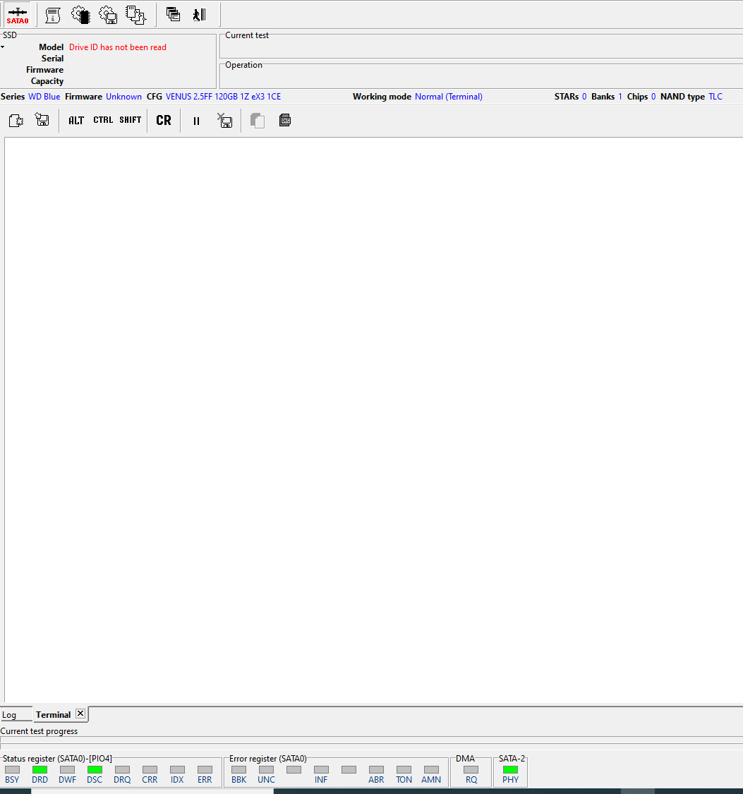

Thank you. I've connect terminal but if you are saying it's locked, is there anyhting we can do ?
I tried WD Utility in PC3K, nothing so far.

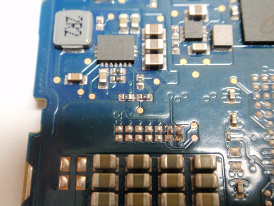

jumpers

Thank you very much for those detailed information.
I've put the two jumper. I connected terminal. I see rx-tx flashing but I don't get much more.

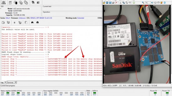

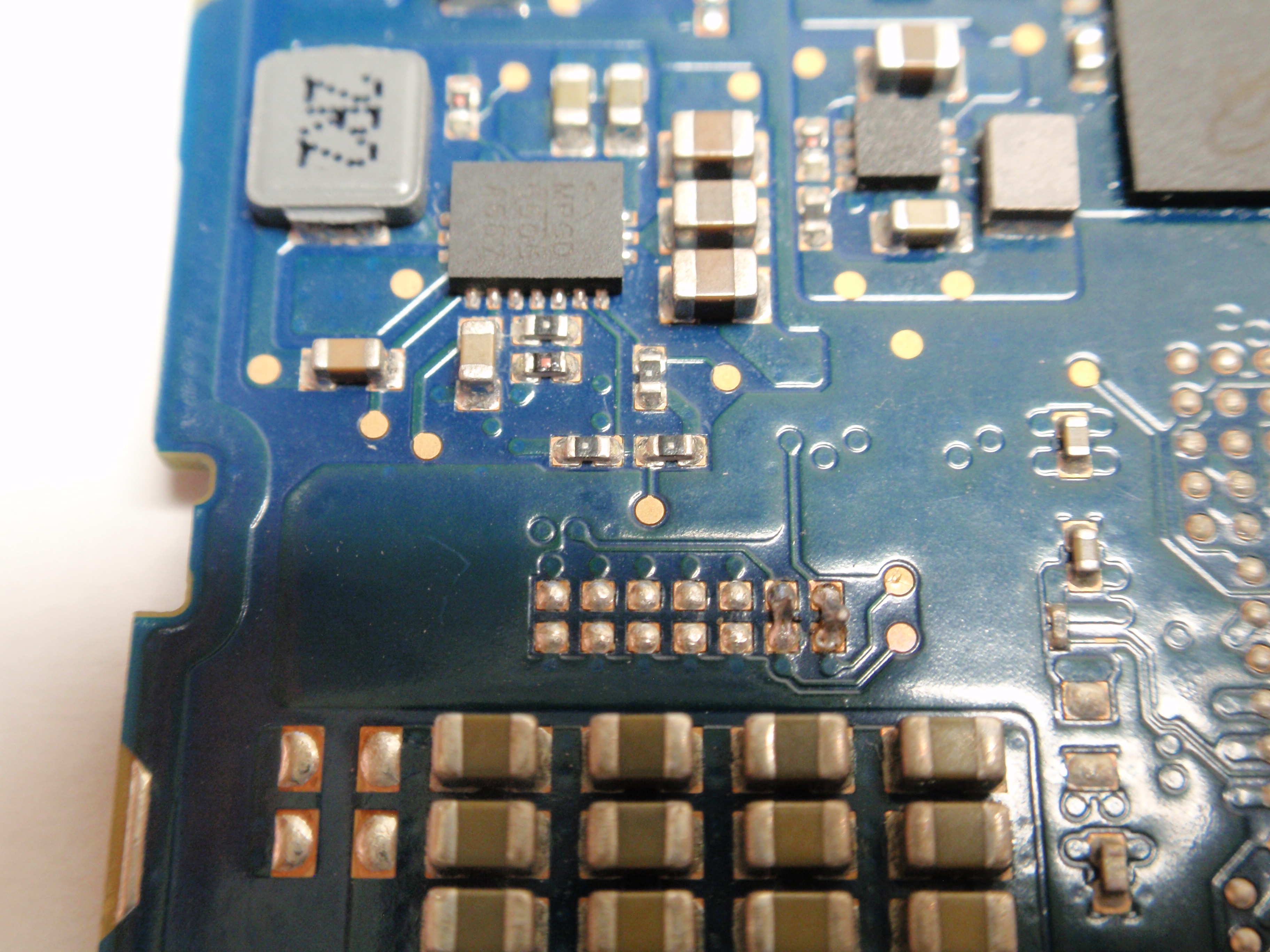

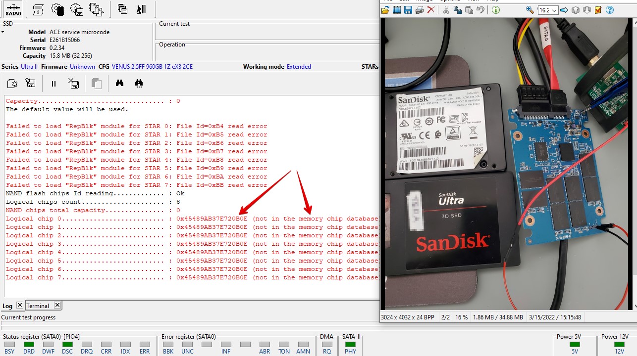

I am working on a SanDisk Ultra with Marvell 88SS1074 controller, gets RDY, but then goes to BSY.
It is a 3D NAND model SSD and PC3KSSD says the chip is not in the database.
Is it true?

I88SS1074 is listed
https://blog.acelaboratory.com/pc-3000- ... dated.html
PostPosted: March 16th, 2022, 6:49
Right, the controller is, thanks.
The question refers to the 3D NAND being supported.
PostPosted: March 16th, 2022, 7:09
Posts: 1312
The chip database is available from the main menu or ctrl z - 45489AB aren't listed in mine either - worth confirming with ACE though.
