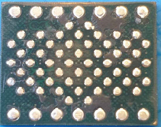

Hi. NAND LGA70 from USB flash drive.
Need help with pinoust. maybe someone has? Thx!

onfi_5_0_gold.pdf page 18

LGA52 same as 60 and 70?

No, this is EZNAND, in the ULGA70 case, I thought it had already been added to the ONFI standard

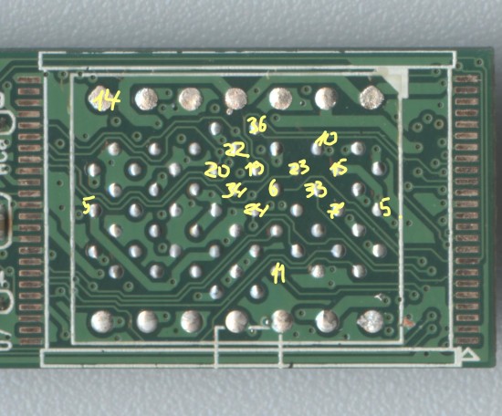

Here is a friend who called the contacts , the PS2251-07 controller
