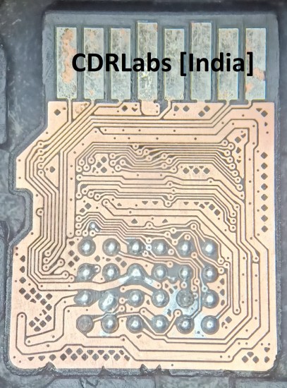

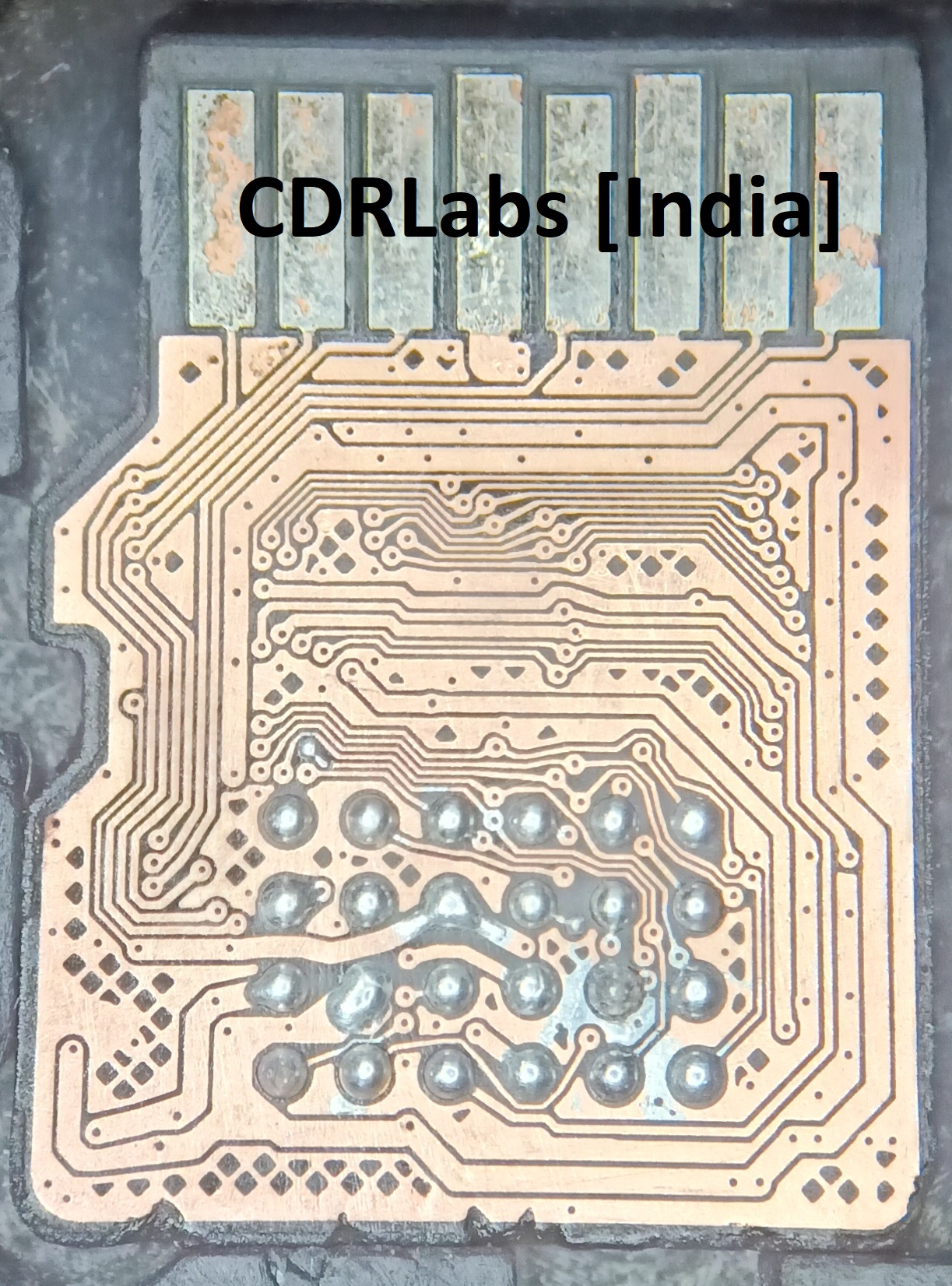

I have this Micro SD Card ,I have seen the resources of Two of my senior members and i cannot find any pattern like this in thier database ,Has anyone worked on this Micro SD Card ,Can you suggest something .
In VNR Database : The following 0042,0027,0029,0115,0174 are 6x4 Pattern
Here is the image

Hello Everyone ,
Pinout Is found ,Just Trying Out a Few permutations and combinations for NAND Reconstruction ,Hopefully We might be able to reconstruct the File System And get this data ,ECC and SA were XORED , Seems Like a Phison Controller

Well,
This turned out to be a Phison With SLC and Normal Sections ,Both Sections had to be carved out and combined ,The end result was not a good file system but i managed to get the call recordings that the client wanted ,Lots of biterrors had a tough time
