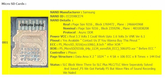

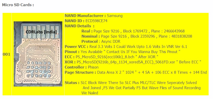

Hello Everyone ,
I have started to make my own monolith nand database ,This is my first addition ,Would you suggest what i add/delete or modify .Thank you for your support ,Would be making 1 to 3 entries per week ,Lots of old cases are also solved waiting to be uploaded to database
PS : Database Would BE Here - > http://www.nandflashrecovery.com/43,0,flash-memory-database-.html
