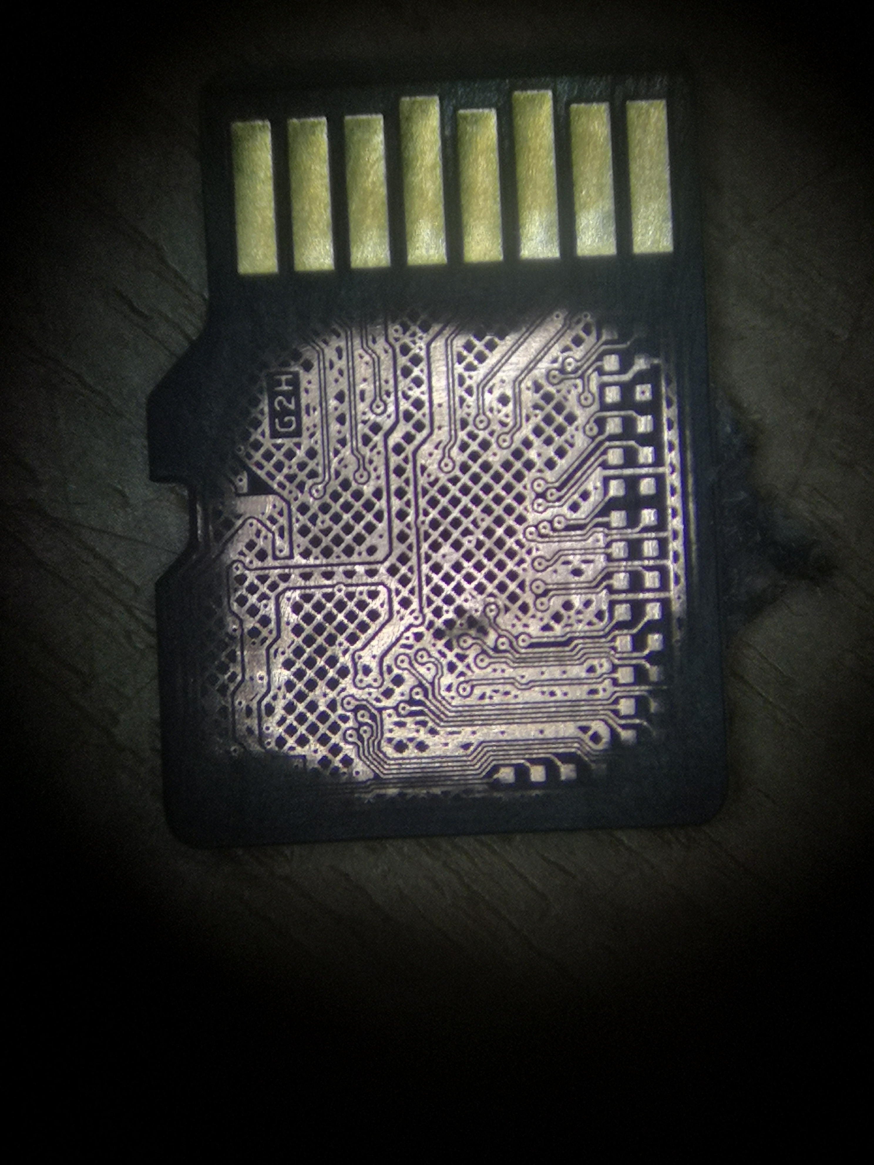

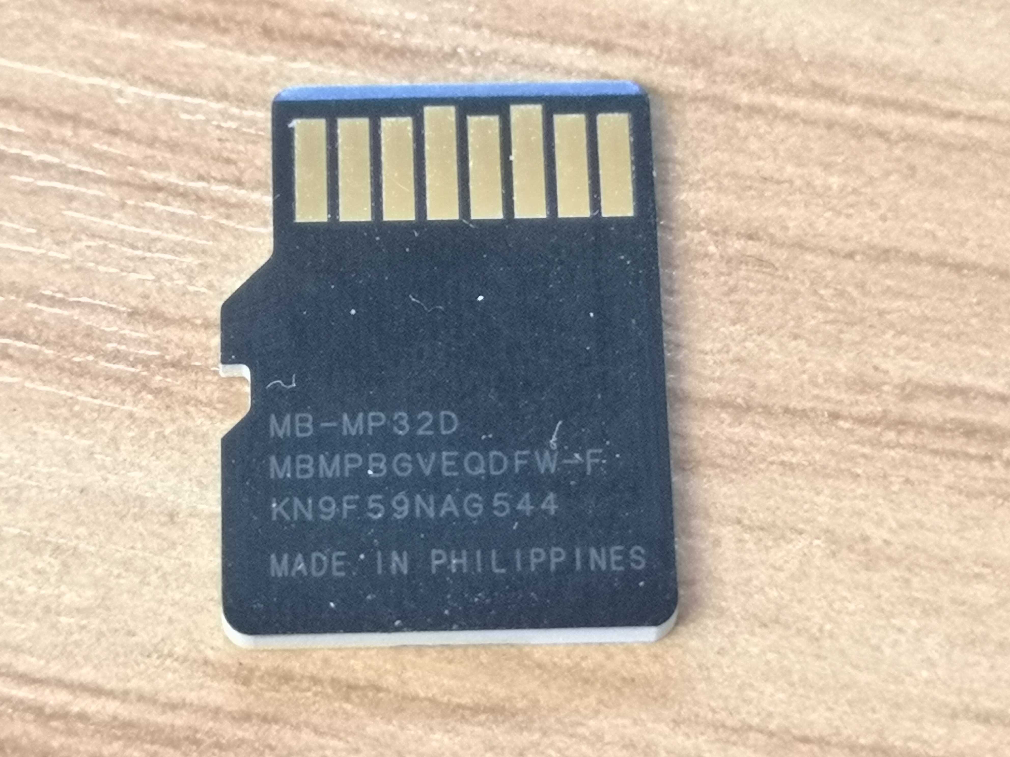

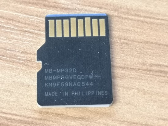

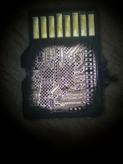

Hi

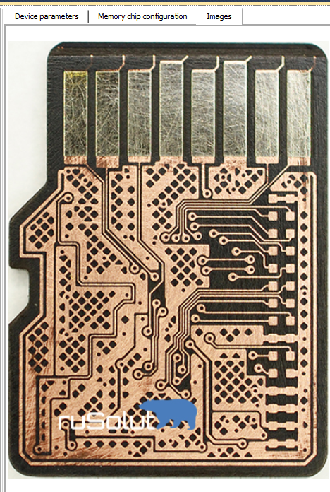

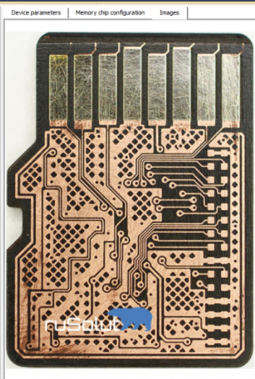

Does anyone have a pinout for this monolith? I found a sort-of similiar one (dots on the right but missing the text "G2H" in top left corner) in the VNR database but there's no info about it so I have no idea if the layout is the same.

EVO are unrecoverable via NAND protocol for now.
Pinout is the same.

MicroSD v93 from our database. We make some research for Samsung Evo cards from this family. XOR should be no problem, mix is not the problem, assembly algorithm is not the problem.
Problem is with ECC, non standard. Without ECC all data will be broken.
Pinout is other. There is few different pinouts for Samsung MicroSD 2x15.
