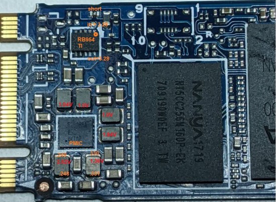

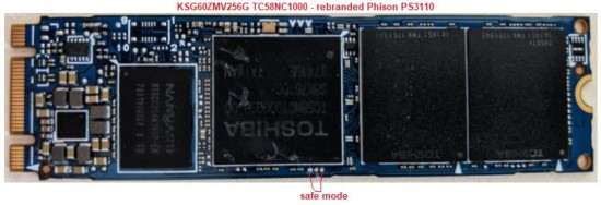

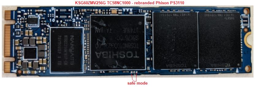

I got this m.2, it's supported by PC-3000 but I can't get into safe mode. Has anyone work on this drive before ? Are my pin-out correct ? When powered on, drive reg DRD & DWF are green. Can't get more

Could be physical issue, when powered on, I get all reg on, like nothing is connected. If I short, I get DRD & DWF.

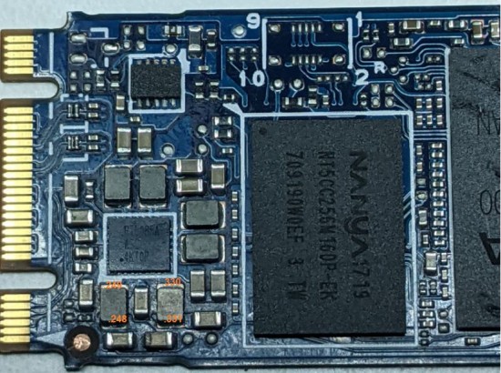

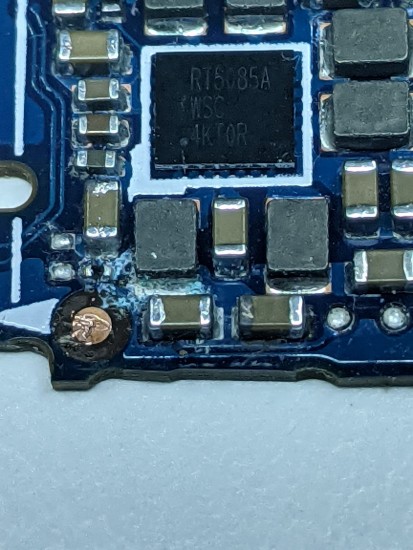

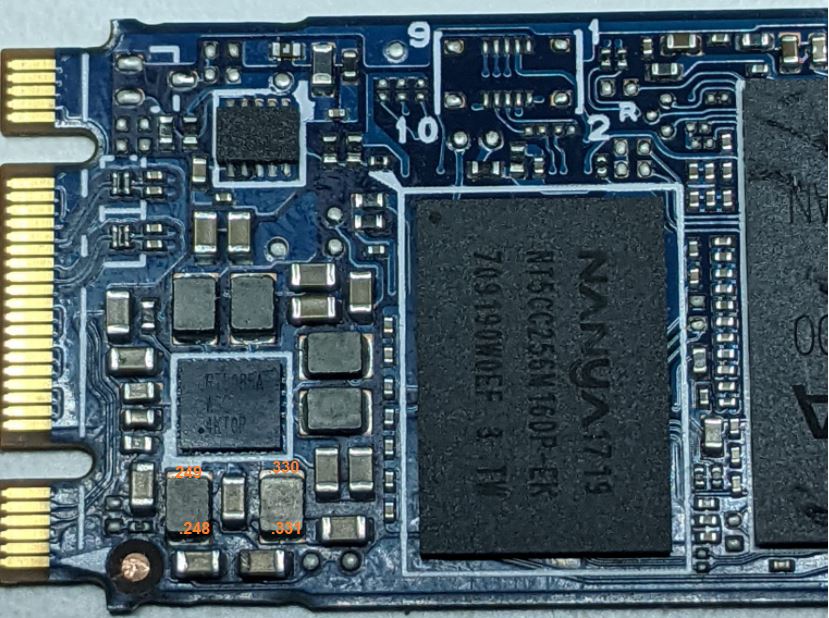

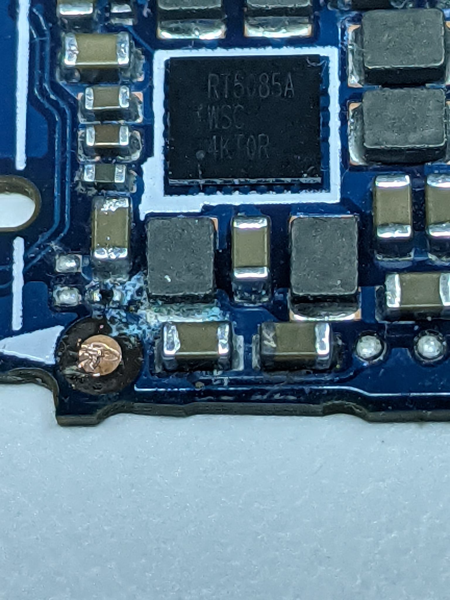

Looks like liquid, i've cleaned it no change. I've checked caps, looks ok. When connected, it takes 0.36A on 5V and 0.00 on 12V.

Indeed, the TC58NC1000 controller is a relabeled Phison PS3110. But this particular Toshiba KSG60ZMVxxxG drive has its own firmware and command system. It is not supported by the PC-3000.
If you don't believe me, ask tech support to clarify this issue, or tell me which engineer told you this.

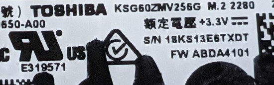

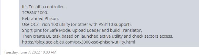

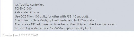

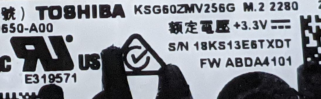

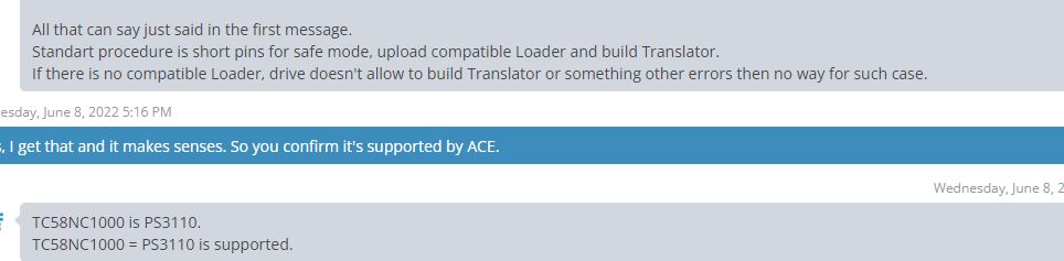

Thank you. That's what tech support said. I sent all info and pics.

But did you tell them it's THAT specific drive model?
 Post subject: Re: KSG60ZMV256G TC58NC1000 - rebranded Phison PS3110
PostPosted: June 8th, 2022, 10:46
Posts: 191
Location: Switzerland
Yes, I sent pictures of drive and label.

If you have a drive like this, can you access safe mode and check it in universal utility ?
PostPosted: June 8th, 2022, 11:23
Posts: 191

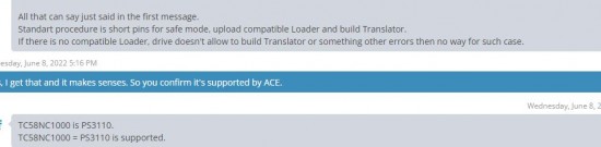

they are confirming it is supported

No tool will support a dead SSD.

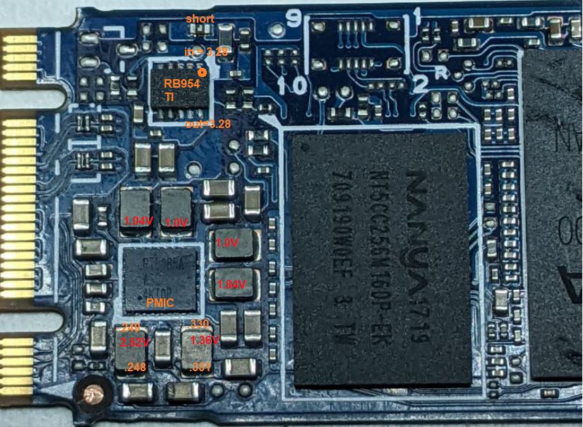

The photo clip appears to be showing two supply voltages, 0.33V and 0.25V (what are the other 4 supplies?). Something is wrong here, or perhaps the PMIC is in some kind of standby mode?
PostPosted: June 8th, 2022, 14:43
Posts: 17335
The 10-pin IC may be an e-fuse. Can you measure its input and output voltages? Can you tell us its markings?
There also appears to be a tiny smt fuse ("F" ?) or polyswitch above this IC.

10 PIN IC seems to be
https://www.ti.com/lit/ds/symlink/tps22 ... 2FTPS22954
Vin = Vout = 3.28 V
How can I check if PMIC is in stanby mode ?
Sorry for the mess, the value in orange with . (dot) before where diode mode, not voltage. I put supply voltage in red for the filter only.
PostPosted: June 8th, 2022, 15:54
Posts: 17335
They all look OK to me.

Thank you for checking. Has anyone experience issue that reballing could fix ? Reballing is pretty frequent in iPhone, iPad, GPU.. wondering If that's something I should try here as I don' t have a lot of idea left.

The only thing that occurs to me is that you could try to find the NAND R/B pin(s) and short one of them to ground during power-on. These pins are open drain, so no damage should result.
