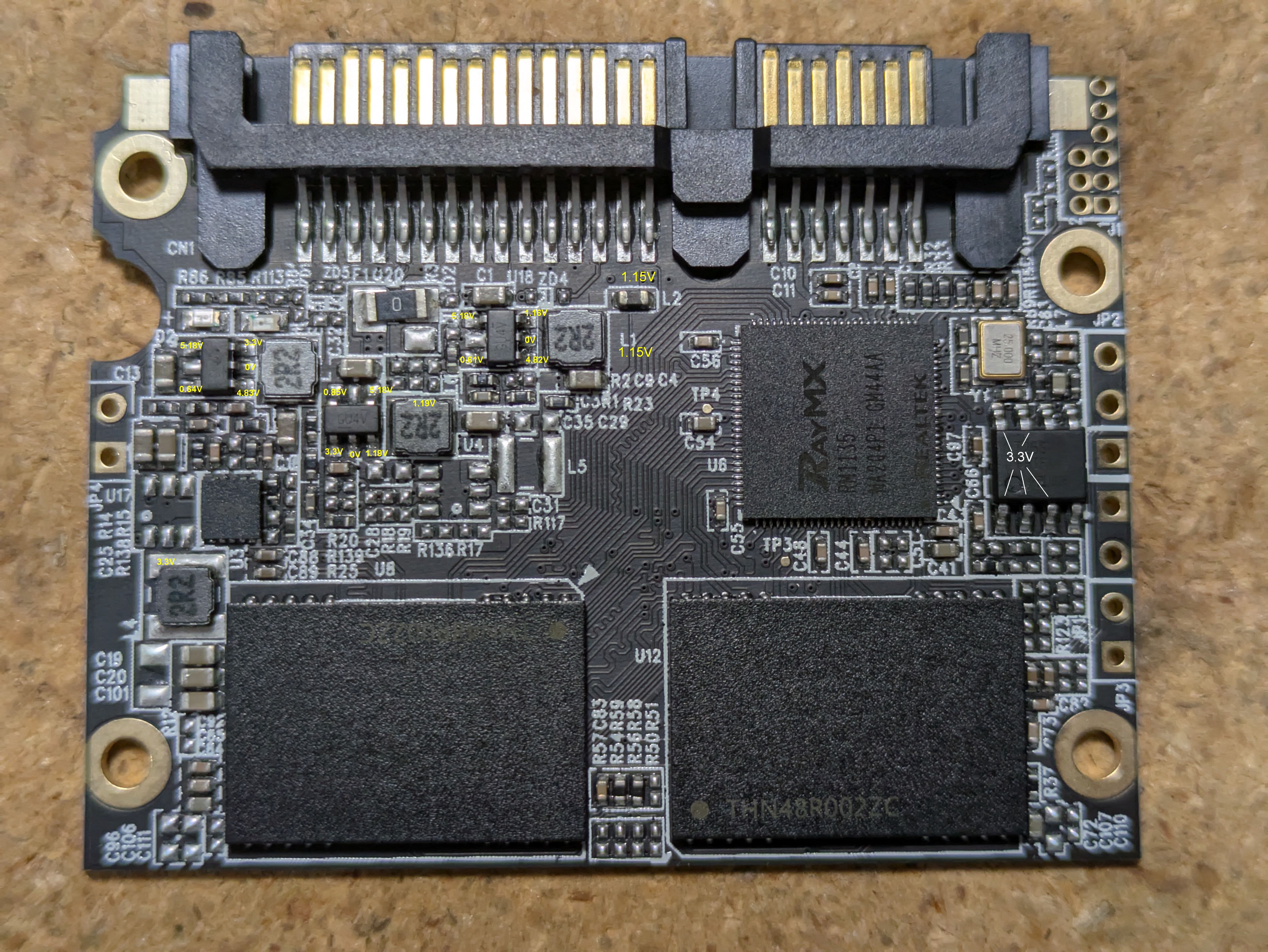

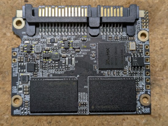

This 4TB Silicon Power ACE A58 SSD isn't recognized by my USB to SATA adapter. Here's a picture with the voltages I measured.
File comment: Voltages on the PCB
On my desktop, the computer won't POST, failing with a power error. I've checked all the capacitors I can see and none are short.
If I leave it plugged into power, the RayMX chip gets warm (32C) but I don't feel any of the capactiors get warm. I don't have a thermal camera.
Any suggestions on where to go from here?

The voltages seem OK.

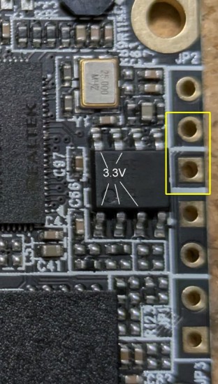

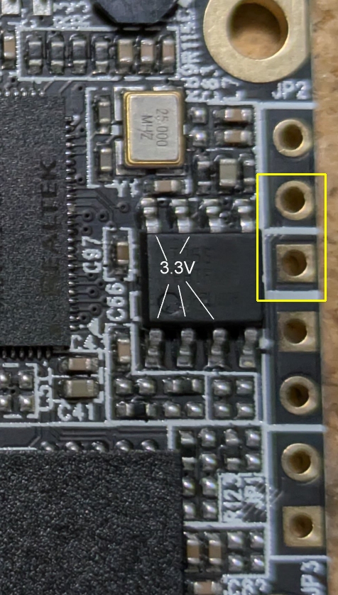

I'm not a DR pro. Most SSD have jumpers which you short with tweezers during power-on, and then release after a few seconds. This forces the SSD controller to power up in safe mode or "ROM mode". In this mode it usually identifies itself with a factory alias and reduced capacity. This then tells you that the controller has basic sanity.
Here are some examples:
http://vlo.name:3000/hw/ssd/rommode/
I don't know the relevant shorting points for your SSD, so you would need to be careful. Obviously you wouldn't want to short a power supply to ground, for example.

This would be my guess:
