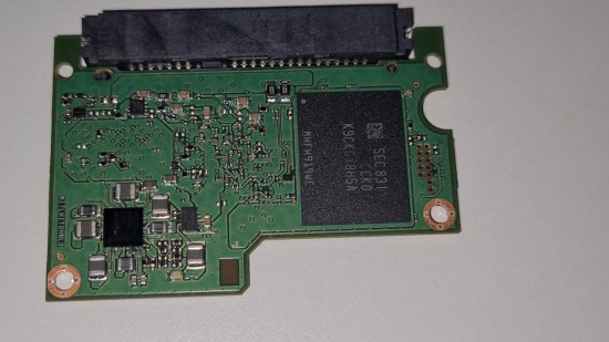

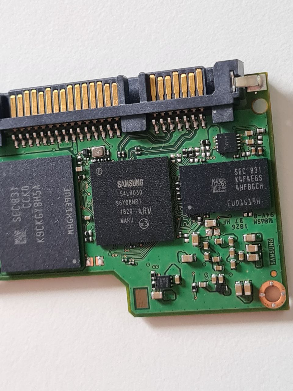

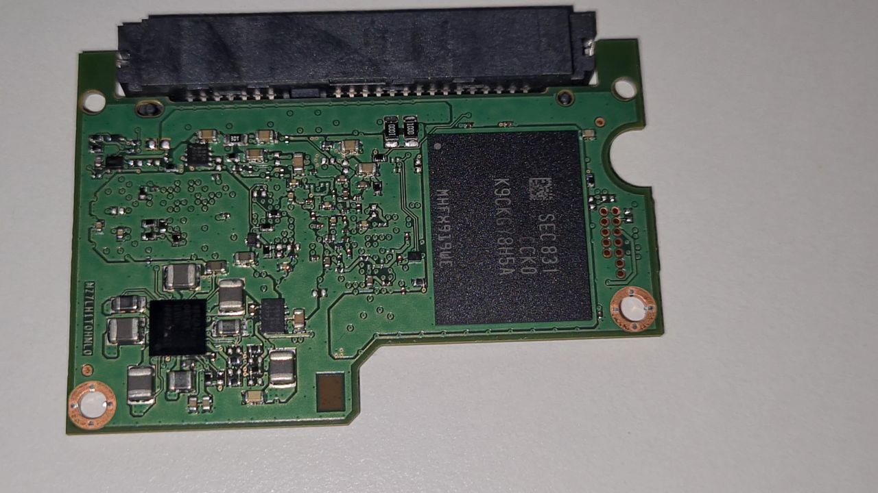

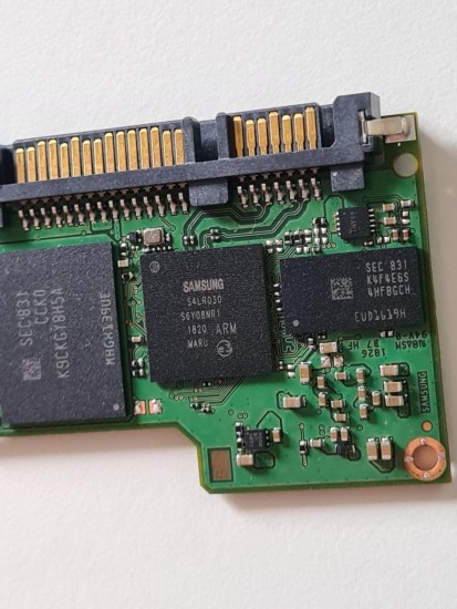

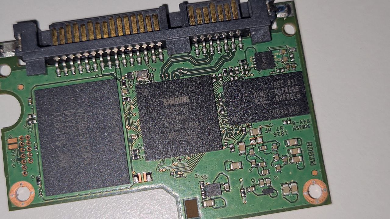

Hi guys, I'm new to the forum, my name is Davide, sorry for my poor English! I was fumbling in the computer case while it was on, and by mistake I moved the SSD cables, when i restarted the pc, the SSD is gone, not displayed in the bios, not even in disk management. I think I made a short circuit (?).
I wanted to ask if I could do something. I attach some photos
 Post subject: Re: Samsug 860 EVO dead
PostPosted: May 1st, 2022, 16:24
Posts: 17332
There is a 10-pin e-fuse above the SDRAM. Measure the voltages at its input and output pins.

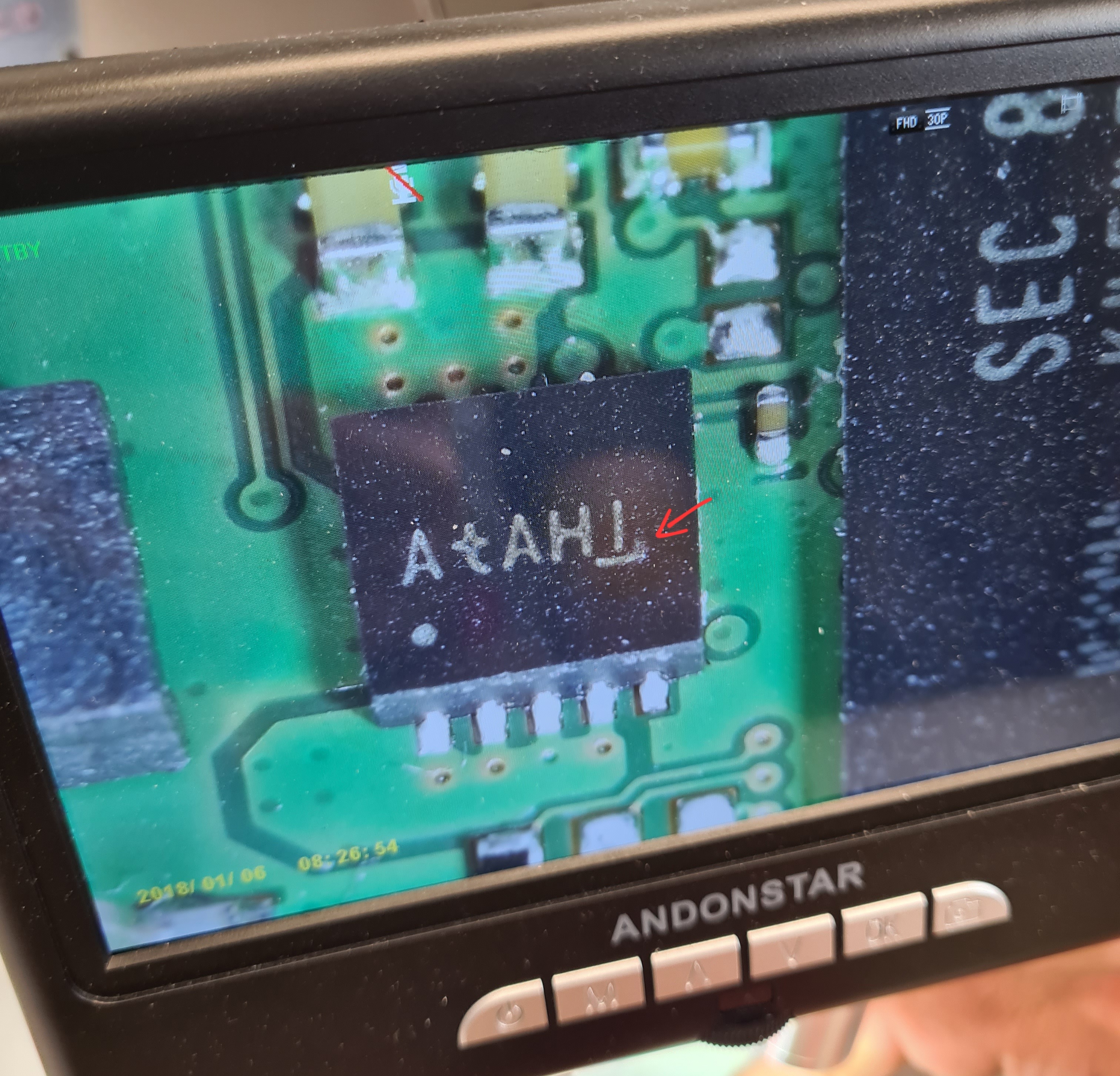

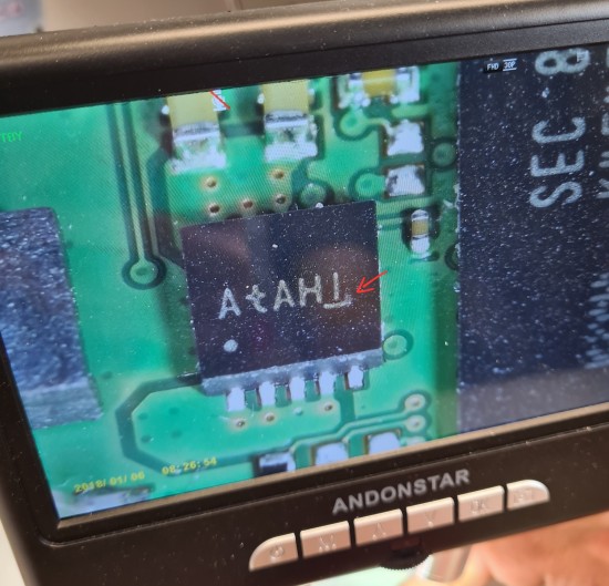

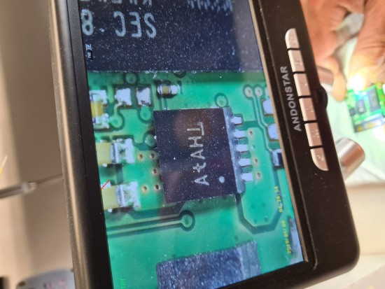

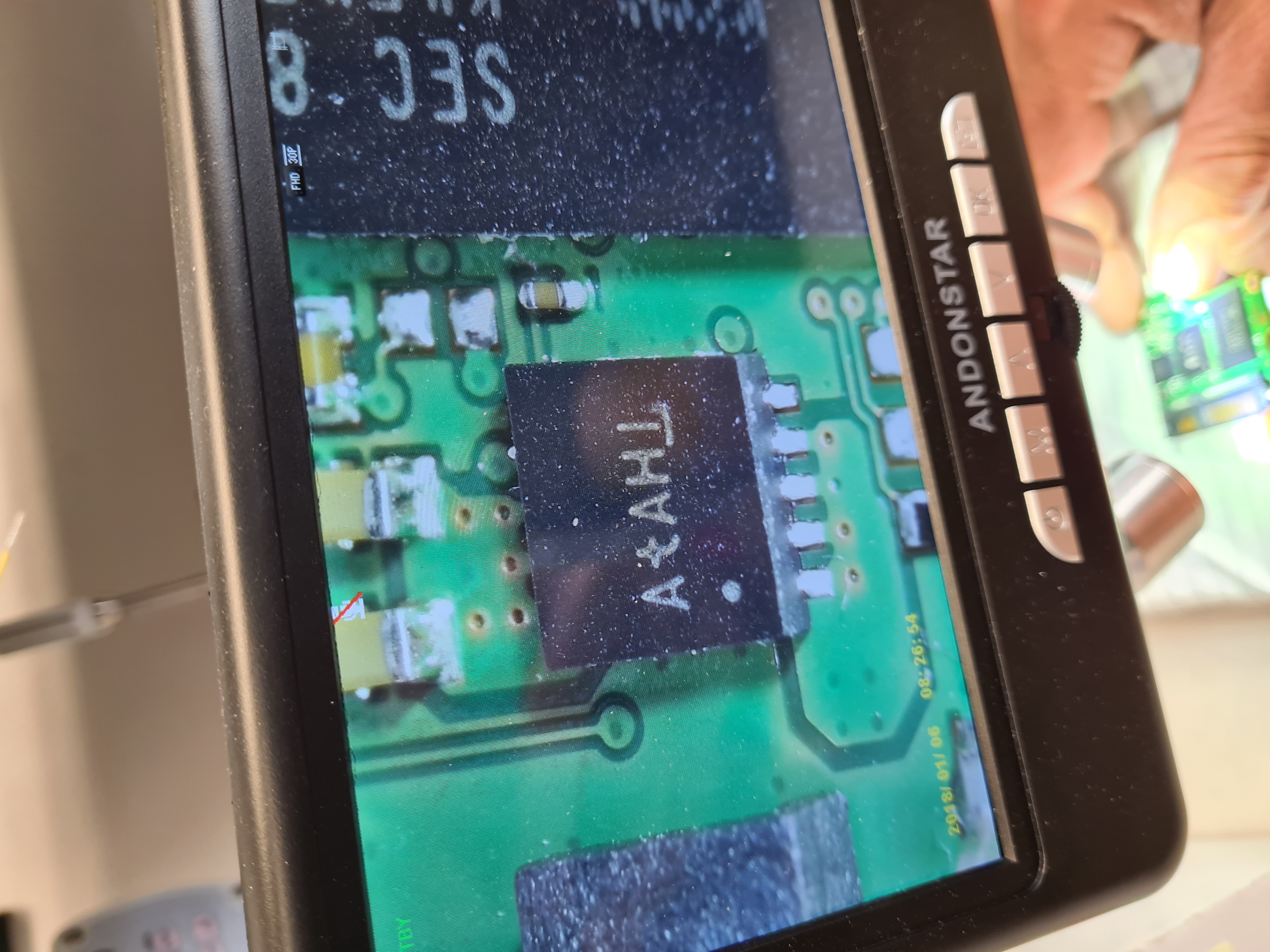

I checked under a microscope and realized that it is burned, has a small burned bubble on top. Can that component be purchased?
PostPosted: May 3rd, 2022, 12:56
Posts: 17332
It's and STEF4S e-fuse:
http://www.hddoracle.com/viewtopic.php?f=100&t=1615
If there are no other problems, and if your PSU is OK, you can bridge 5Vin to 5Vout. Measure the voltages first, though.

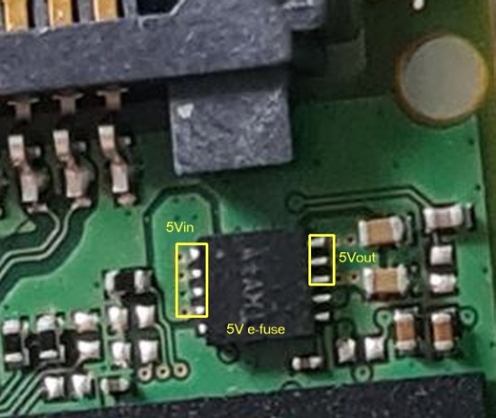

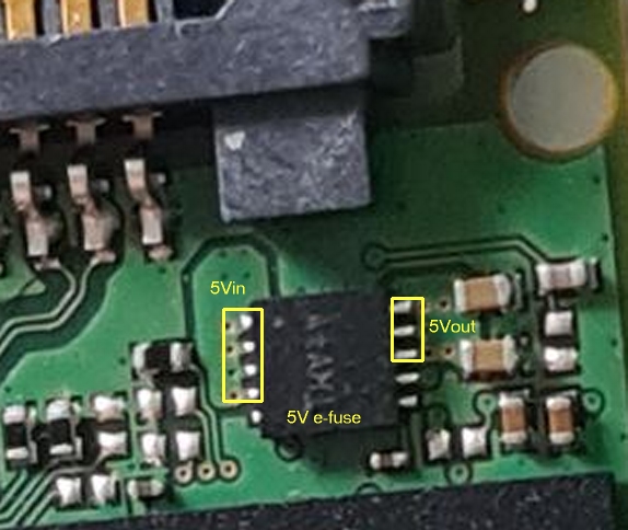

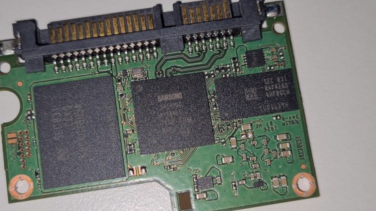

Assuming the power supply is ok, with this bridge in the future can cause problems? Can you make some lines for me to figure out what to connect with what? Just to make no mistake, thanks
PostPosted: May 3rd, 2022, 13:47
Posts: 17332
I've marked the points on the photo. I don't know how much more I can tell you other than to join the two points. Be aware that the drive will work, but it will no longer be protected from overvoltages. Replace the IC with an STEF4S if you want continued protection.
That said, if you are unable to measure a voltage, then you might consider passing the task to someone else.

I made the bridge and now it works! Is this https://it.aliexpress.com/item/1005003601615735.html?spm=a2g0o.productlist.0.0.356232b7OIg8Ca&algo_pvid=183833ff-27d0-4fe5-98c1-0ce6b767fd0f&algo_exp_id=183833ff-27d0-4fe5-98c1-0ce6b767fd0f-1&pdp_ext_f=%7B%22sku_id%22%3A%2212000026453060688%22%7D&pdp_npi=1%40dis%7CEUR%7C%7C3.69%7C%7C%7C%7C%7C%402100bb4916516598250055438e98ff%7C12000026453060688%7Csea
