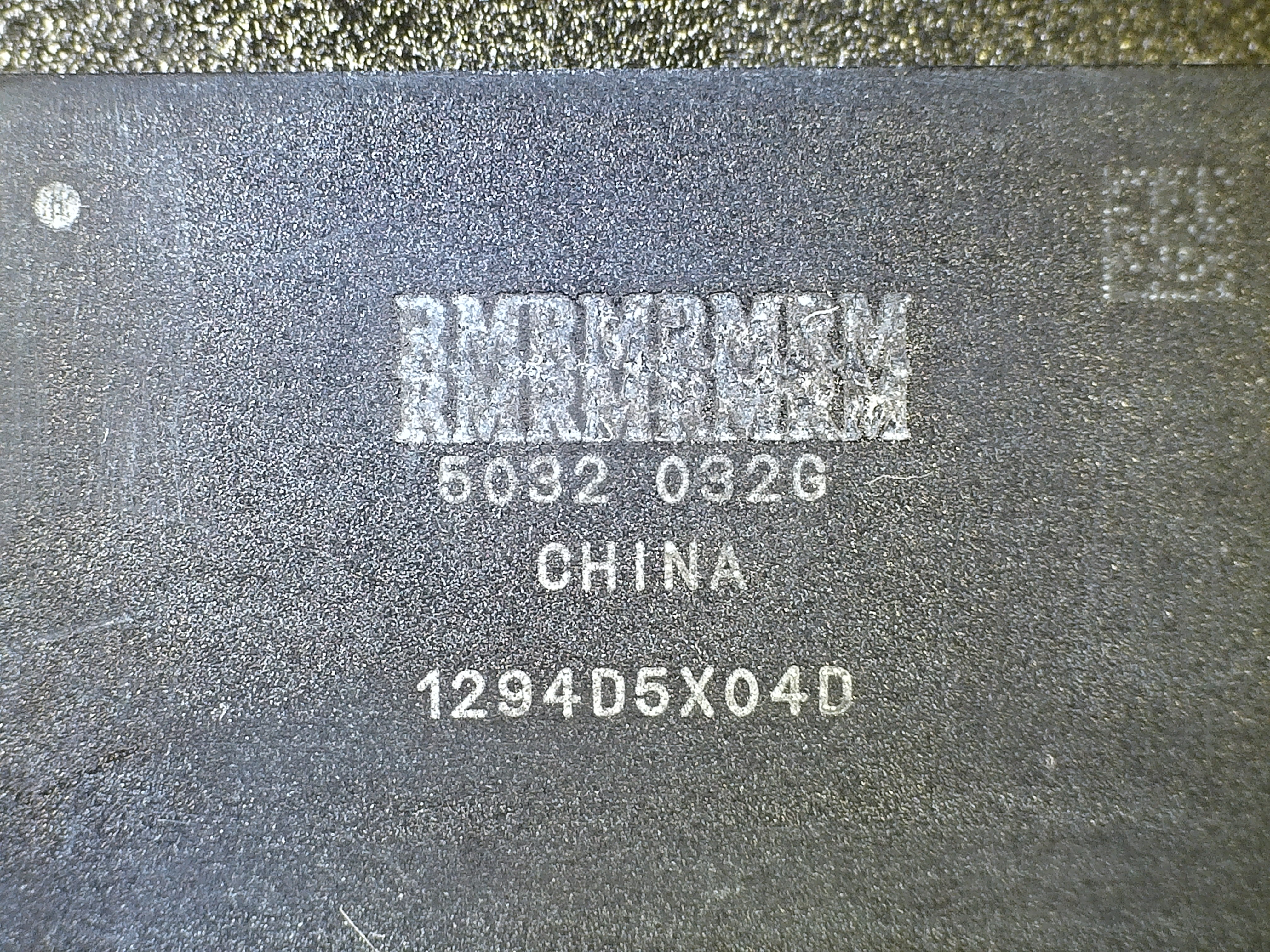

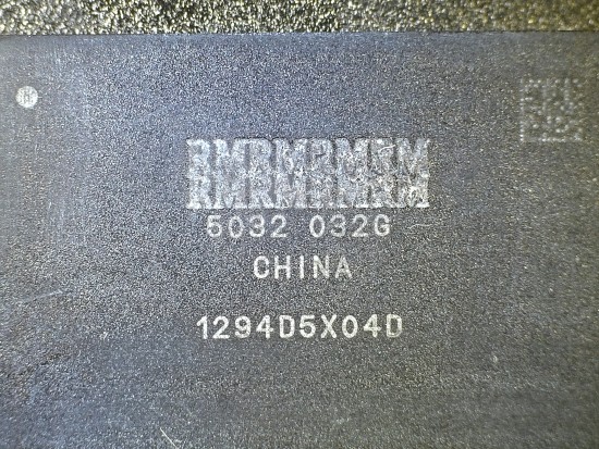

I got a Hama USB drive in for recovery.
Inside looks like chinese, blob controller, this weird chip that i never seen in a usb and lots of hot glue.
Does anyone what this is? NAND or EMMC? Any clue about the pinout i can use to connect?

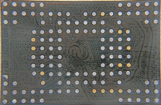

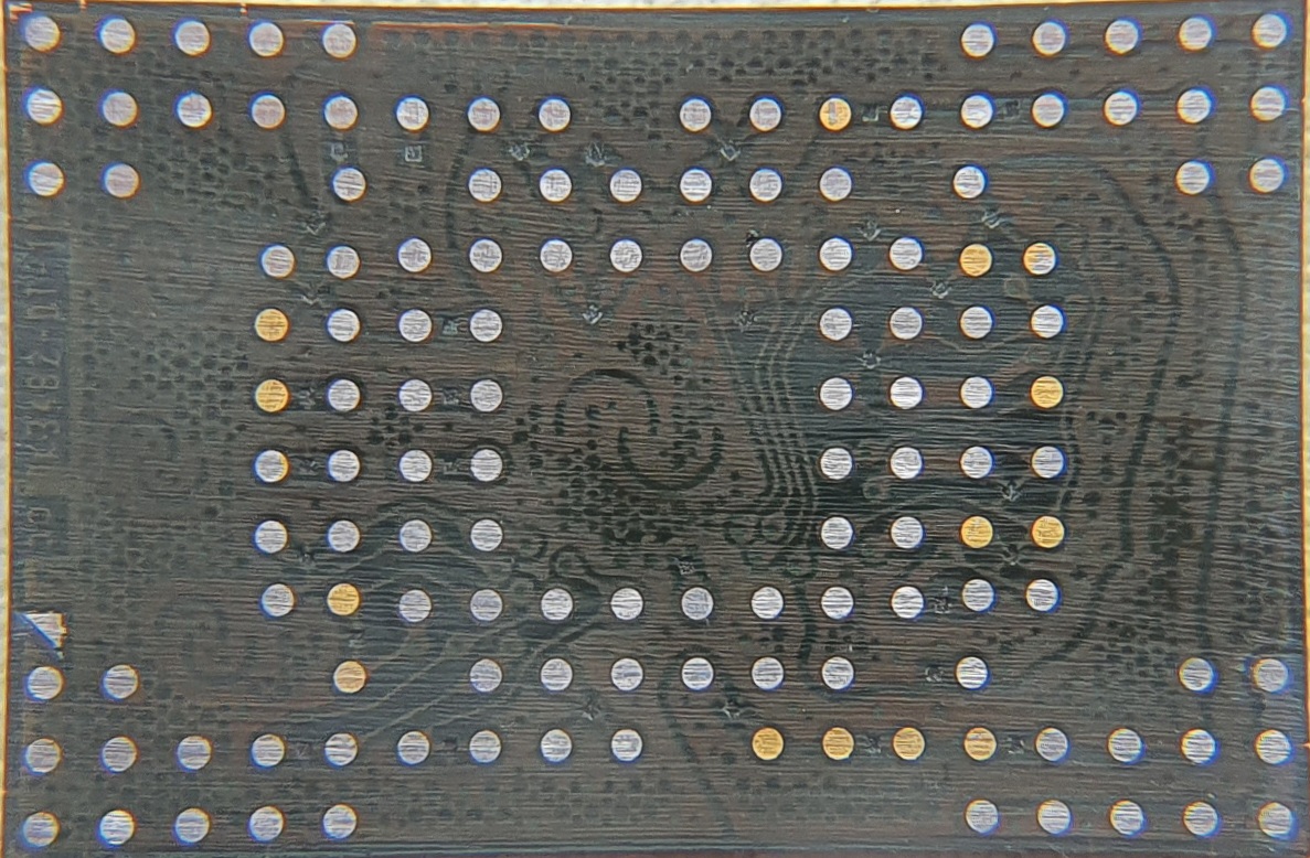

It is NAND, BGA-154, quite rare. It could be 16-bit. Here it is refurbished chip, so can be more suprizes.

Adapter available - https://multi-recovery.com/subpages/MRBGA154.php
