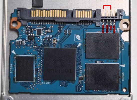

Hi, i have this 2.5 inch SSD from TOSHIBA
It has the TC58NC1000 controller which for some time we know now its a rebranded PS3111 controller
However on this SSD I couldn't find where the shorting pins are to get the SSD to go into Safe mode
Can anyone help me out!
Many thanks!
https://photos.app.goo.gl/JNb5sjvRBbsQm3QY7
https://photos.app.goo.gl/HeyGd3DKZLKP41TN9

 Post subject: Re: KSG60ZMV256G TC58NC1000 TOSHIBA 2.5 SSD
PostPosted: December 15th, 2024, 16:29
Posts: 17340
https://forum.acelab.eu.com/viewtopic.php?t=8881

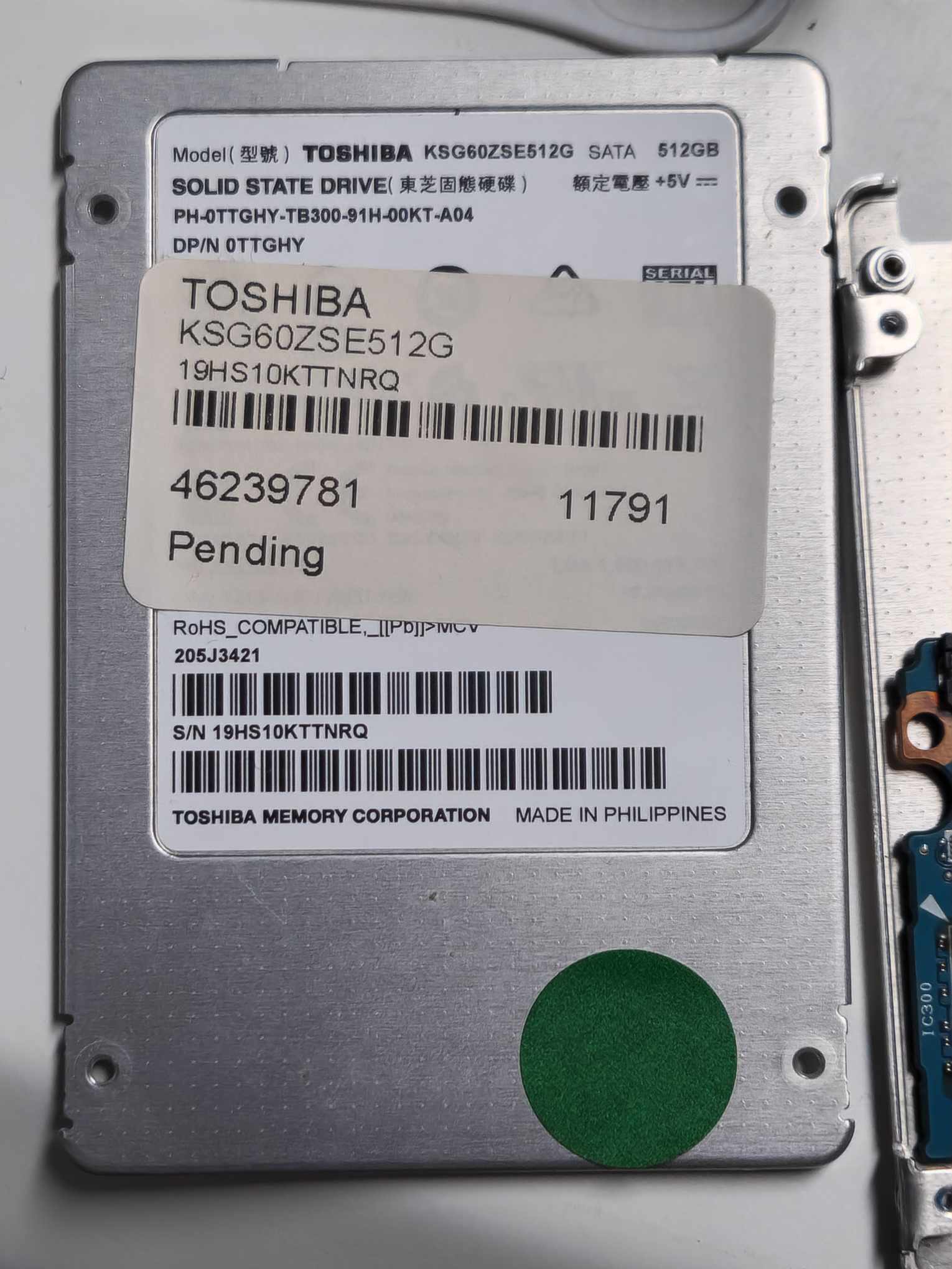

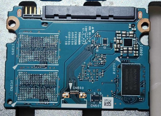

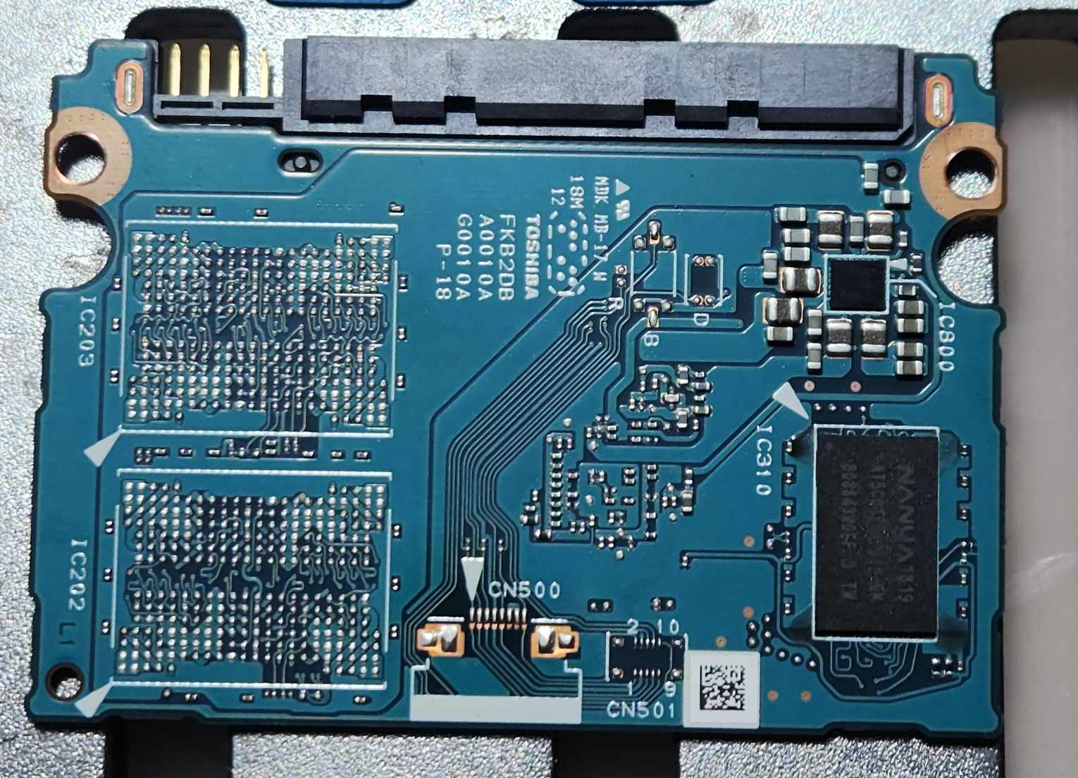

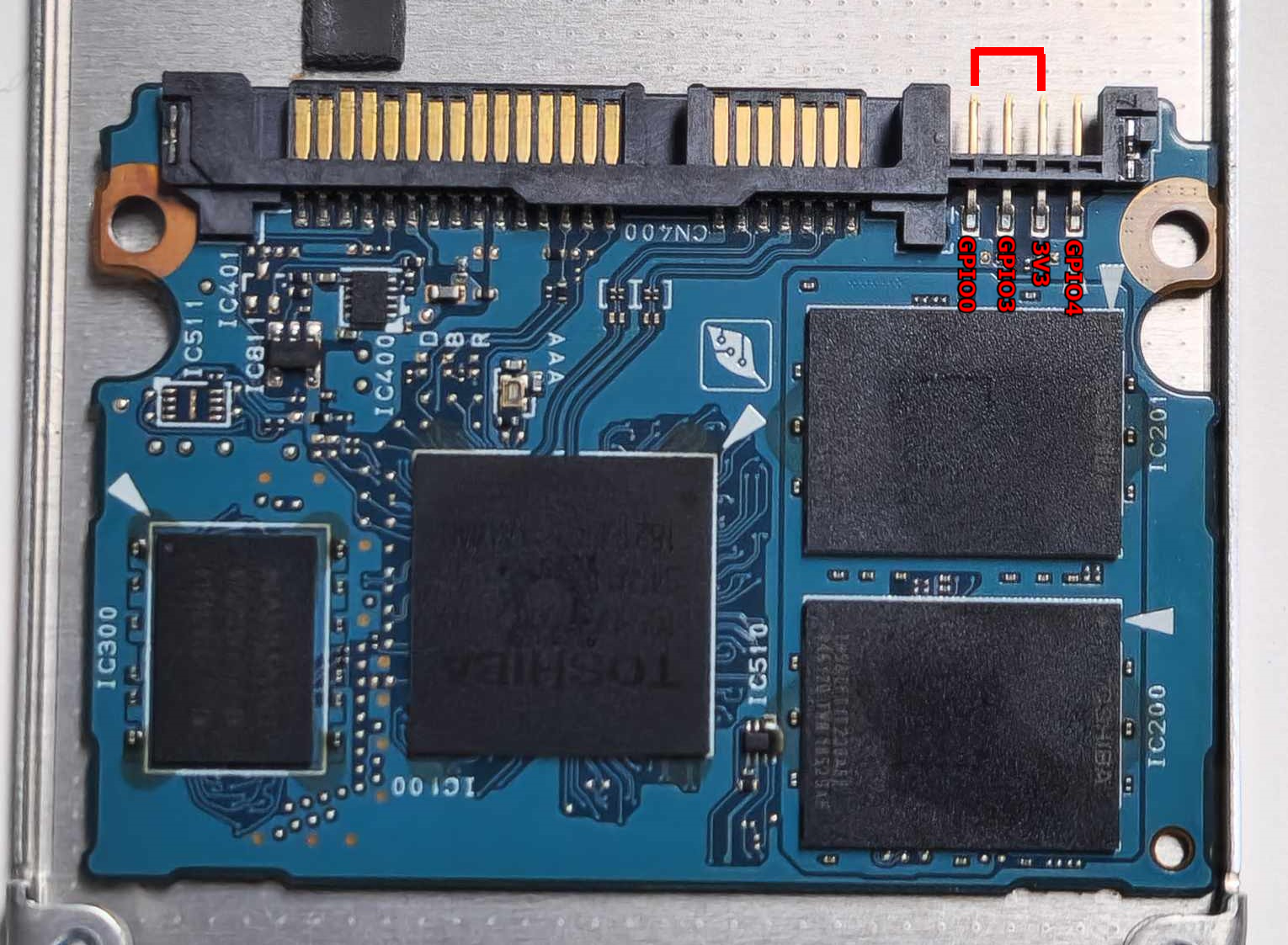

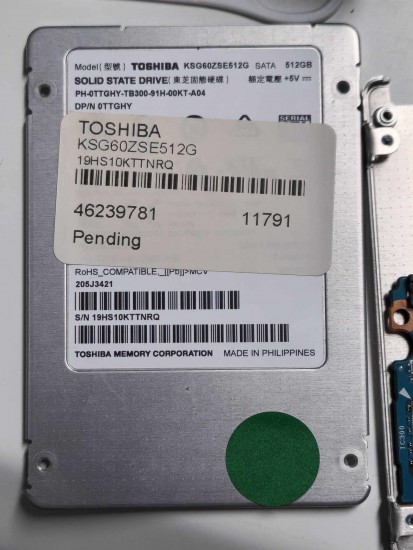

PostPosted: December 16th, 2024, 0:58
Posts: 267
Location: Vietnam
Here are the pictures from my case and pin points to get Safe mode
Again, Thanks Fzabkar
