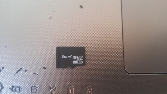

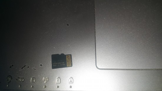

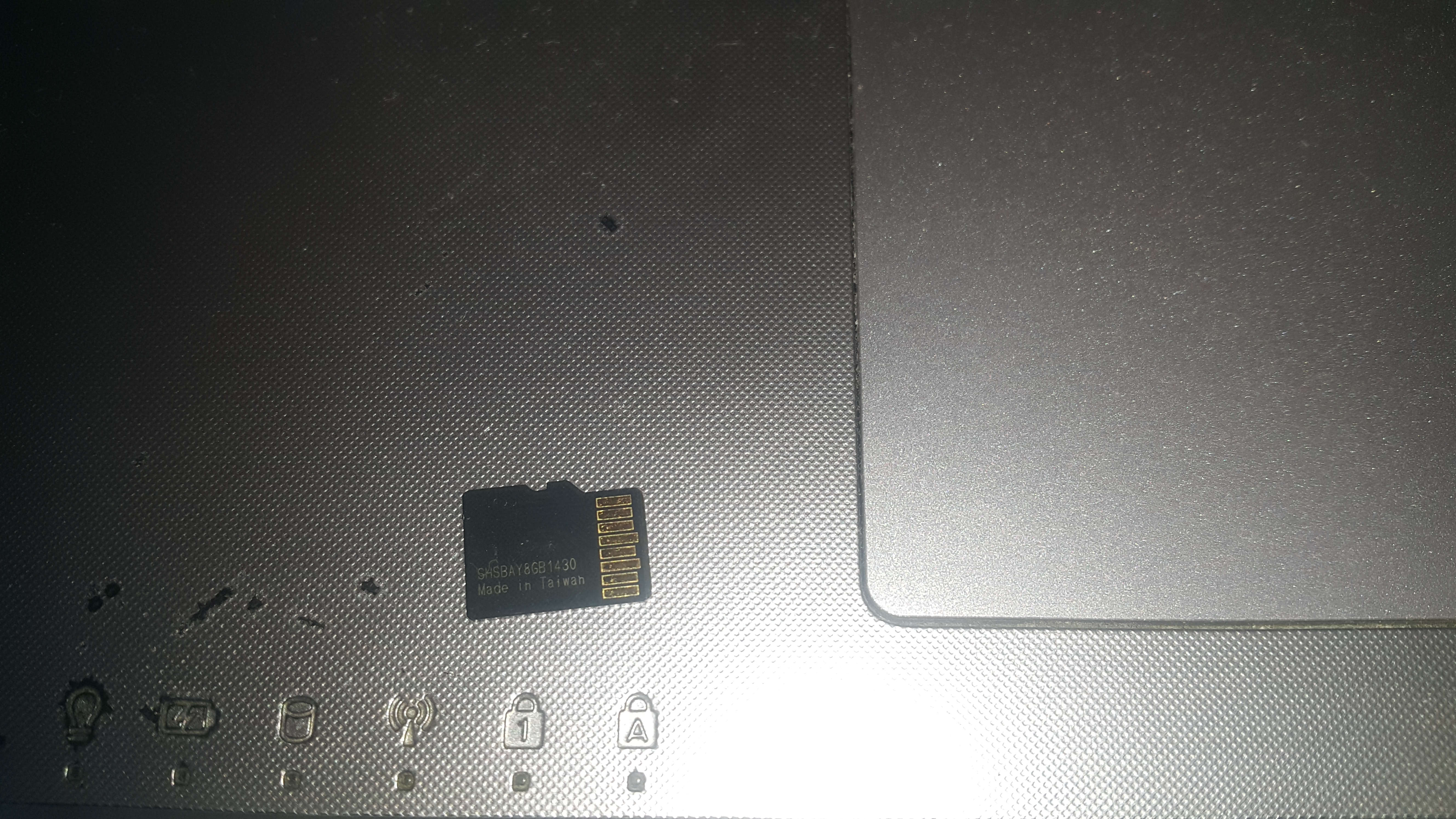

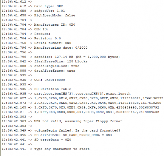

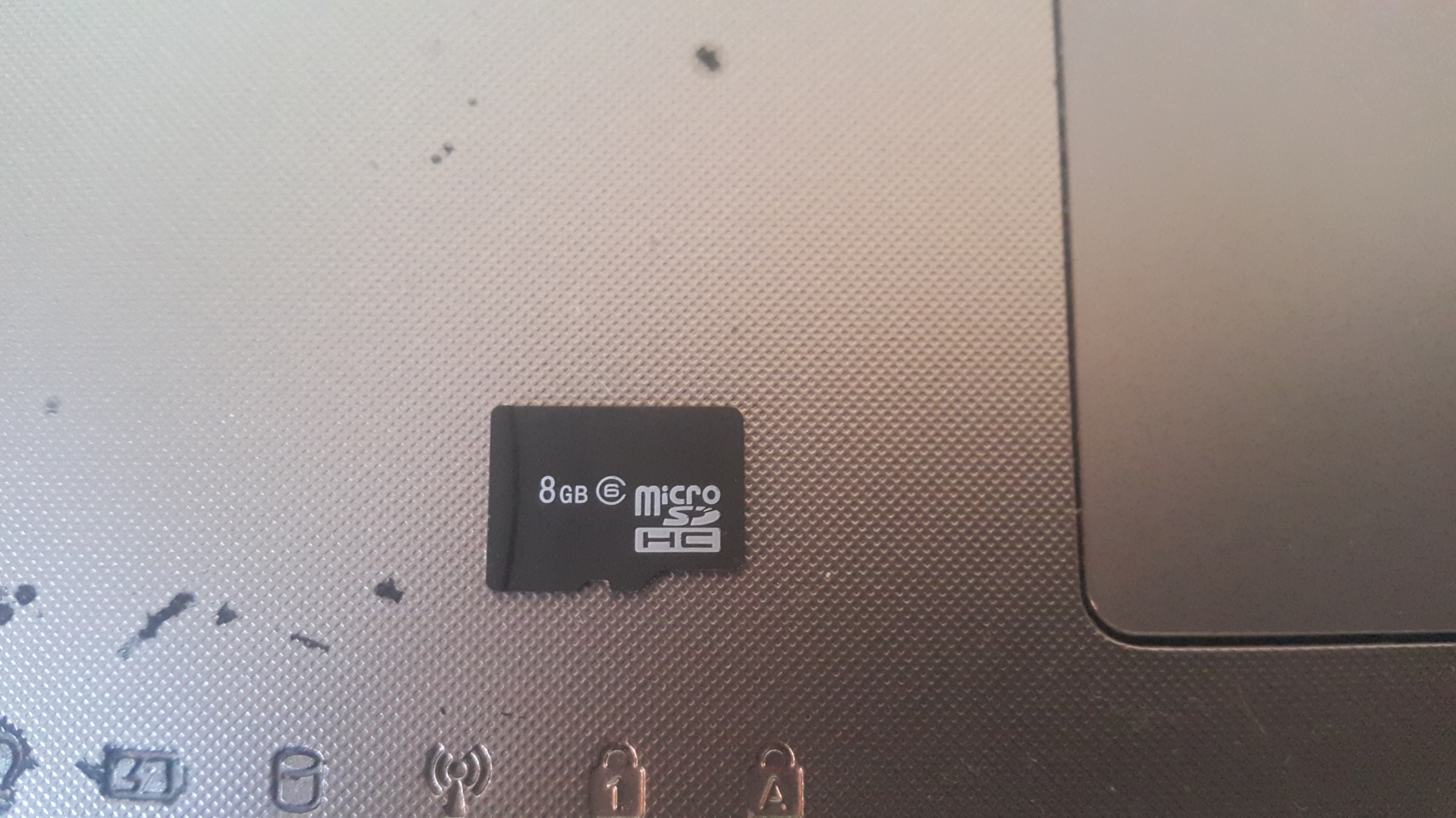

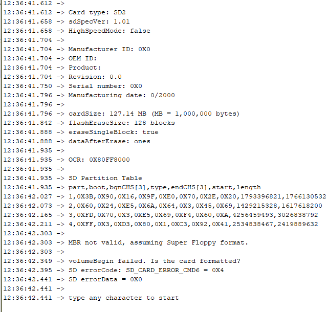

hello, I have an sdcard that had been sitting in a dead Android phone for a while , and I want to see if there is any chance of getting any data back from it. The data is not too important , so I am more interested in learning, but it would be nice if can get it back.
The card is completely unrecognized by Windows 10 or android. I plug it in and nothing happens.
I plugged into an sdcard reader hooked up to an Arduino and got some results using one of the examples provided by the Arduino IDE , called SdInfo , I tried to format the card using another example but I kept getting errors.
I have attached pictures of the front and back of the card and the resluts I got with the Arduino.
thanks

SD_CARD_ERROR_CMD6 = 0X4
I think this has nothing to do with the issue.
If card is correctly detected in disk management I'd first try imaging/cloning it using for example ddrescue, hddsuperclone. If it's not detected in disk management or it is though with incorrect capacity then I think there's not a lot you can do unless you have pc3000 flash, FE or similar.
